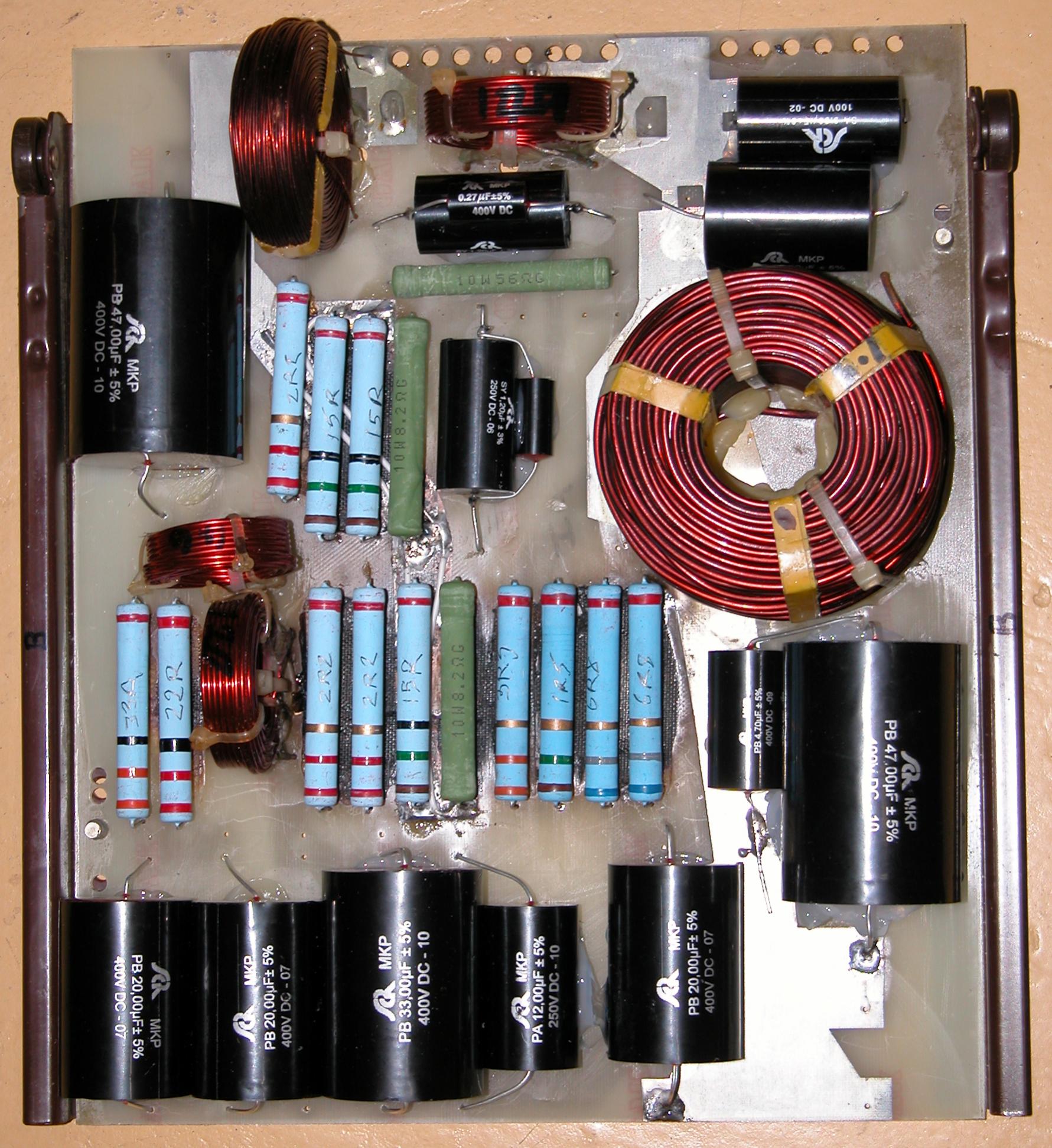

Updated crossover from Duntech.

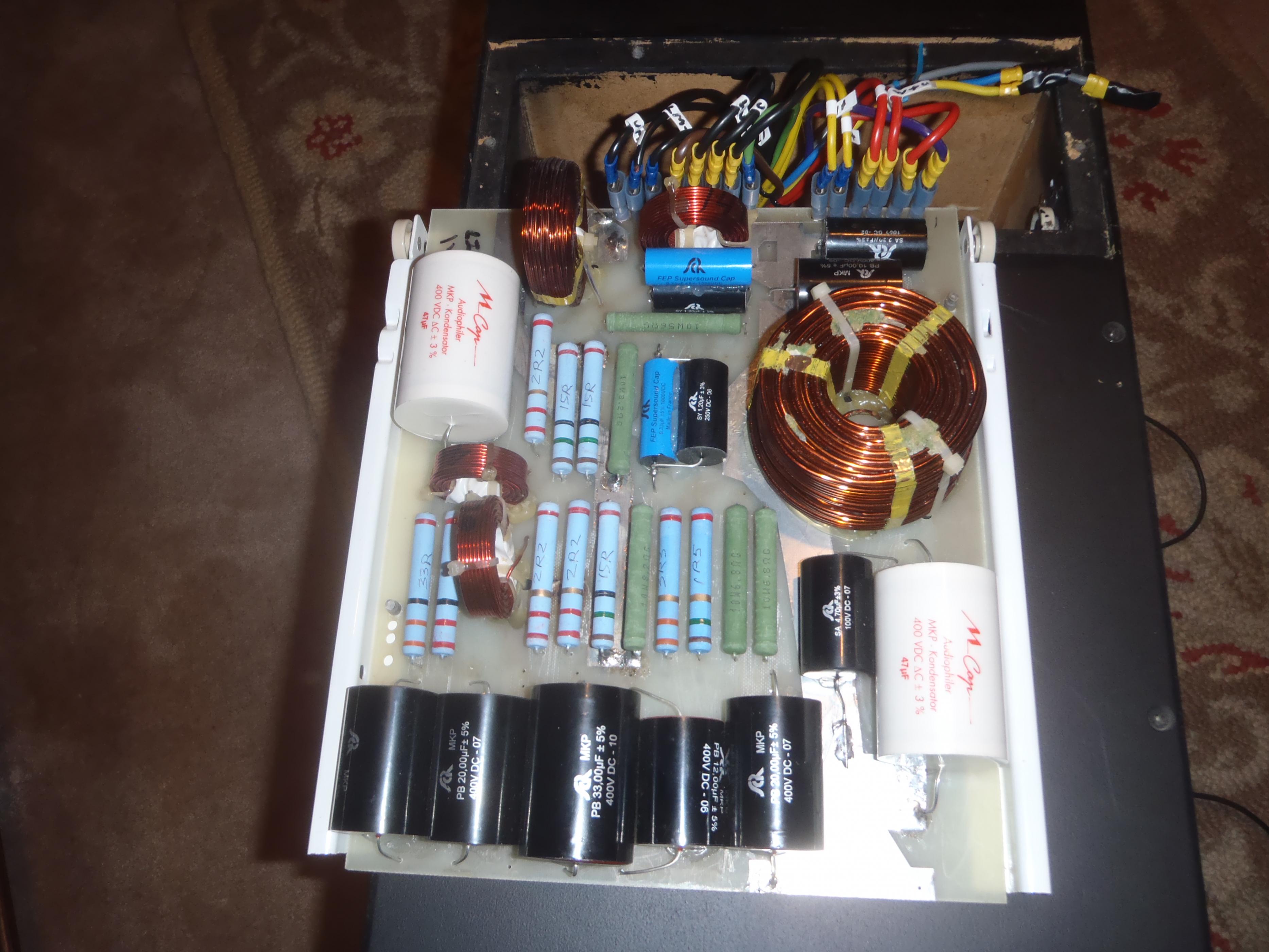

I'm a french audiophile ,i bought Duntech Crown Prince's used in 1992, switched 3 years later to MBL101's for some years,giving my C P's to my son..
But after some years,i was sooo deceived with the MBL's (and my son uninterested by the C P's)that i recovered my old CP's, changed the 4 woofers (the original model was not exactly the 75,the membrane was different, but impossible to get strictly the same then i bought 75 to Dynaudio..),changed all the caps to SCR MKP's (which is the trademark currently used by Duntech australia,fortunately of french origin, the price is very reasonable..).
About the caps ,i measured the values and adjusted them in order to reproduce exactly the indicated value of the old one..I didnt change resistors neither inductors.
