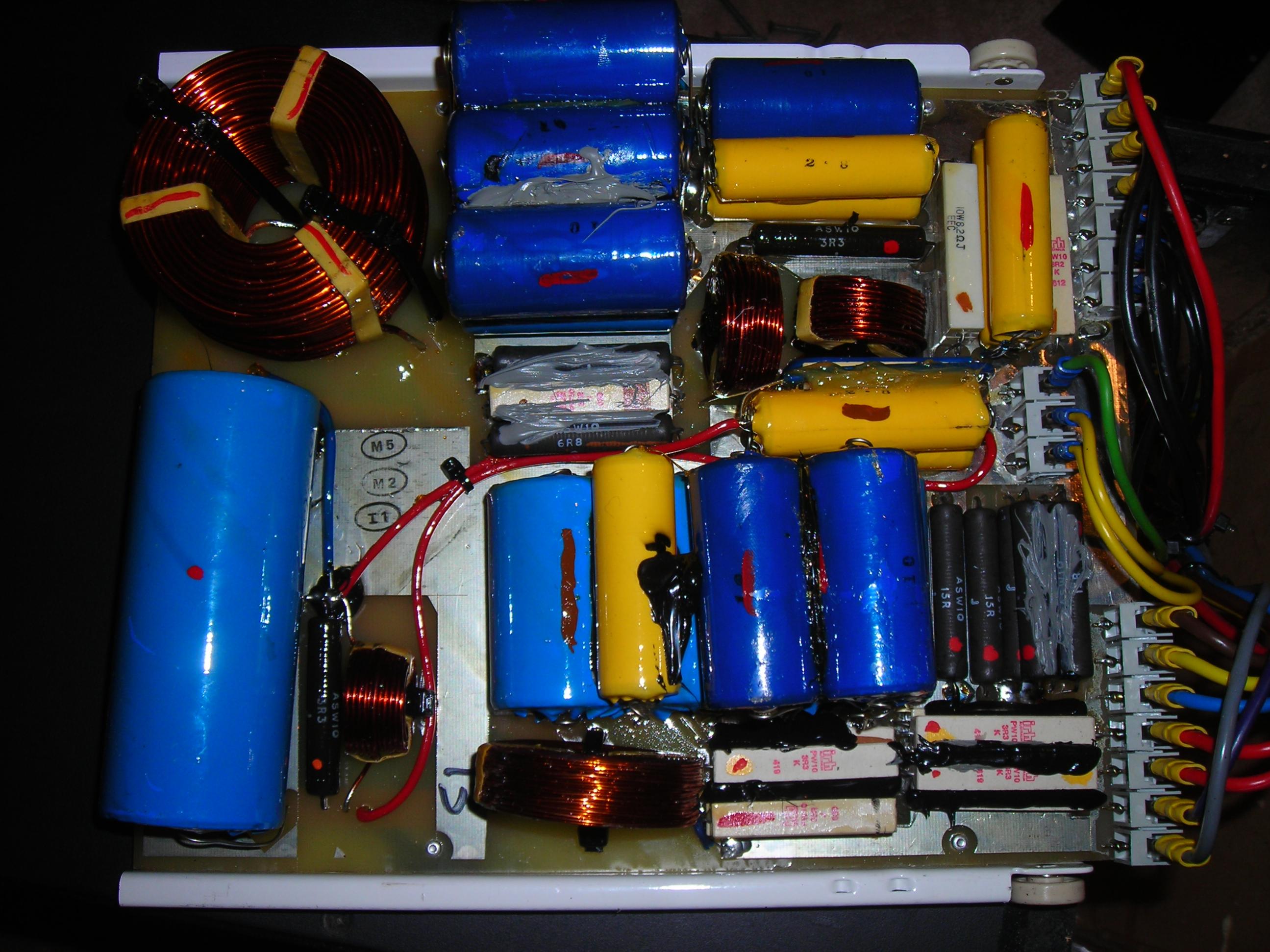

I have the stock crossovers back together and I could connect the analyzer to the crossover and take a look at the real world electrical response with the drivers connected. it might be interesting to see what effect the impedance of the drivers plays on the electrical response of the filter network!
Crown Prince crossover
I'm not trying to change anything. just duplicate the crossover boards with different parts. same exact values, different branded parts.
I suggest the following in your crossover upgrade:
1) I'd leave all coil "as it is", but maybe leave the place on new board if you decide in future to use foil coils.
2) L2 and L5 coils are used in networks for correction of freq.response, so their exact values is important (both - inductance and resistance)
3) C15 and C3 exact value is required as in (2) - but both of them making 1.504uF, so you can replace it with one 1.5uF capacitor
4) C7 and C10 also makes 1.504uF, so you can replace it with one 1.5uF capacitor
5) C6, C8, C9: replace them to 8.2+6.8+1uF
6) C4: 50uF - this should be exact value as stated in (2). For example 47+1.5+1.5
7) C1,C13,C14: 24.5uF -> 22+22+0.47 (or 20+20+2.2+2.2)
8) C2, C11, C12: I'd leave it as it is 20+10+10
9) C5, C16, C17, C18: 70uF -> 33+27+10
10) all resistors -> MOX 10W
What kind of parts to use:
If price no object, I'd use best possible caps for (5), (6) and (7) - I suggest you to try there Auricap XO.
for C3, C4, C15 quality is not so important, you can use something like Mundorf MCap250.
For (4): you can use Auricap XO, or also try inexpensive Electrolytics like Mundorf BG ("plain" - new name ECAP70)- you need to listen what is better. Not always expensive cap is better.
For Bass section I suggest MCap400, but MCap250 also will be fine and You can try here also Electrolytics - as what I've noticed that in some constructions replasing electrolytics to plypropilene in bass can make it more exact, but a bit "dry". Here you need to try and listen.
