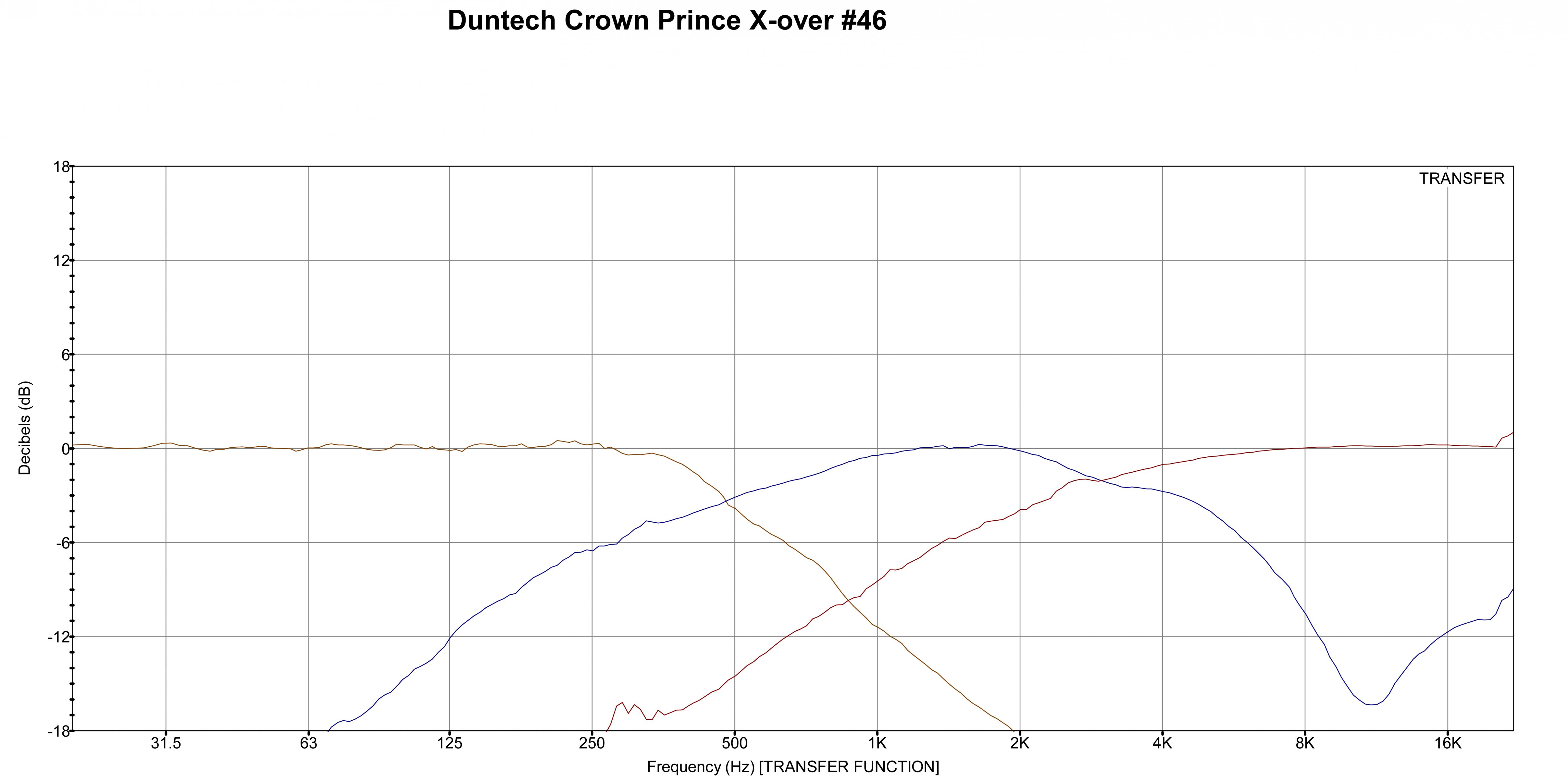

I was curious to know what the crossovers were doing so I set up my SMAART spectrum analyzer system and ran some tests on the crossovers using the transfer function. Here is a composite shot of the response.
This is not 100% accurate as I was using a 4ohm resistive load in place of the actual speaker drivers and I realized after i was done that I also used the 4 ohm load for the tweeter as well when i should have used an 8 ohm load. so that will effect things a bit. BUT this is close enough and repeatable so that after i get the new boards built. I can perform the same test and see if things are the same.
I thought it was interesting none the less!

Looking at it for a bit... noticed that the apparent rolloff on the lower side of the mid, and the highs seems to be 3db/oct??!! The woofer seems to be at 6db/oct.
This puts the tweeter down only 12dB @ 250Hz!!
Was this a simulation, or you ran some software with resistors in place of the drivers? If so, then the 4 ohm vs. 8 ohm would put the xover freq of the tweeter even higher (better in terms of IM and power handling) than it really is?
I am not really seeing the effect of what is apparently a notch filter in the mids, maybe it is working to make that 3dB/oct slope. Good trick to do that... unless the scale on the left side of the graph is off?
_-_-bear
I used 4 ohm resistors in place of the drivers. (i should have used 8 ohms for the tweeter). and connected each output to my SMAART spectrum analyzer system.
The woofer is just a 1.5mh inductor in series with the woofer and Dunlavy was famous for using first order networks so the woofer response is exactly what i expected.
the midrange section of the crossover is much more complicated with 2 tuned notch filters that I calculated to be at 3.56khz and 10.6khz which when you look closely at the top side of the midrange section do correspond to the shallow shelf at about 3.5k and the big dip at around 10khz! even the math of the Z of the tuned filters worked out to be .4ohms at 3.5khz and 1.82 ohms at 10khz so figure those in and that should tell us the amount of dip at each section and well...it seems to agree!
The low side of the midrange there are two factors, 1 is the natural acoustic rolloff of the small 4" midrange drivers. I have not investigated to see what they are. the second is the odd RC across the C combo at the front of the midrange schematic. Not sure what that RC does? is that just impedance correction or is that to tailor the slope?
I would imagine that if i had used an 8 ohm resistor on the tweeter section, the response curve would have been moved to the right just slightly and that shallow shelf for the midrange would have lined up a bit better with the tweeters rolloff. But, this was interesting to look at none the less! and it verified my math for the notch filters!

Right, there is some acoustic roll off somewhere from the drivers themselves - especially the mids and tweeter...
Years back in another place I did give John Dunlavy some flak about the tweeters having to deal with so much energy below their design F3 point. I think it is a real issue as levels go up...
Still, we are seeing ~3dB/oct electrical, yes?
Btw, these curves are almost the classic JAES article from B&O where they showed how their speakers could pass a square wave at 1kHz too... predating Dunlavy's work. Almost, not quite the same. Similar.
_-_-bear
correct that's what I wanted to look at was the electrical characteristics of the crossover. I am building new crossover boards with the same value, just newer better parts and I wanted to be able to compare the new boards and the old boards electrically just to make sure things are the same. I will do a full acoustical test once they are completely finished.
