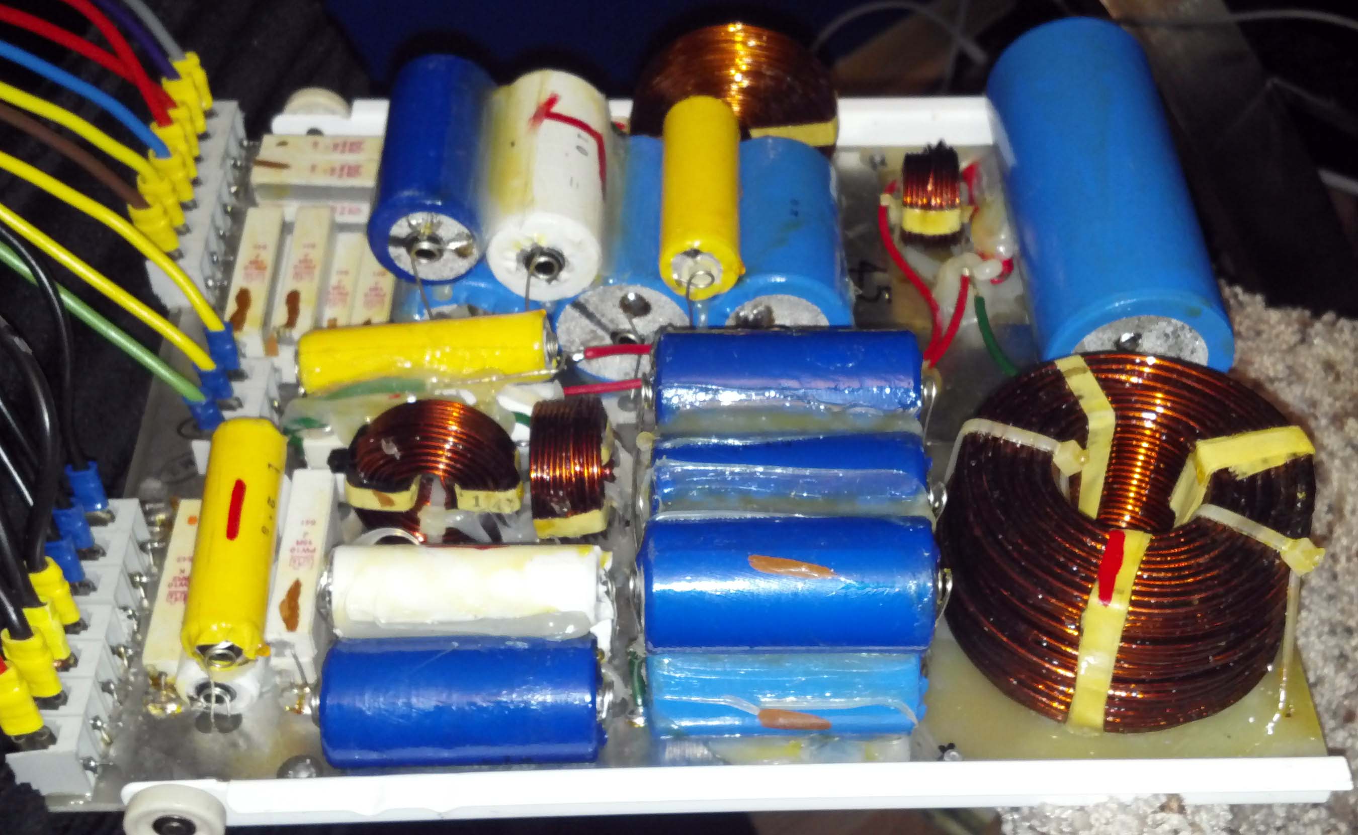

I am working on rebuilding the crossovers in my Duntech Crown Prince speakers. After speaking with Duntech AU they suggested replacing all the capacitors and resistors as Technology in the last 20 years has greatly improved these parts. So I have torn one crossover apart and mapped out the schematic and verified all the parts values with the exception of the Inductors which i will have measured next week.
There are many interesting things and some puzzling things as well about this crossover design. I will start with the top working down on the schematic.

The first thing I noticed is the upside down Zobel network forming more of a Boucherot cell in the tweeter network. As expected a 6db per octave first order network as i have always read Dunlavy used.
The midrange gets quite interesting. I have read that each speaker was "voiced" to fit within a chosen frequency response window. I was a little concerned that the left and right speakers would be different. But both crossovers check out to have all the same values...BUT the resistors while the same value, differ in construction! there are 3 distinct types (and colors) of resistors used and they are not the same parts in the same places. again they are the same values however!
Interesting in the midrange section is the zobel across the high pass caps. I checked this many times to make sure that this is in fact exactly how it is wired and it is!
The group of caps totaling 45uf at the input to the midrange section and Inductor L4 is expected to form a 6db first order network. But L2 in the middle of the voltage divider was not. I'm curious about that. L4 is followed by two Tank circuits where they must be tuning out some peaks in the response at a guess??
Where things get interesting is C4. this is a 50uf single very large cap. Everywhere else in the circuit he used multiple paralleled caps to form a larger value. why in this location only did he choose to use one single large cap?
Moving down to the woofer network see L10 (typo, was supposed to be L1) which is a very large inductor. followed by a Zobel network with multiple paralleled caps made of 10, 10, 10, 20, 20uf caps which seems odd to me that they didn't use 20, 20, 20, 10 instead? and again why did he use one large 50uf cap in the midrange tank circuit and not kept form by using 20, 20, 10uf as elsewhere? maybe i am making more of this then there really is but it is interesting.
The following resistor switch network is a low frequency room compensation network that was done away with in later versions. as suggested I will be removing this network as well.

Oh yeah BTW, the recessed Midrange MIGHT have been from a resistor that wasn't soldered!!! One one crossover board in the midrange section at the input, there are two paralleled resistors. one wasn't soldered to the other on either end. it was just wrapped around loosely! and the glaze they dipped the board in was holding it in place!! ooops! a factory mistake!!!

My new Agilent LCR meter arrived last night and i was able to measure the inductors and do some math. the main woofer Inductor is 1.5mh which should put the crossover point around 425hz.
L2 in the midrange I measured .120mH which interestingly enough corresponds to the 120 printed on it! at a guess this should put the crossover point to the tweeter around 5700hz??
The first tank circuit I measured .15mH which corresponds to the 147 printed on it. which according to an online LC tank calc. make this a 10.6khz filter with a Q= .18 and a Z= 1.82ohms. SO maybe a notch filter?
The Inductor to ground I measure 5.95mH so I'm guessing this is a 6mh inductor.
The last tank circuit I measure 0.045mH which corresponds to the 46 printed on the side which makes this a 3.355khz filter with a Q= .43 and a Z= .4ohms
Interesting stuff!! the 16.05uF for the tweeter seems very very low crossover point?
and when replacing these inductors. I wonder how accurate i need to be? IF for example the 147 printed on the side of L3 really means .147mH is .15mH close enough? Can a .003mH difference really be much in the terms of frequency??
I'm hoping that my measurements of these inductors are accurate enough.
