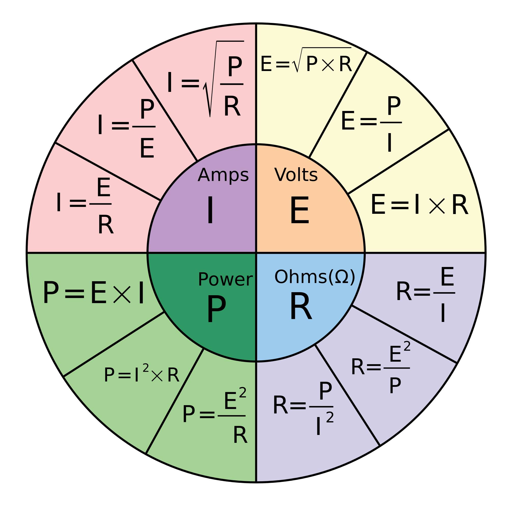

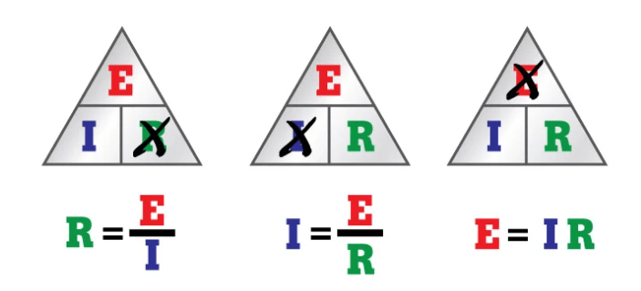

For someone that wants to do any sort of electronics as a hobby and begin to gain an understanding of how this stuff works, you will want to memorize the three simple ohm's law equations and know them like the back of your hand. In addition to the picture the simple power formula is another must memorize... P=IE (power = current times voltage) For example when you want to determine the power dissipation in a resistor.. With the example in post #1... I want to know what the dissipation is on the .47 ohm resistor in the output stage ZM told me to measure. I haved adjusted the circuit to have .7 volts across the .47 ohm resistor. We memorized ohm's law already and know that I=E/R, so current through it is about 1.5 amps. We memorized the power formula (P=IE) so we now know the dissipation on that resistor is: 1.5 amps times .7 volts= about 1 watt.. (A 2 watt rated resistor would be OK there)
