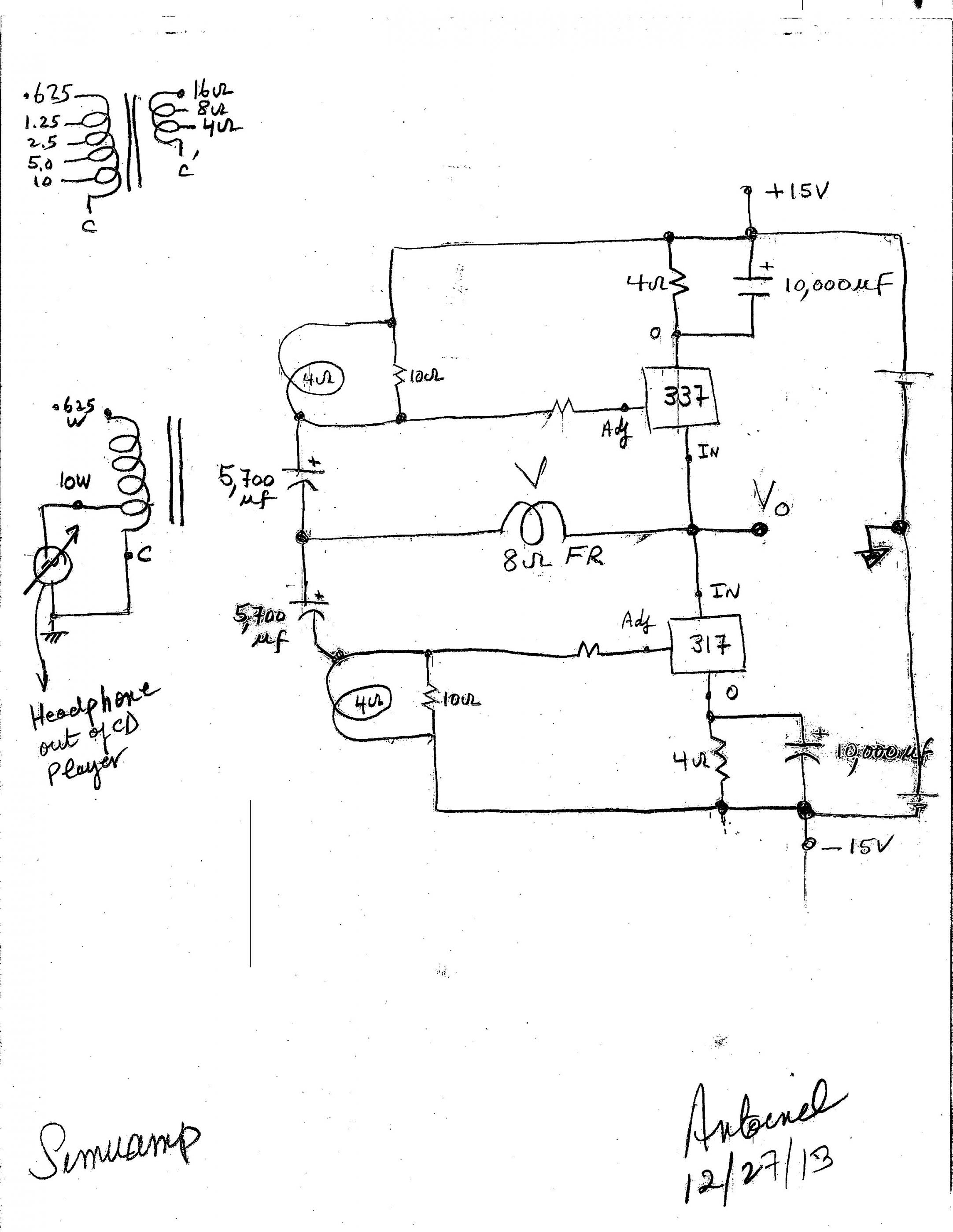

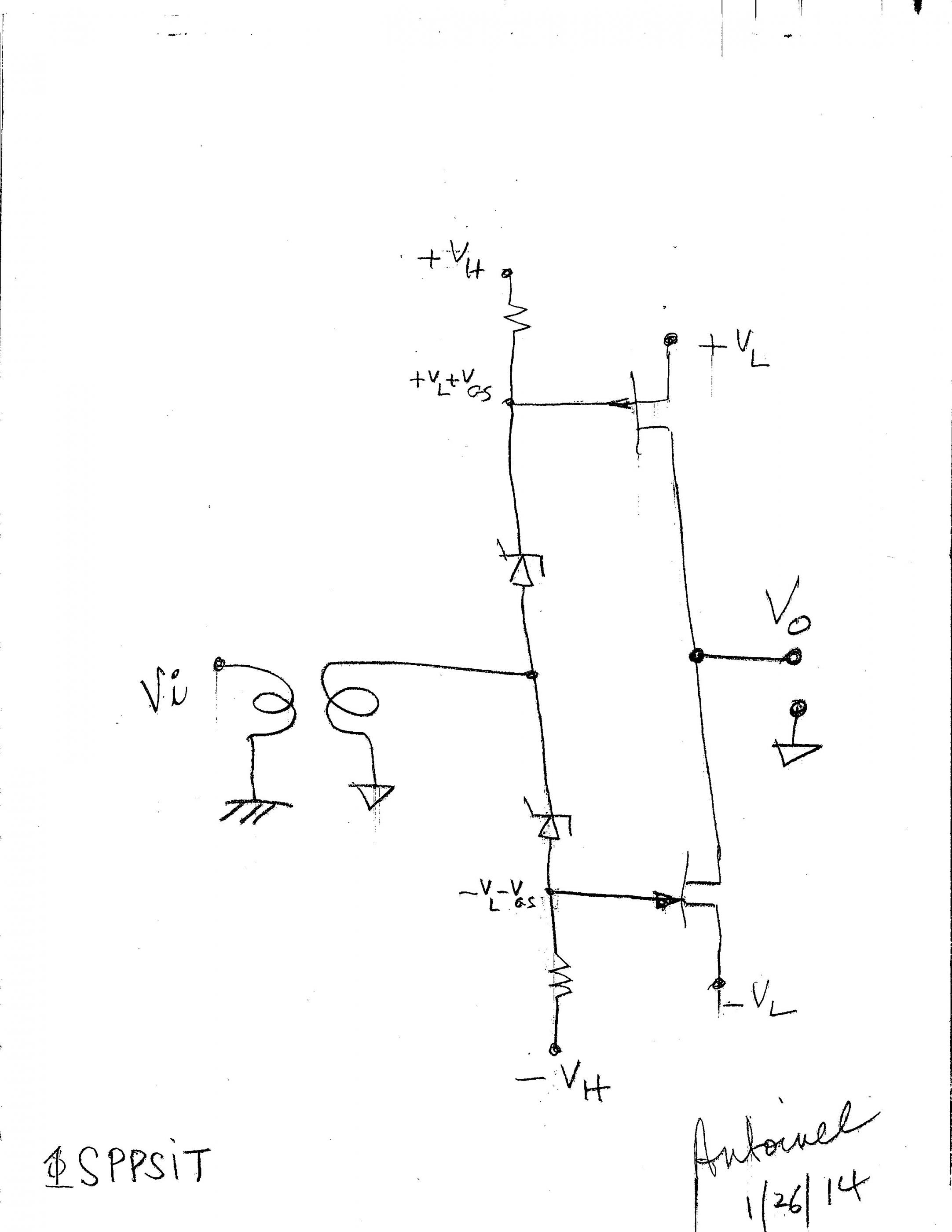

Zen Mod. I need your permission to show two pertinent schematics from practical simulations using LM317/337 so as not to highjack this thread which is not my intention.
nope
you don't need my permission to post anything
Thanks ZM. The purpose of the attached schematic and this post is to show the scope of its practical circuits which may relate to the PP SIT amp. I do not imply that it is a clone, a replacement etc..for the SIT amp. If anything, it is a close relative to lhquam's Teaser6C which he discussed in the F6 amp thread. The regulators are high transconductance, and voltage variable current sources unlike SIT which is a voltage variable power resistor. Note the following:
- Self bias was used to set the idle current at 300 mA by the 4 Ohm power resistors [1.25V divided by 4]. The regulators did not mind the large bypass cap [10,000 uF] across the self-biasing 4 Ohm resistors because they embody all sorts of protection. SIT or MOSFET may be damaged by the initial high pulse charging current of the cap.
- The upper left hand corner shows the wiring of the 70 Volt Line -10 Watt audio transformer commonly used in PA distribution systems. The 10 W port of the primary was connected to the headphone variable output port of of a CD player [25 mW Pout/ch]. One transformer was used for each regulator; noting that Mr. Pass in the F6 amp thread wrote that 2 identical transformers can be used instead of the current Jensen.
- The 4 Ohm secondary winding was used, and must be loaded as shown with 10 Ohm resistor.
- If desired, local or Pass [like Schade] feedback is introduced by connecting Vo through the loudspeaker to the junction of the 5,700 uF caps. Voltage gain is possibly 8 Ohms of the loudspeaker divided by 2 Ohms which is the parallel equivalent of the 2 secondary impedances of the two transformers.
- One may also connect the loudspeaker from Vo to ground, and use instead a non-inductive resistor as Rf.
- In the case of the SIT amp, the secondary windings are 600 Ohms each. The feedback capacitors will be smaller than shown, and larger valued Rf may be used if needed.
- And it sounds fully satisfactory

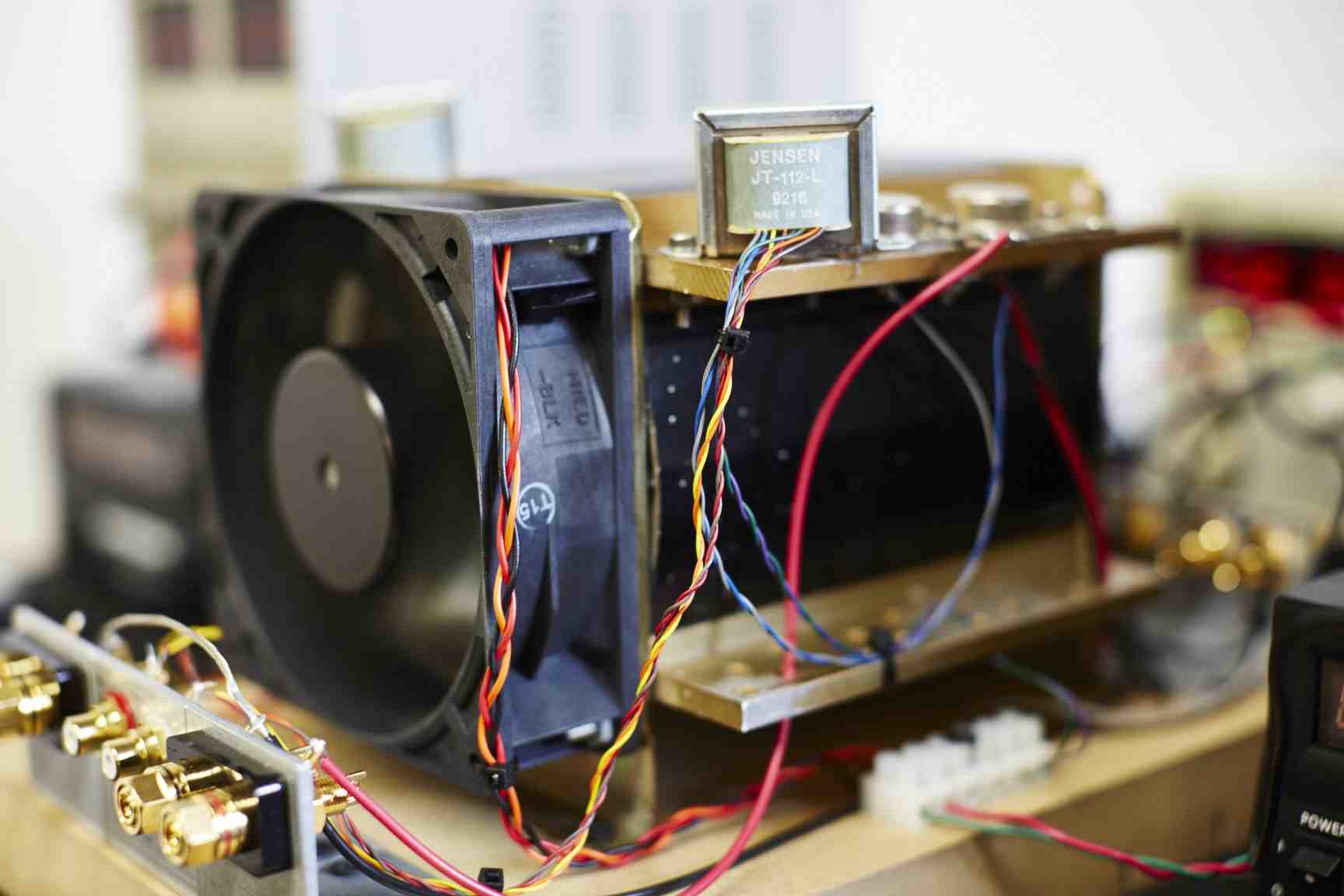

I prepare run in Sony Common Source XFRMR diy amplifier project.
My questions :
It is 2SJ28/2SK82 goes very hot after hours of work ?
Can cooling fan be remplaced by voluminous heat sink alone ? ?
Make more distance between transistors can help ease heat absorbtion ?
What solutions...thanks for Your answers.
Greetings
My questions :
Greetings
On this big photo i see transistors and transformer be close together
it is for keep connections of signal path short ?
Not particularly. In playing with these circuits you will find that they
are quite forgiving with regards to lead lengths and such.
What about avoid cool fan and use only heat sinks ?
