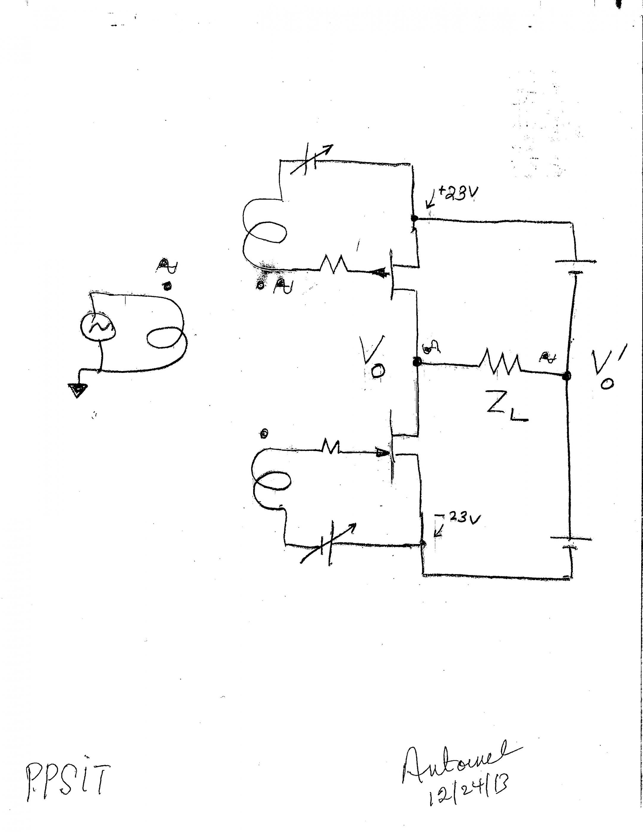

The attached pic shows the concept schematic of the PPSIT amp demonstrated at BAF 2013. The output impedance Zo of output port [Vo] is 4 Ohms when [Vo'] is used as reference ground. What is Zo at [Vo'] when Vo is grounded? Intuitively, no larger than 4 Ohms, and maybe lower than 4 Ohms. I am guessing.
By comparison with this schematic, that of TEASER 6Complementary [F6 amp thread] by lhquam is similar except that he used enhancement MOSFETs. lhquam reported Zo at Vo equal to ~30s Ohms. But what is Zo at Vo'?

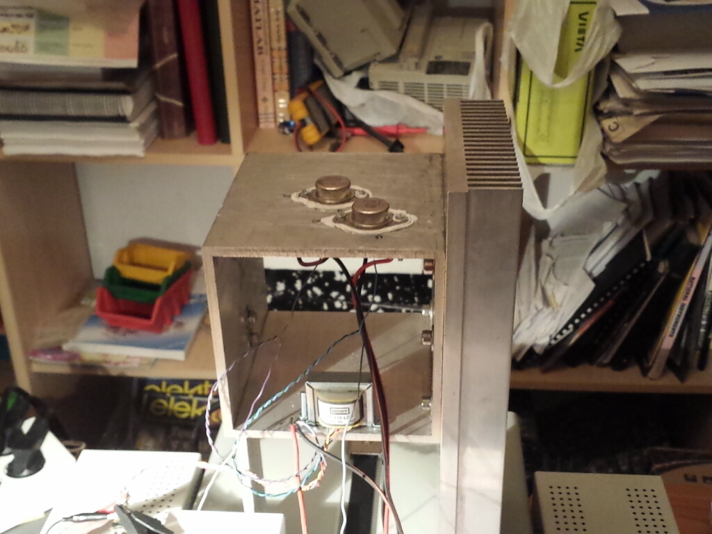

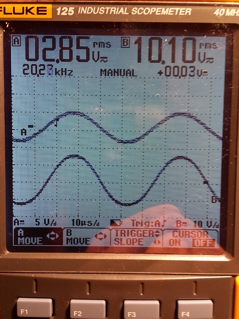

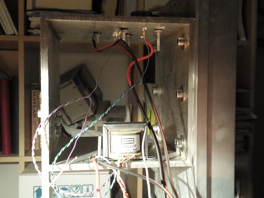

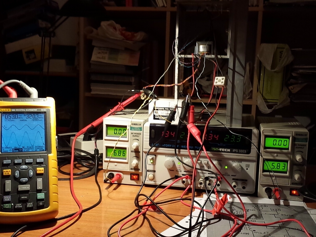

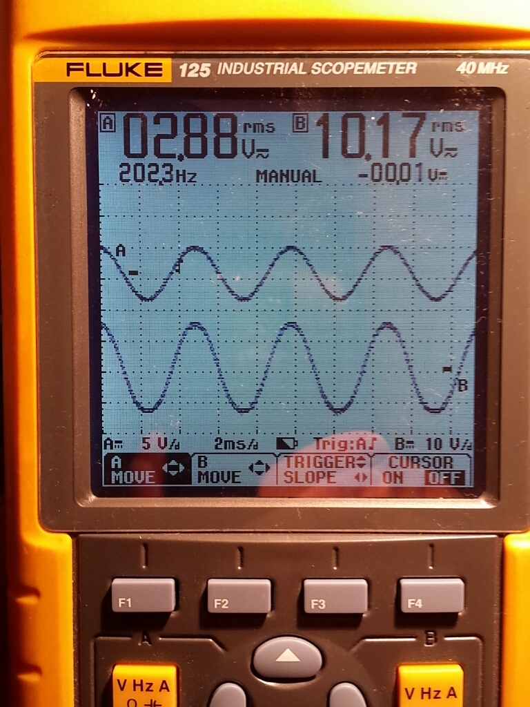

Hello. This is my humble contribution. I have built the amplifier of post 4.
It is very ugly and only one channel. Power supplies are regulated.

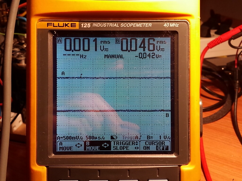

I have not any noise at output. Power output is, more or less, 12 watts at 8 ohm. I have not distortion meter, but signals look good...

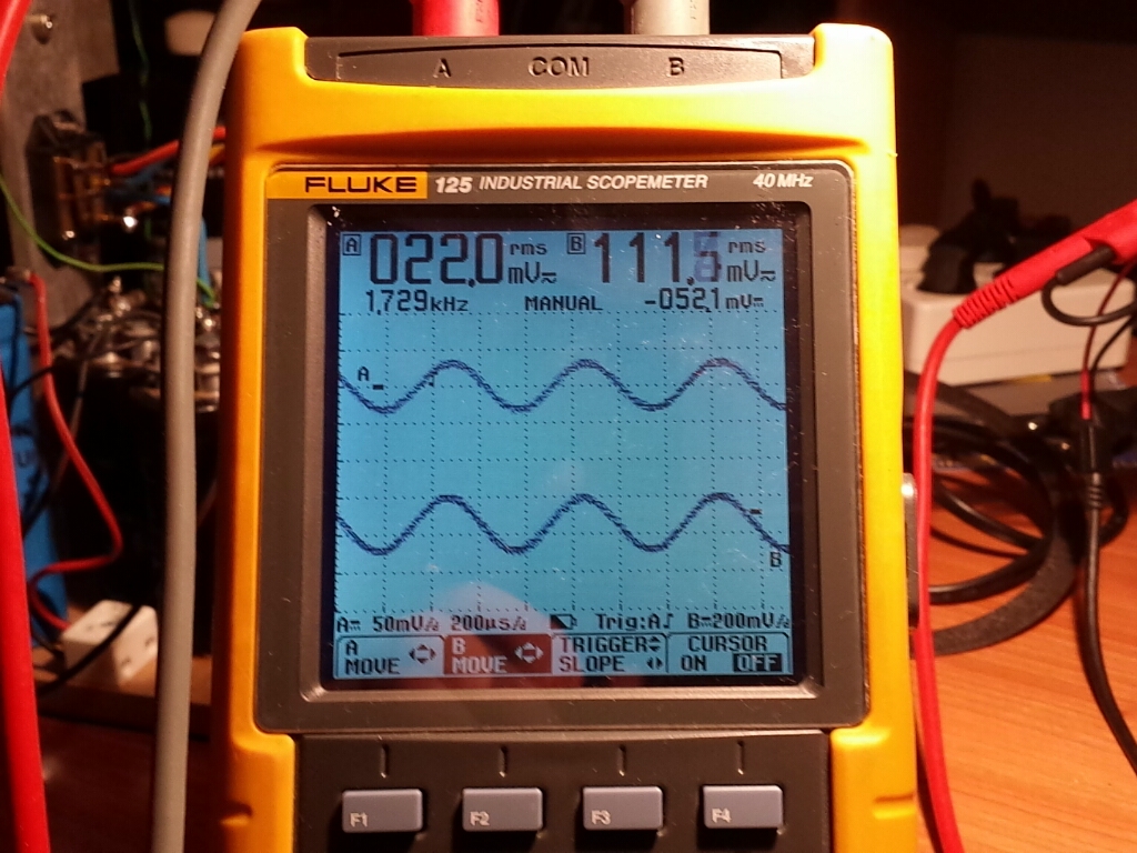

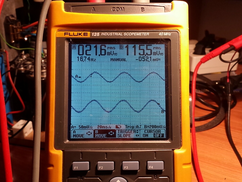

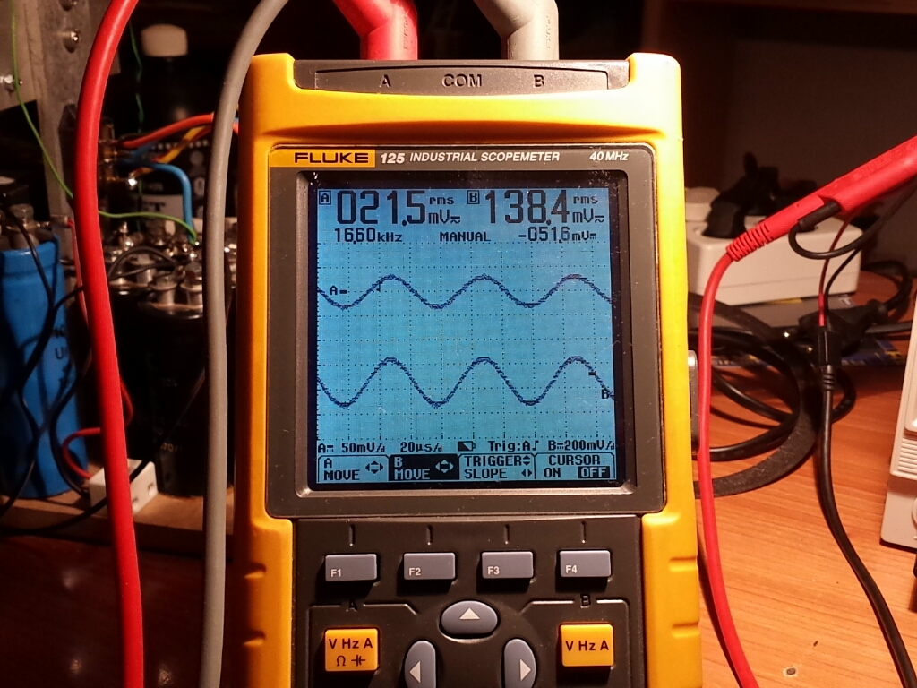

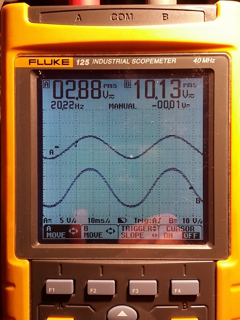

And now the oscilloscope.. Sorry, Trace A is generator and trace B is output to 8 ohm speaker. Other day I will try with music...
