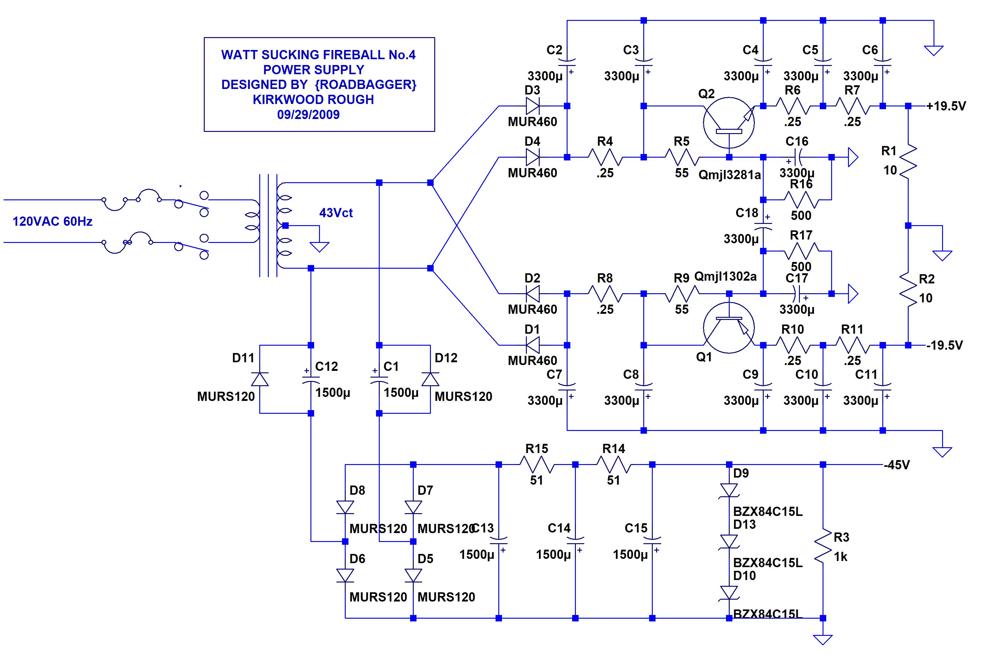

Ultrasimple SIT PP amp from BAF , or SIT Beast with a Thousand PSUs
Here are a few SIT power supplies in addition to those already posted in this thread.
I have ordered a custom smps to play with. The amp sounded great with them at BA, so I am interested to try it out at home.

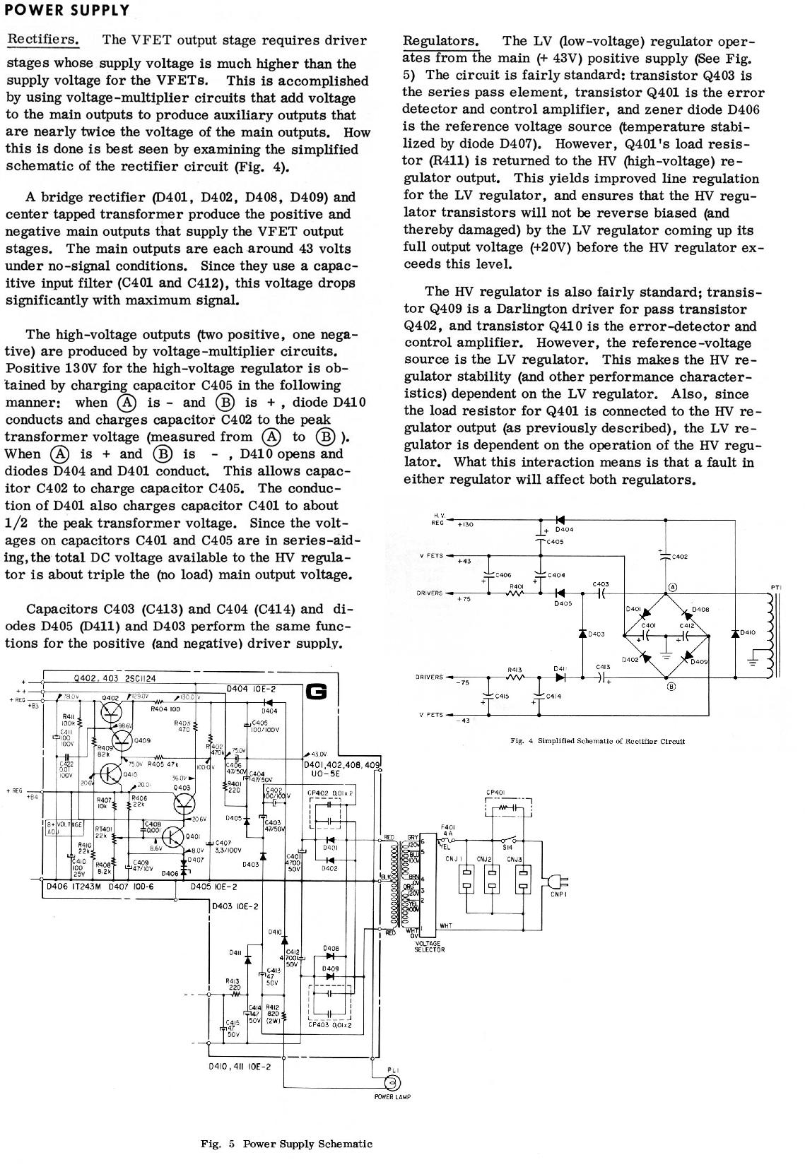

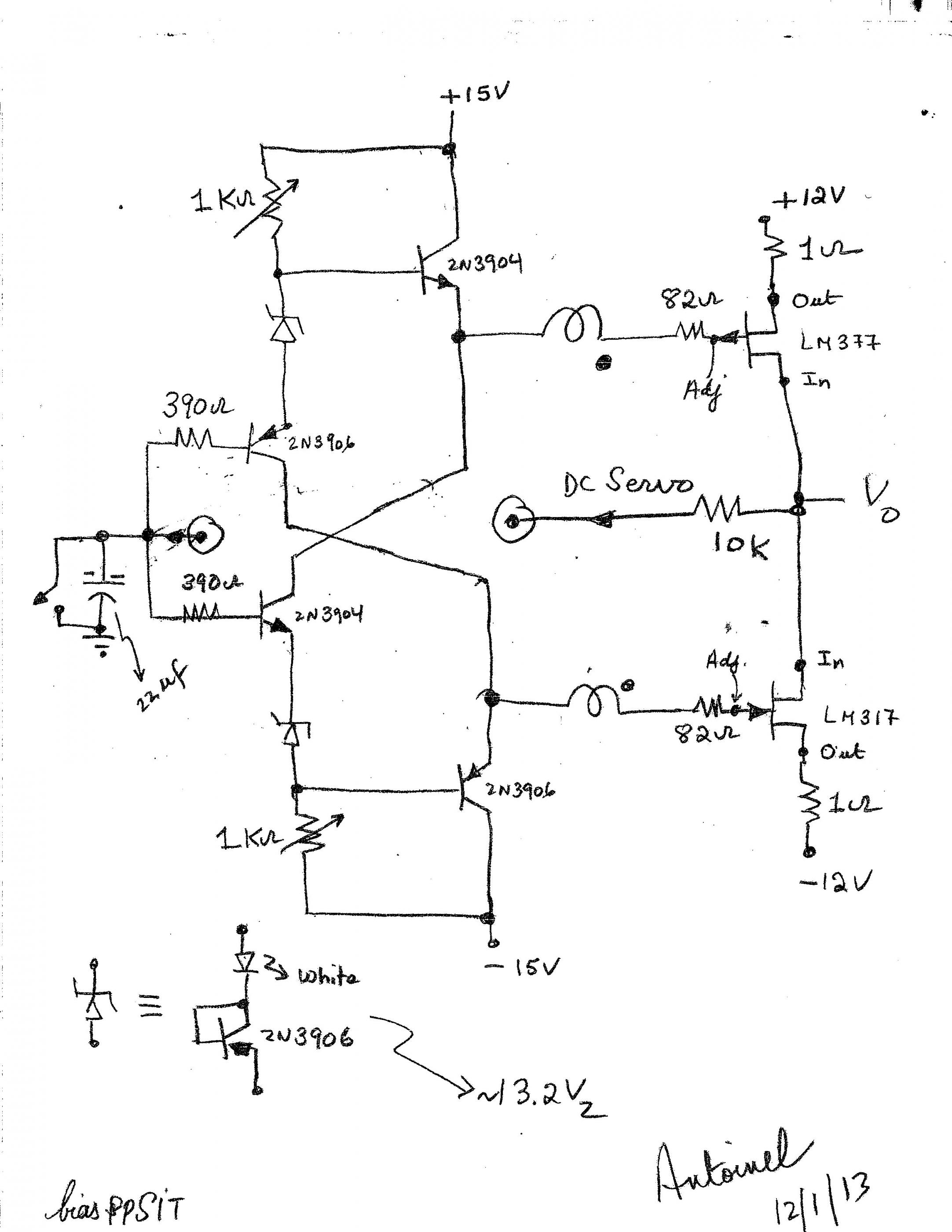

Potential bias circuit for PP SIT amp
Zen Mod. The attached schematic shows a potential method to bias the PP SIT. Its prototype works satisfactorily. Its purpose was to demonstrate and maybe extend the feasibility to PP SIT. The components of this demonstrator circuit are:
  • A dual +/-15 V regulated power supply for the bias circuit.
  • A dual +/-12 V regulated power supply fpr the output stage.
  • LM337 [negative voltage regulator] was used to simulate a P-channel depletion device. LM317 [positive voltage regulator] was used as an N channel depletion device. Both devices loosely simulate complementary power SITs. Their Adjust port is like a gate. Their Input port is like the drain, and their Output port is like the source.
  • The front end is a complementary BJT voltage level shifter.
  • The interstage BJTs are complementary buffers which apply the bias voltage to the Adjust terminal of the chips via the secondary transformer windings which also carry the audio signal.
  • The variable pots [1K Ohm] are used to adjust bias current which is monitored [closely] across the 1 Ohm source power resistor.
  • The prototype has a dc servo function. A resistor [e.g. 10 K Ohm] is connected from the Vo output port to the joint bases of the front end BJTs which are AC grounded with an electrolytic cap . The DC voltage accumulated on this cap is processed to automatically center the dc voltage at Vo to ~ zero volts.
Here is the procedure to bias the output stage.
  • Close the shorting switch [to ground] across the electrolytic cap to disable the servo function.
  • Turn on the +/-15 V supply only to energize the bias circuit.
  • Adjust the bias voltage at the emitter ports of the interstage buffers to +/-14 V referenced to ground. The +/-2 V difference between the bias at the Adjust port and the respective +/- 12 V power rails inhibits the conduction of the chips.
  • Short Vo to ground.
  • Work with one chip at a time. For example, decrease the initial bias voltage [+14 V] slowly while monitoring the resultant voltage drop across the source resistor of LM337. I settled at 200 mA because of limited heat sink capability.
  • Ditto to the lower chip to get ~200 mA.
  • Lift the power outport from ground. DC offset maybe present and small.
  • Engage dc servo by opening the grounding switch across the front end electrolytic cap.
  • Check the voltage at the electrolytic cap to coincide with its polarity. Reverse the leads of the cap if needed.
Of course it played good music within its power limitations as it energized a full range 8 Ohm loudspeaker.

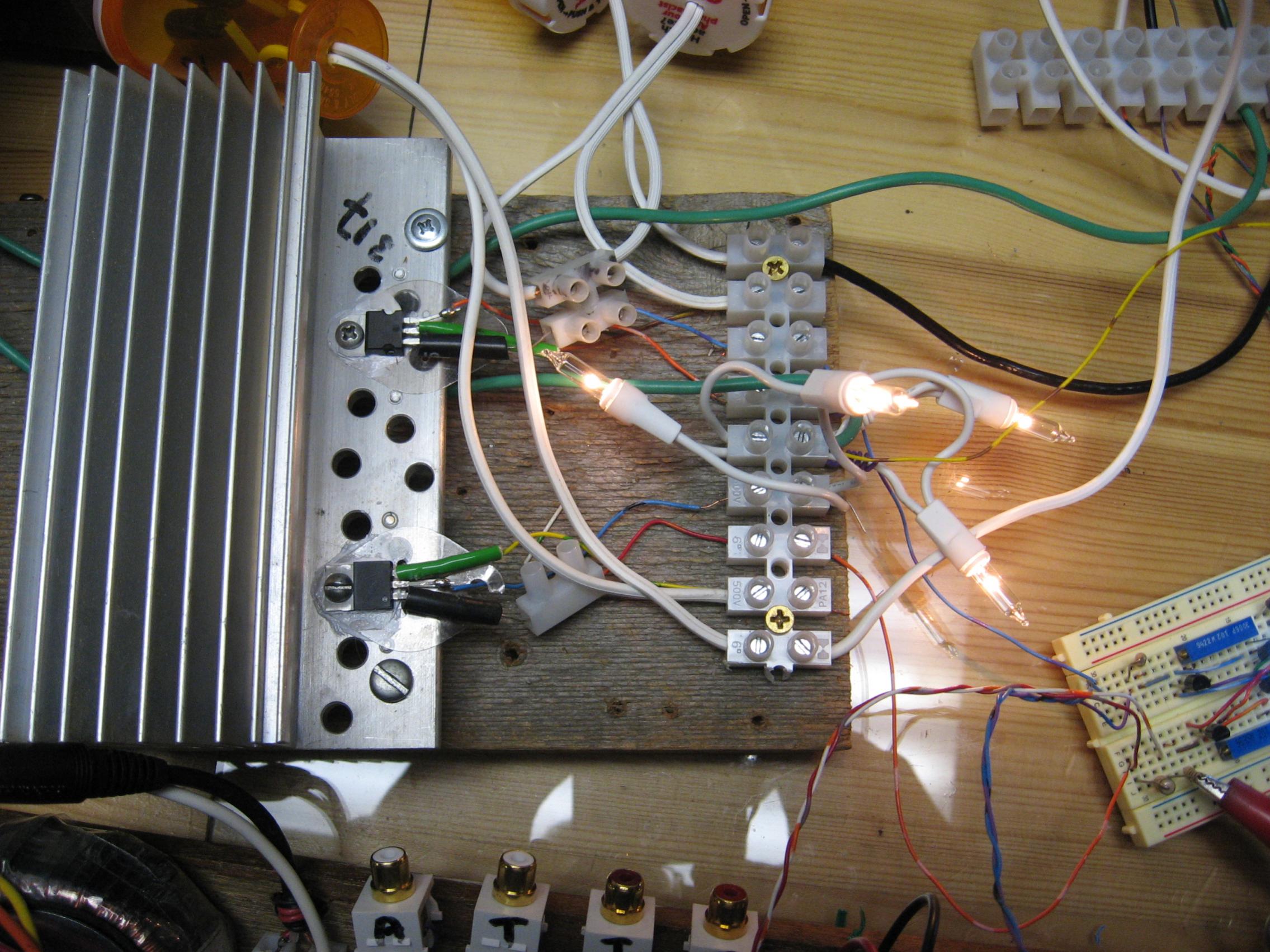

Zen Mod. Pictures of the transient prototype are attached for the schematic I showed in the previous post. Not pretty; but is fortunately a knowledge plant. The protoboard has the bias regulator, and the chips are on the heat sink. The left toroid [120V to dual 12 V] delivers the audio signal and is driven by the headphone amp of a CD player.
