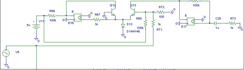

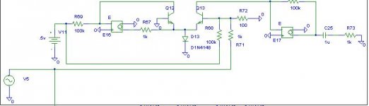

I have enclosed the exponential circuit that "worked" best in the simulations. There is room however for better dimensioning.
The working principle is that the exponential relationship of base current and base voltage of Q13 is used to caues an output voltage from E17. The voltage sources are set to a gain of 80 dB and are therefore quite good approximations of OP-AMPs. R68 is there to bias the circuit such that the base voltage doesn't get negative during the lowest point of the negative going halve-waves of the input signal.
Q12 and E16 are there to set the bias for Q13 and for thermal compensation. This part of the circuit might have a tendency for oscilations in real-life. This could be solved with a cap from the output of E16 to its inverting input (i.e. the classic dominant-pole compensation).
Any small-power NPN should work. Just take care that they are of the same type and that they are thermally coupled (and no don't directly solder metal-can types together as most of them have their collector connected to the can).
I think it sholdn't be a bog problem to design the filter and summing stages. At least not the circuit itself. Finding the best filter cutoff frequencies might be a matter of trial and error and of course personal taste.

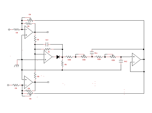

This is the one I will be committing to breadboard..
The filter and the mixed in level are adjustable in this to allow adjustment for the best subjective effect.

. Edit:- The shunt capacitor should have a value of 4n7, not the on on the diagram.
