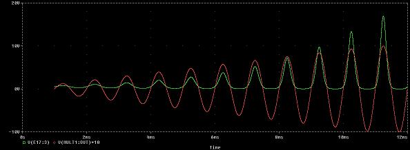

While we are at it, the classic compensated two-transistor antilog (or exponential) generator is indeed much easier to get right than the 1 transistor one I was playing around with (to be clear I did this all with a simulator so far).
In the enclosed diagram you can see the (augmented) varying input signal from 0.1 to 1 Volts and the respective output signal of the circuit.
Regards
Charles

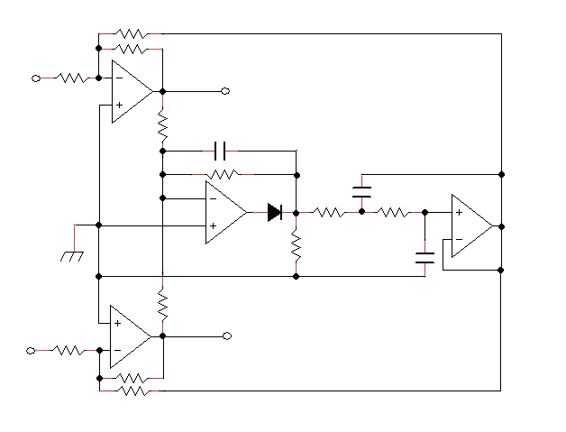

One thing to note here is that all you after is low bass roll-off and
enhancement of the fundamentals harmonics, presumably the
more the lower the note with an emphasis on second harmonic
with reducing higher order harmonics.
As mentioned earlier in this thread, probably the best way to
do that at line level is arranging to drive a small transformers
primary into bass saturation at the constant levels before
the volume control. Its easy to arrange a "drive" control
with this arrangement. Also varying some DC current
through the primary as well as the AC will add a lot
more and control the even harmonics at the output.
rgds, sreten.

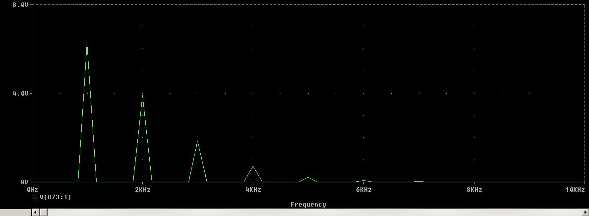

All of the schemes mentioned are much the same in that they essentially multiply the input with a natural anti log function.
As you can see from phase accurate's data, this results in a linear descending series of even and odd harmonics, a full wave rectifier gives the same thing with the odd harmonics missing, and dc saturating a signal saturated transformer gives much the same sort of thing.
The circuit I am looking at uses a full wave rectifier connected as an integrator, this is basically the circuit I posted with the addition of a capacitor.

I first tried simulating the classsic circuit like it is shown on page 19 of the following presentation:
http://www.electronics.dit.ie/staff/ypanarin/Lecture Notes/DT021-4/6LogAntiLogAmplifiers.pdf
This one is really hard to get "working" in simulation (getting a good operation point in particular) and taking into account that such things are usually even trickier to get right in practice I tried a variation of the one shown on page 21. This one sets the operation point itself. The prerequisite is that the two transistors are as similar as possible (like two from the same batch or even two out of an array) and that they are thermally coupled.
In order to get it working properly the input has to be biased with a DC voltage as high as the peak voltage of the driving signal. This way it is guaranteed that you never have a negative input voltage. Instead of subtracting the offset at the output I'd suggest to use AC coupling since you would have to get rid of the fundamental frequency anyway (at least to some degree).

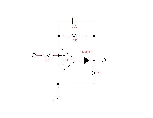

Bellow is a circuit I have on a breadboard.
It performs the rectifying integrator function mentioned in the Philips paper. disconnecting the capacitor gives it a plain full wave rectifier characteristic.
rcw
