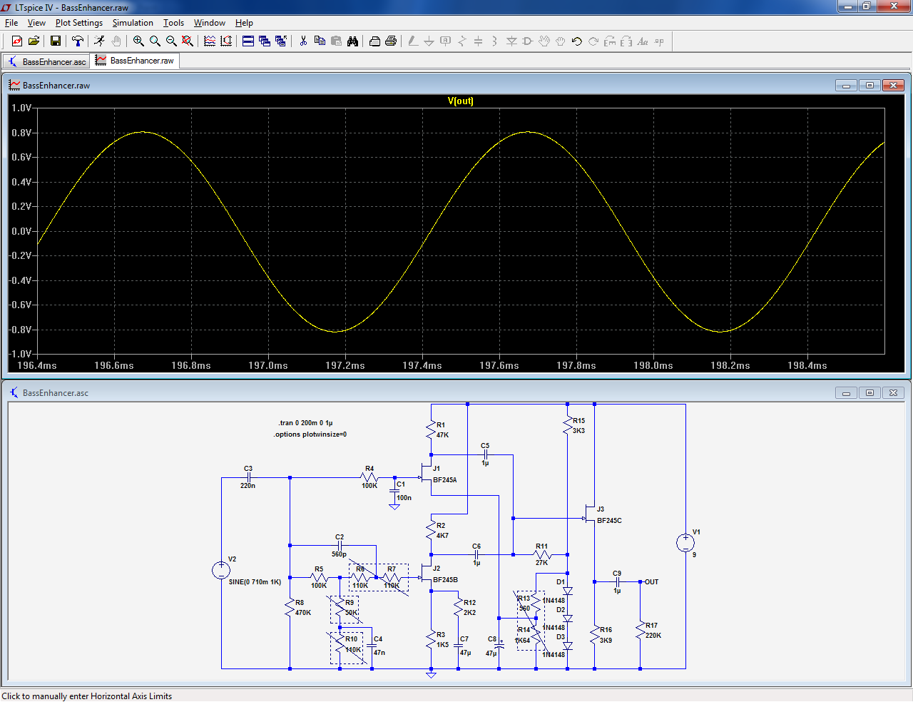

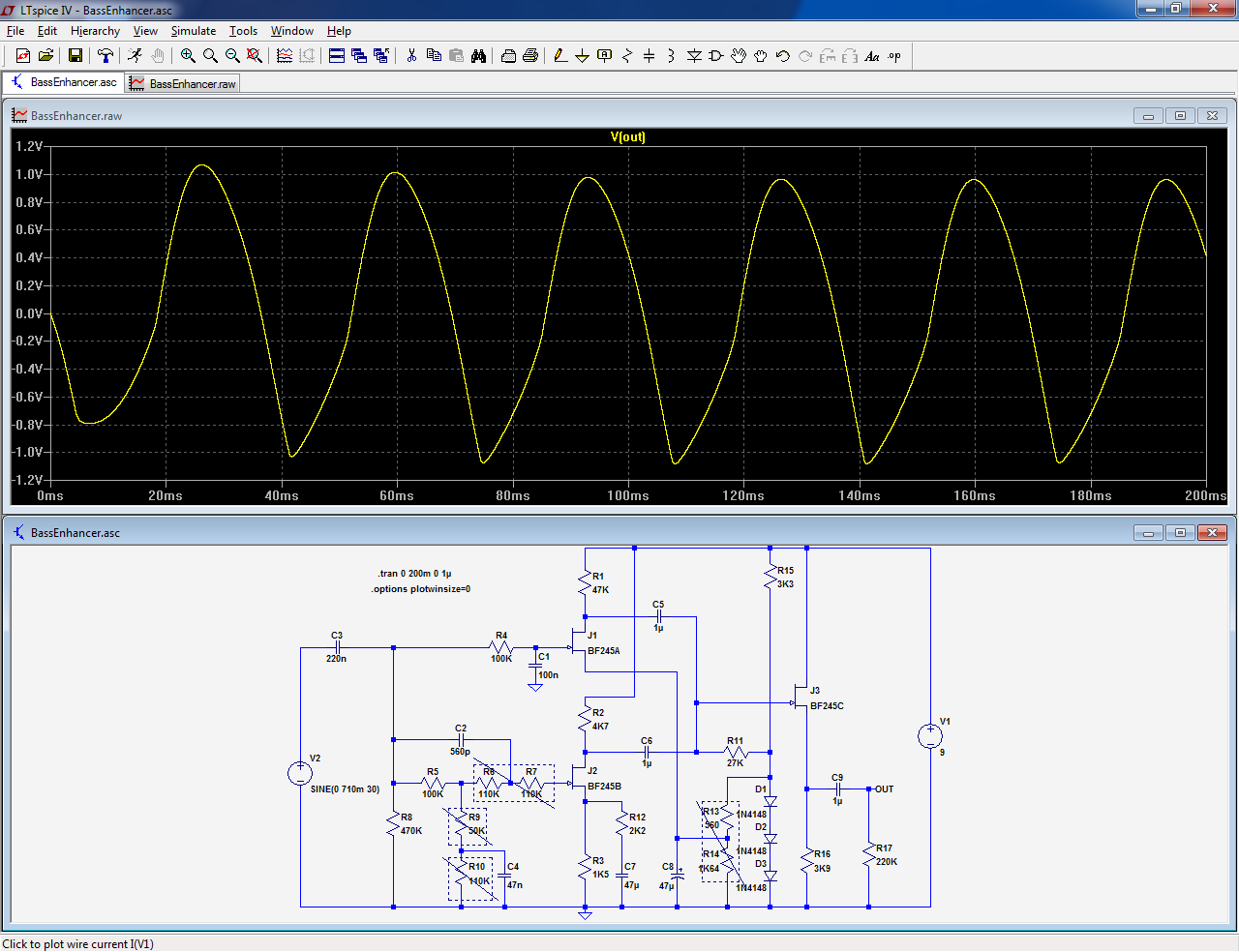

Here is the tube circuit converted to jFET.
First pic shows the output at 30Hz (distorted)
Second pic at 1KHz (undistorted)
All the pots are centered. Other values can be tweaked too (corner frequency of lowpass, etc).
If you want to make a virtual test, LTspice can accept a wav file as input voltage, process it and write it to an output file.
The operation will be similar to the original tube circuit (ie. pretty crude)
The nominal voltage is around 0.5Vrms

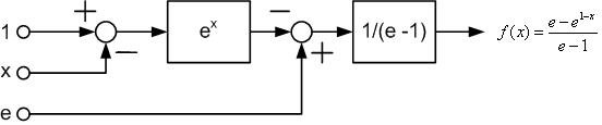

In the aforementioned JAES article form November 2011 there was a list of nonlinear mathematical functions that were used to synthesise bass and which were evaluated in terms of subjective bass enhancement effect and how they affect other frequency bands with unwanted byproducts. They even found some of the functions to be "bass-killers". One function that was rather simple and that belonged to the best ones was the the following one. It could be implemented via the "classic" analog exponential function using the nonlinear properties of a transistor. If the trnasistor variant will not work it could maybe also approximated with a diode-resistor network.
The Nominator is just a scaling factor. The difference e - exp (1-x) is making the output voltage zero for an input voltage of zero. The exponent 1 - x instead of just x or - x is shifting the function. The total function is a nonliear, continuous and monotonic.
First pic shows the output at 30Hz (distorted) Second pic at 1KHz (undistorted) All the pots are centered. Other values can be tweaked too (corner frequency of lowpass, etc). If you want to make a virtual test, LTspice can accept a wav file as input voltage, process it and write it to an output file. The operation will be similar to the original tube circuit (ie. pretty crude) The nominal voltage is around 0.5Vrms
Thank you sir! This real circuit will make an excellent comparison point. I just love having the first Ultrabass converted to Solid State.

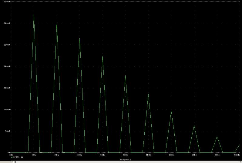

I derived a circuit that delivers the following output spectrum when fed with 1 kHz. There is one or another cap that would have to be redimensioned when used with low frequencies.
Unfortunately it is very level-dependent. Not so much the output spectrum (i.e. the ratios between the different harmonic almost stay the same) but the ratio of input to output voltage is input level dependant.
