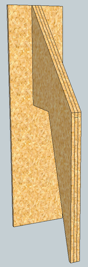

Straight sided horn only to narrow the vertical dispersion.
Yes the circle is a small driver cone, thinking Faital 3fe20.
You could get fancy phase plugging the throat, but thats
something you can muck with later, if it seems worthy.
What is to horn model about a flat straight sided wedge?
It is obviously a fraction of a circle and behaves as normal
circular radiation would within a thin plane. Reflection from
the sudden impedance change at the exit slot where the
radiation becomes three dimensional is the only cause for
concern.

Is this a simple horn, kind of like Altec Lansing used to build way back in the day?
Or is there some kind of Paraline magic to it that I'm not seeing. 😀
Its just like the throat of the Altec MantaRay horn, turned sideways.
Merely folded or bounced off a flat angled mirror to conserve space.
After thinking it over, angled mirror seems far easier than folding.
Three layers vs five? Yeah, I'll take the three layer solution...
Paraline (5 layers) you can ignore. Simply proves when sufficiently
less than 1/4 wavelength wide, turned sideways and/or folded is no
problem to go into panic mode about.
Paraline adds complexity to emulate the exit phase of a line source,
and to reduce combing effects when stacked in multiples. MantaRay
has a point source exit phase, difficult to blend smoothly in multiples.
One good argument for paraline, not relevant to this project...

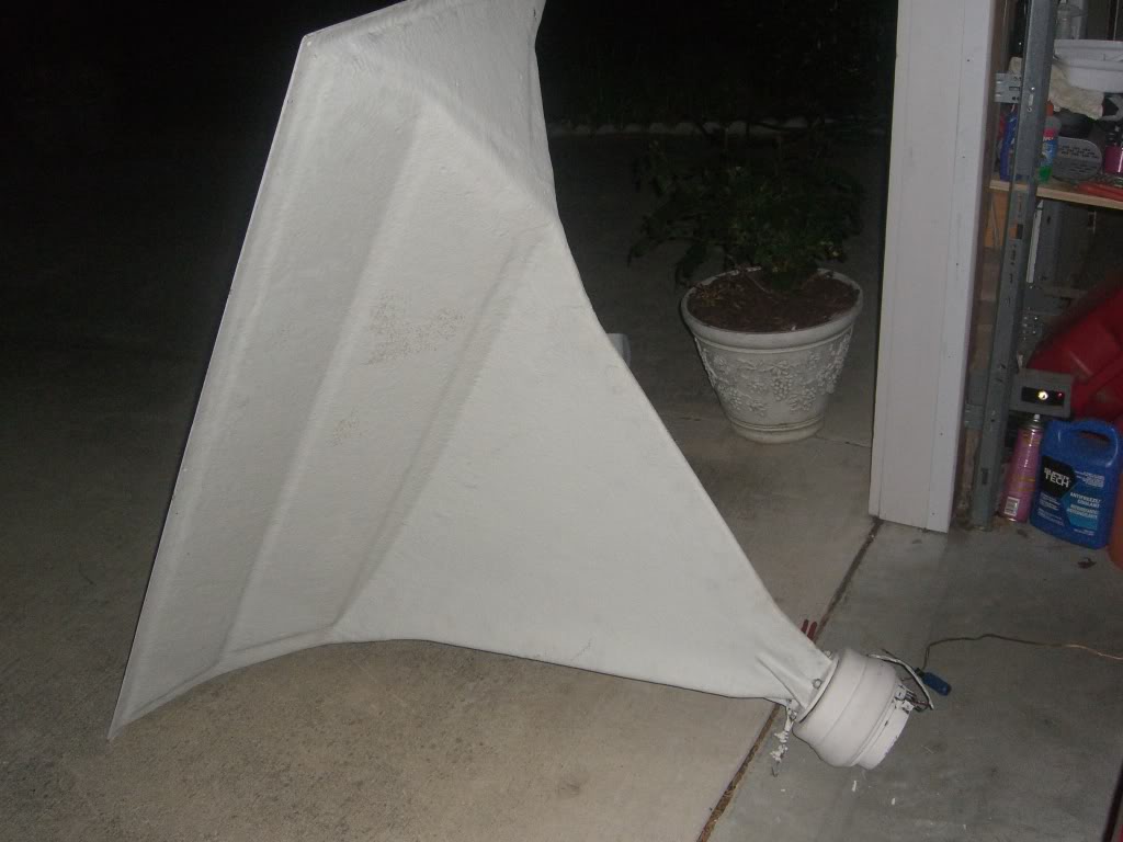

Cool pics, but nothing in that flyer shows the throat in
detail you would need to make sense of the suggestion.
Try this one...
I don't know if this example was a genuine Altec, but
clearly shows the MantaRay style of flattened throat...
Here we can see the complex mouth 60degrees wide,
but yours would be a much simpler 180degrees wide.
Just the front baffle with a slot in it.
Thanks for the link GM - very cool collection there. These horns look totally foam core buildable 🙂 They are even white in color, albeit made of polyester fiberglass.
You're welcome! Yep, been there, done that and liked what I heard. Here's the Mantaray patent: http://www.diyaudio.com/forums/attachments/multi-way/367374d1377272104-jbl-horn-04187926_1.pdf

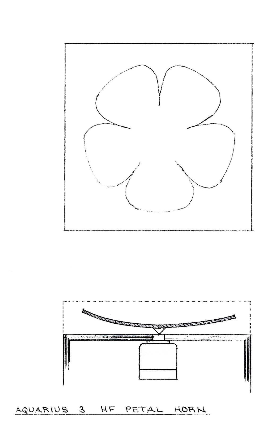

You are probably well on your way to doing something else,
but I still felt the horn suggestion deserved a legible drawing.
How you might choose to monkey the driver onto the apex
I leave to your imagination. As it depends too much on the
shape of a thing you have not yet purchased. Drilling a hole
and screwing to one side would probably do in a pinch, but
some small attention to phase wouldn't hurt.
Dimensions are 12 wide 48 tall 20 deep x 5/8 wood.
This horn covers a 20 degree vertical angle and is internally
tipped upward 10degrees, as I figure most ears will be at or
above center of the mouth. You are going to run to the same
need to tip upward, if you were to build a line array that
could stand no higher than 48".
The shape of the sandwich can be a simple rectangle if you
don't mind the extra do-nothing weight. All the complicated
shape is in the middle layer and layed out in strips of wood.
If you have a caulk gun, you don't even need to cut angles..
I originally drew it with a rectangle outline, but I felt that
it was easier to visualize the inner shape if the outer was
similarly trimmed of excess wood that served no function.
Both back and front are perfectly vertical, the perspective
rendering might make that detail not so obvious... Angle
of the throat is 20 degrees, angle of the reflector is 45...
