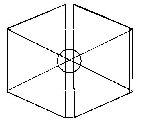

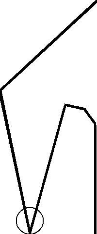

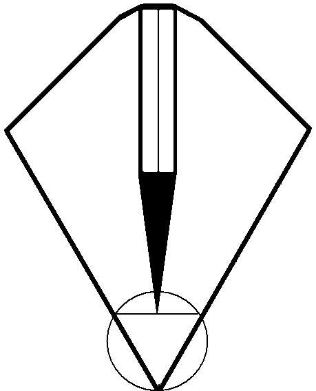

Hide the driver behind solid wood, and you get no darts in the cone.
Suppose something like paraline, but with straight conical expansion to
the sides and back to the center. An extreme flattened folded mantaray...
As for the driver, probably the faital 3fe20 at nineteen bucks... Just one
of them is 91dB sensitive, even before any horn loading effect added.
You could horn the verticals to a 30 or 40 degree cone and still get wide
horizontal dispersion from the front exit slot.

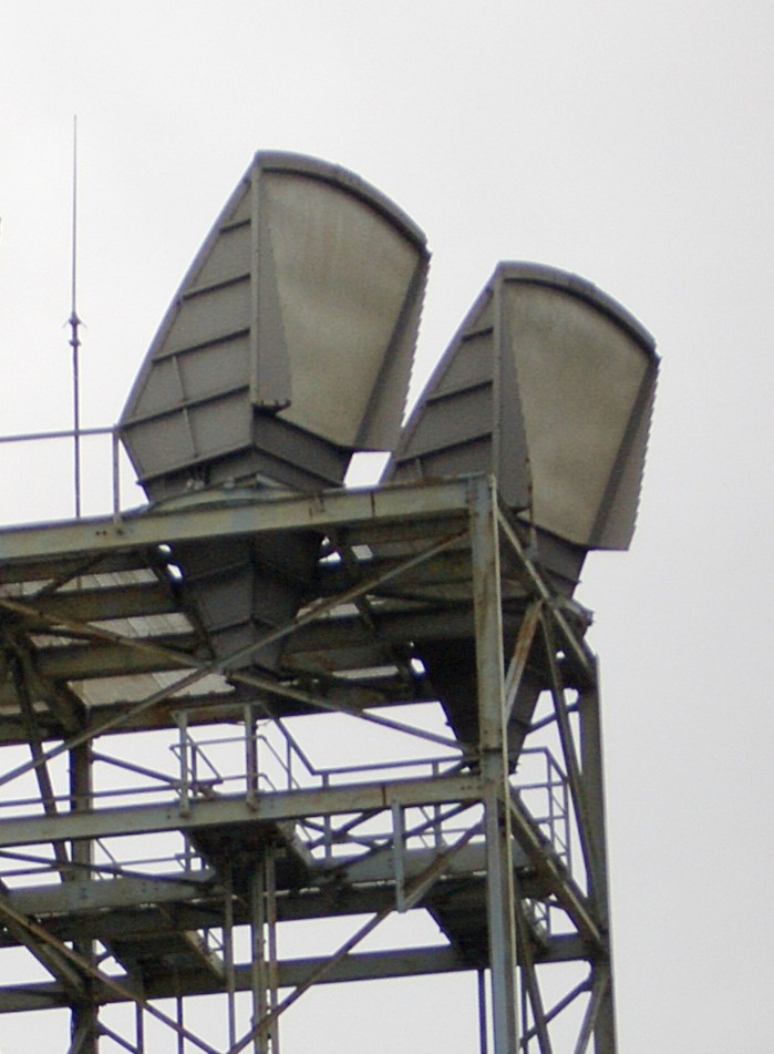

Darn you, KenPeter.
I spent four hours googling Paralines and Mantarays tonight.
I'd never heard of either before so wasn't sure what to find.
Turns out I know what Mantarays are. Just never knew you could call them that.
But the Paraline. OMG I read about it for four hours and I STILL don't think I really understand what it's about.
So, hours later and I still have no idea what you just said in your post. 🙂 However, I did learn that these are VERY difficult to design and quite unforgiving of mistakes. So without any proven plans, I'm not sure I want to get into a Paraline.
But now I want to build the Danley Unity. I'd forgotten about that type of horn. I had a Danley DTS-10 (tapped horn sub-20hz) and liked it a lot. So I know Danley is quite the engineer.

Flat like paraline, but eliminate the complex shape of parabolas.
Only suggesting a flattened triangular cone with flat reflections
at the edges where it folds back toward the center. Point source
from a single driver with narrow conical vertical coverage, and
wide horizontal dispersion. Same concept as Mantaray.
No parabolas intended to emulate a line source, which would be
too narrow vertical coverage for your app, and require stacking
many drivers (and parabolas) at greater expense to cover height
of all ears. Though not as many drivers as a standard line array.
If you can cut flat triangles, and afford one driver, there's nothing
more "plans" to it... And since the driver is behind a solid sheet of
wood, there are no worries of surviving a dart.

Twice the usual distance (including the internal fold) between front
and back of this baffle, you may not even need to close the back...
If space between dart machines is an issue, you can turn it sideways
and just build like one half of what I just drew. But then you probably
would want to close up the back of the speaker. Just another option...

And speaking of offset, Even simpler:
Three layers of wood instead of five...
Only the middle layer any challenge.
Exit slot width = twice the thickness
of the middle layer of wood.
Again, half turned sideways (edge on)
would work fine too.
All straight edges, no parabolas...
If it looks curved, my bad drawing.
The top could go straight to a point,
it wouldn't hurt anything... I was
just obsessing on 'the vertical cone',
which was ridiculous since horns
prefer a flare at the end anyways...
The little extra bit at the top (if we
cut the reflectors simply straight)
would amount to such a flare...

With those dimensional constraints, perhaps edge exit is best?
This looks even easier to build. Assuming the center layer will
not be solid where it isn't necessary, but simply made of strips...
I drew to 480x200 pixels, so should scale in good proportion.
You may want a few inches of baffle on either side of the slot
to hold the 180 degree horizontal pattern and to help keep it
from flopping over, since its so narrow. And might rattle if you
lean it against the dart machine for support. Maybe a cheap
piece of 2x4 lumber on either side of the front edge would do
the trick?
the trick?
