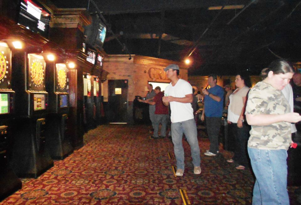

I'm trying to come up with cabinet designs that will provide ultra-wide dispersion on the horizontal plane.
This will be a mono-coaxial driver enclosure. Placed in between a couple of electronic darts machines at a local pub.
The only boundary enforcement will come from the wall directly behind the speaker and from the large dart board machines flanking it on either side.
Otherwise, this is just playing out into a HUGE, wide open bar room.
Thankfully, it'll only be for the darts folks in the immediate vicinity. Such as within 15' max, but from all sides.
Not directly in front of the speaker. As there are five darts machines.
The audio portion will be mostly for listening to live sporting events on the TV.
But occasionally it'll need to handle someone's rock/techno/other MP3 music files delivered over Bluetooth via iPod or whatever.
The driver budget is $20. And the amplifier budget is also about $20. So this is DIY all the way.

BUT, the intended audience are all within 15' of the speaker.
With the majority being within 10'.
We do not care about anything outside of the 15' target area.
A tall multidriver column
is what is needed to beam vertically giving better throw.
Vertically?
The intended audience are either standing up or sitting on tall bar stools.

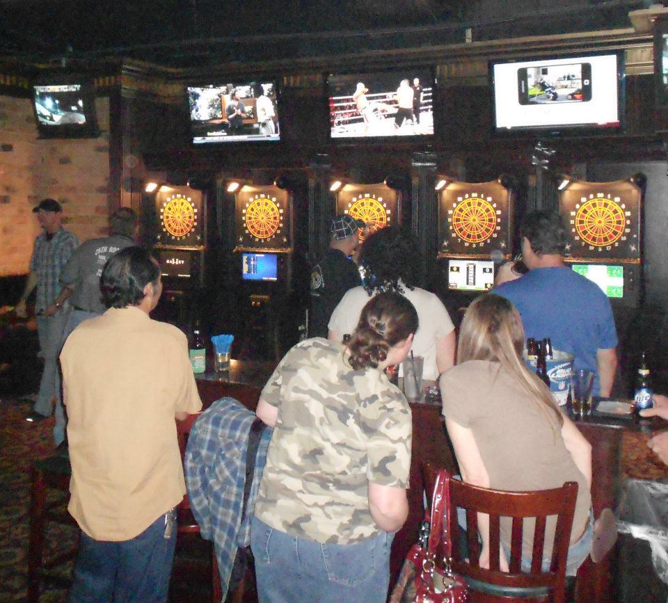

So vertical target is maybe 30 degrees at between 4.5' and 6.5' above ground. Not much to worry about there.
Horizontal audience target area is about 5' - 15' from the speaker, with the sweet spot being 7' distance from the speaker and about 10' wide.
I don't think we'll need clean 105db at the 15' mark. 🙂
There is no middle to 5 darts machines an the best option would
2 speakers between 1&2 and 4&5. Forget hifi stuff, this is PA.

Back home now.
Found some pics of the dart area. In the first pic, ignore the darts area at the back of the room.
From speaker mount to furthest listening position is about 12'.
Then of course add a few feet for extreme left or right sides.
