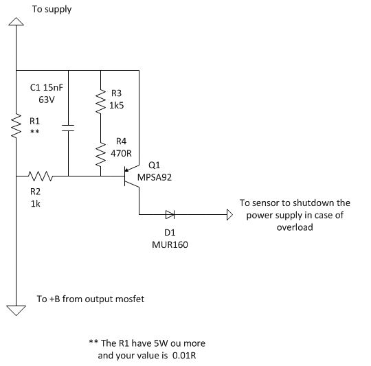

this amp not usefull without overcurent protection
how can i make a protection for it?
i have this circuit, that used in various amplifiers Class D, these circuit work with 200V from supply, but i have calculate the values from your necessity.
i hope thats this help you
can it be used in smps also.
Hi Hadighorbani, you can try this protection that has anti-bump and then controls the output in the speaker in case there is a DC voltage caused by the mosfet, the relay will trip and save the speakers from fault.
This circuit come from a magazine of electronics and this circuit is tested.
