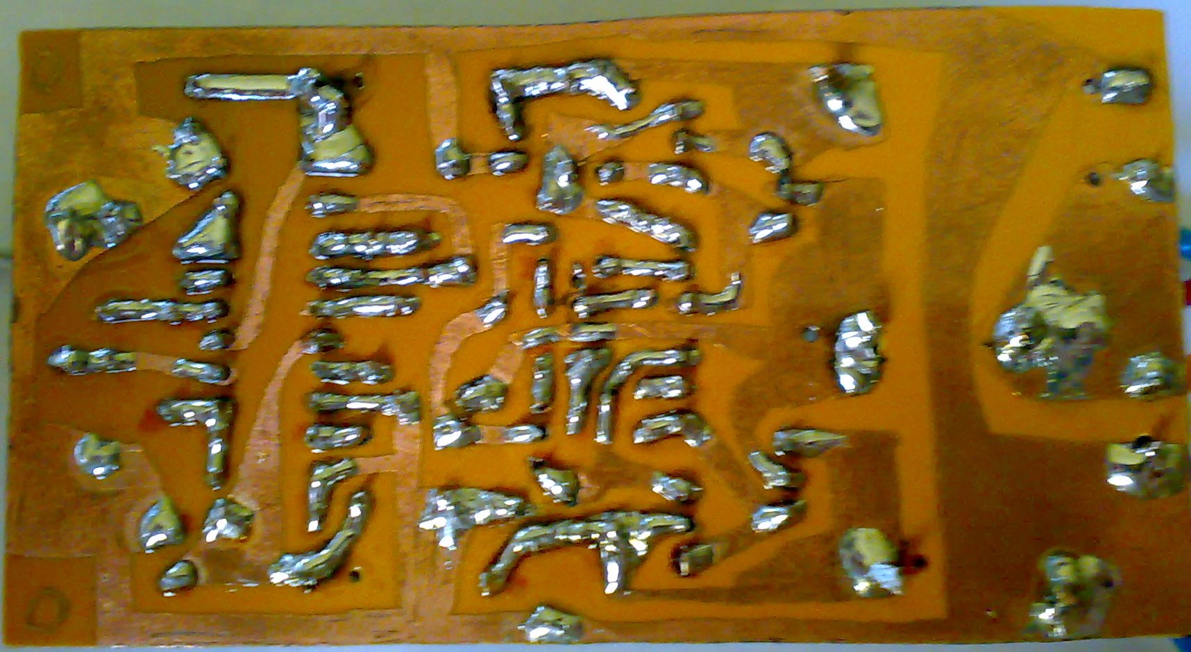

my own pcb
Hi every body
this is my pcb
is this ok?🙄

Hi every body
this is my pcb
is this ok?🙄
