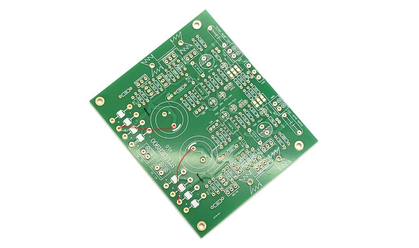

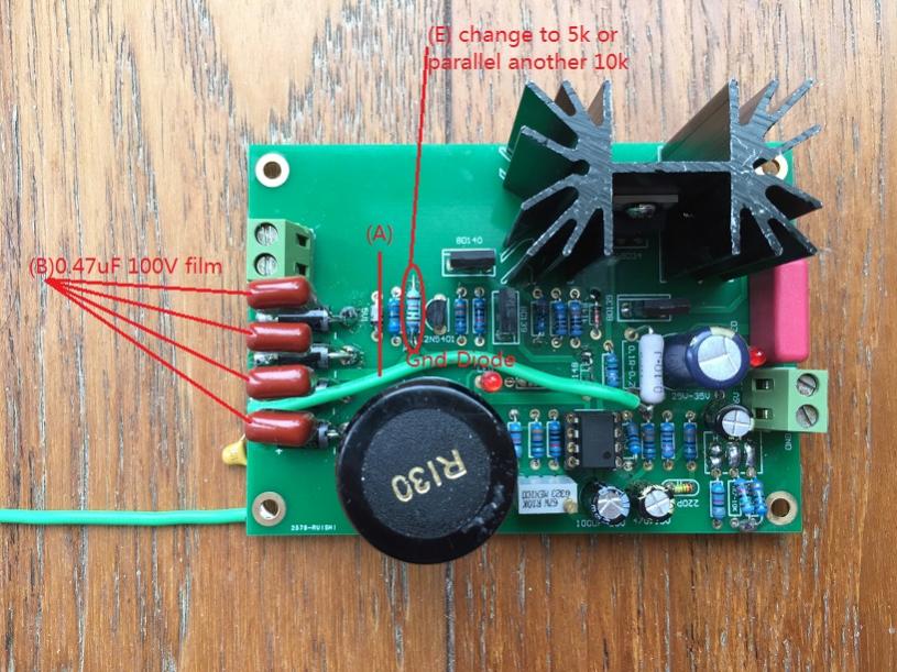

The PCB layout on the Studer900 leaves quite a lot to be desired, look at the charging current paths (and what else is connected to them) between the rectifiers and input capacitors as an example of how not to do it. There are probably a lot of other things I can't see.

Appreciate your comment. I don't have enough knowledge to understand it. Can you elaborate more and suggest how to modify the board? A magic marker markup on the PCB trace picture will help a lot.

The area around the rectifiers can also use some help. Not much more you can do without really understanding the design. I can only see so much from those photos. It's not a good PCB design, cannot vouch for the quality of the electrical design.

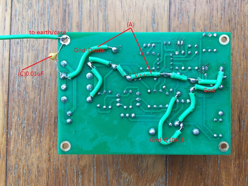

Here is an example of something I would fix. You can run jumpers on the bottom of the PCB so it's not ugly. (Cut where you see black)

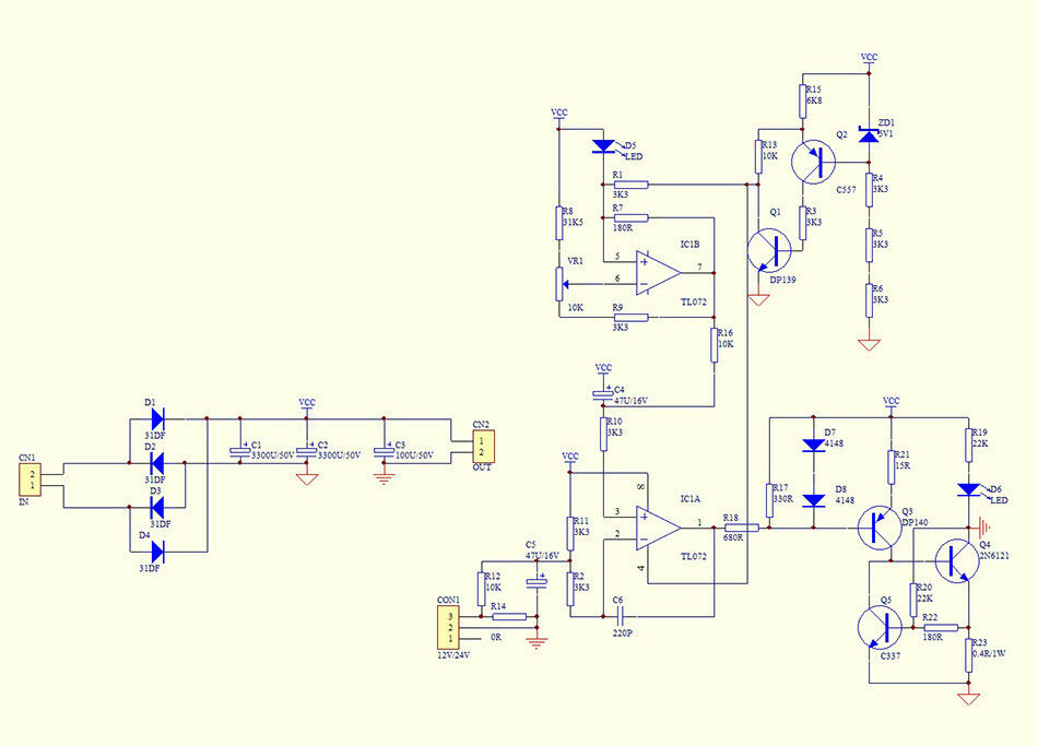

What's your input voltage to the reg?

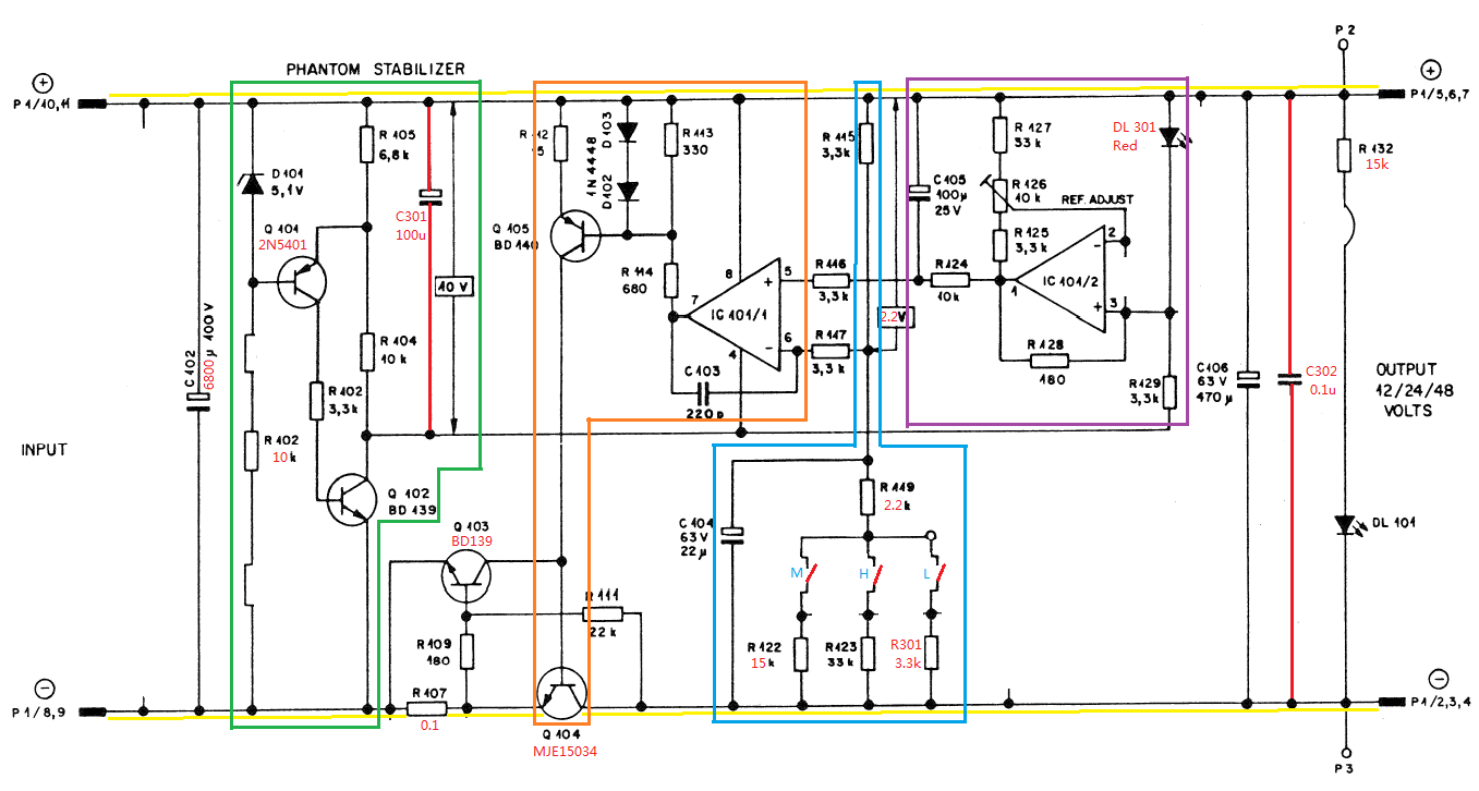

Tr1 & 2 provide a very basic regulator to power the TLO72 at approx 10V (referenced to VCC), which is the datasheet minimum. With an input voltage < about 11V the circuit may not work properly.
0.5R will give you a current limit of about 1.2A (VBE/0.5).
The Ebay board follows the Studer schematic fairly closely except the reference voltage is derived from an LED instead of the original zener. They also added an extra decoupling cap or two and simpliified the pot chain a bit. The pcb layout is rather poor and the schematic (as above) could be a lot more logically drawn!

They look worthwhile from what I can tell. The one that loops around the transistor I would find a way to shorten. (Rather than loop around cut that trace and go directly.)
I would probably run 24 awg bus wire or similar along those traces. (Add teflon sleeve for insulation or use magnet wire)
