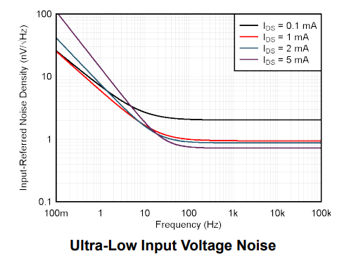

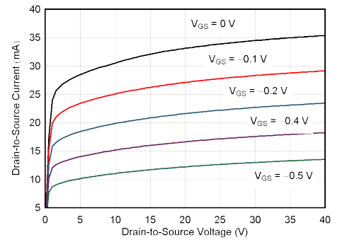

We recently launched the JFE150, a discrete N-channel JFET targeting low noise applications: JFE150 data sheet, product information and support | TI.com
Some key specs of the JFE150:
1. 0.8 nV/rtHz broadband noise at an IDS of 5mA
2. 10pA of gate current (max), for lower drain-to-source voltages. Gate current takes off above about 5V VDS. This gives 1.8 fA/rtHz input current noise
3. 40V gate to source breakdown voltage
4. 24pF input capacitance (VDS = 5V)
5. Typical IDSS is 35mA, guaranteed limits are 24mA to 46mA
6. Integrated clamping diodes. These can be floated if not used.
7. Price is about $2 in low quantities, available on the TI Store now.
This device is the first in a new series of low noise JFETs from TI. I'm personally very excited about these devices because I believe the market could use more options for high performance JFETs. I'll post here again when we release more devices in this family. I'm looking forward to seeing the feedback here on these new parts!
Some selected datasheet plots are attached.

A few questions :
1) There does not seem to be any data or information on the leakage of the integrated diodes.
2) There seems to be no grading of devices according to Idss, as in many other audio JFETs.
3) Can you remark on the dependence of Id vs Vds as compared to e.g. 2SK170 ?
4) What is the maximum dissipation without affecting reliability, assuming normal traces and no special heat dissipation copper on the PCB ?
5) At almost 1µA of gate leakage at 15V Vds, can it be realistically used without cascoding ?
Thanks in advance,
Patrick
Hi Patrick:
1) We test the gate current leakage in the INPUT CURRENT spec. with the clamp voltages set to 5 V and -5 V. Overall, the clamp diodes contribute very little current to the leakage (the diode size, and therefore leakage, is much smaller than the JFET).
2) Correct, there is no grading, all JFE150's will use the specs. listed in the EC table.
3) I'll have to check on output impedance/Id vs Vds compared to 2SK170.
4) Theta JA is ~ 200 C/W, and die temp. should stay at or below 125C. So, max. power can be calculated by P = (125 - max. ambient temp)/200.
5) Depends on input/source impedance - for the highest input/source impedance cases, we would generally expect < 5 V VDS without cascoding (I believe you know, but, just in case, higher gate leakage with increasing VDS occurs on all JFETs).
Best Regards,
Mike

Thanks for the feedback Patrick,
True, the small SC-70 isn't the best for thermal dissipation, we were targeting applications that require small PCB footprints.
As for the use in Audio, the main attraction is the ability to achieve ultra-low noise, better than any other JFET we have measured at the same IDS. We have more data/collateral on the way that will highlight the advantages of this JFET (specifically noise) and why we believe it will be popular for audio amps.
More to come,
Mike
