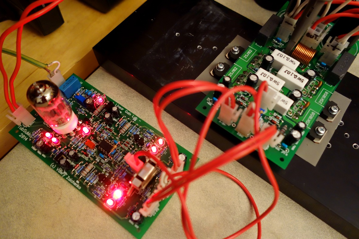

I started populating the IPS today. I have some questions.
I see two separate inputs. What are their purposes?
Why are there two 2.2uF input caps? Would one 4.7uF work?
Is the trimmer necessary since there is a servo?
What do schotty diodes do that standard diodes don't?
Thanks, Terry

Hi Terry,
Ok, answering one by one 🙂
- Two inputs - one is DC-decoupled (via the cap), the other one is direct - DC-coupled. Just to have both options available.
- Two 2.2uF caps - one 4.7uF will be fine, it was just difficult for me to find the one of appropriate size.
- Trimmer - not mandatory, can be jumpered. You're right, DC offset is controlled by servo, the trimmer potentially allows to set the best possible local balance for the input LTP for the minimum distortion. However, you need a THD meter or a good spectrum analyzer to see where the minimum is, also, the influence if rather subtle.
So, all three points - not mandatory 🙂
Valery

Also, the leds close to VAS - there are 2 placeholders at each VAS shoulder, but you can use either one blue LED and jumper the second placeholder, or use 2 red ones (at each shoulder), occupying all of those places.
Those Schottky diodes - they are faster and they have lower voltage drop, than the normal ones. They limit LTP's maximum differential swing, allowing even better (softer) clipping, then "super VAS" normally offers.
I have checked in simulator - 1N4148 will work there just fine. Again - very subtle difference 🙂

Hi Valery,
Can you produce a components view that has only the part numbers and not the values? Some of them overlap on the screen print and make it hard to read. It would make locating the parts much easier.
Thanks, Terry
Thanks, Terry

Sure - no problem.
Sorry, I was too lazy for aligning them properly on such a "busy" board 🙂
Promise to improve in the future 😉
