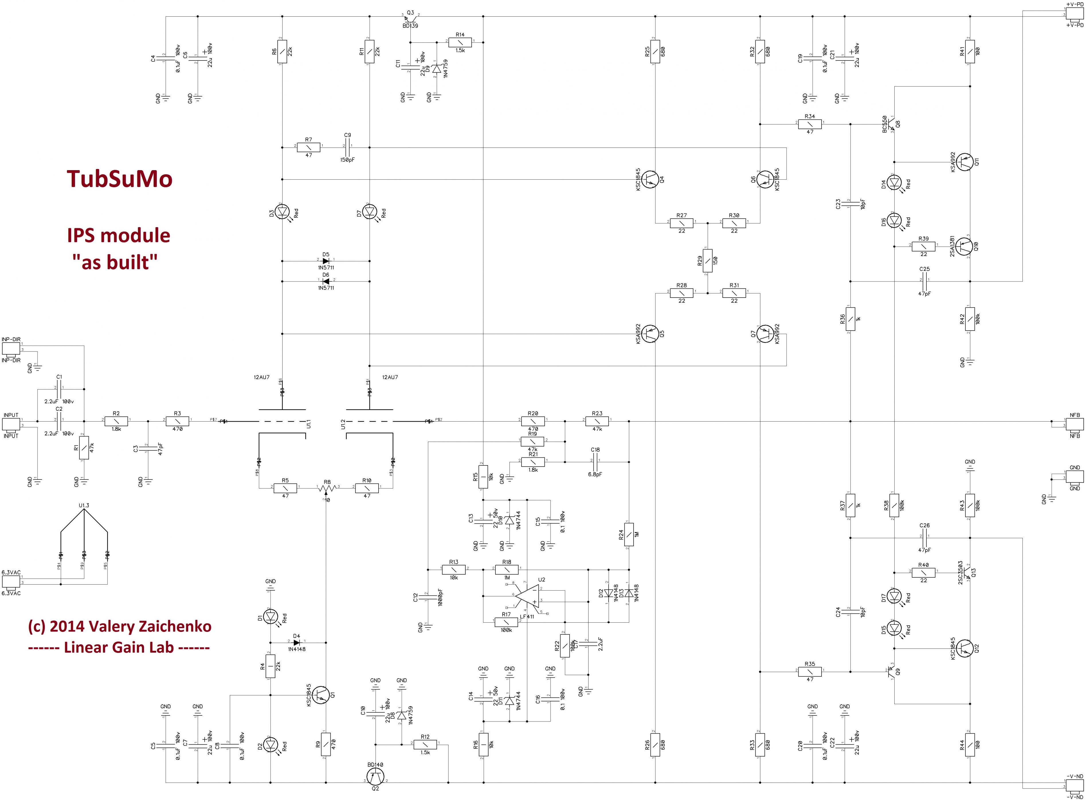

IPS module schematic "as built" and updated BOM
Here are the updated docs...
Changed values are marked by green in BOM spreadsheet.
Have fun 😉

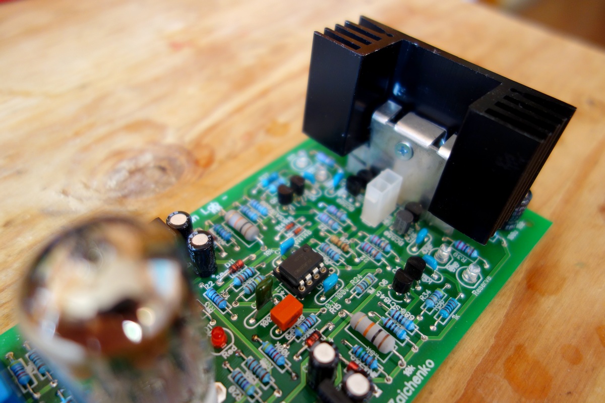

Heatsink!
Please use a heatsink for TO-126 ones - they run pretty hot here.
Valery
P.S. Just noticed on the picture 2.2uF cap is missing (DC servo) - it's useful sometimes to see a close-up picture 😀
