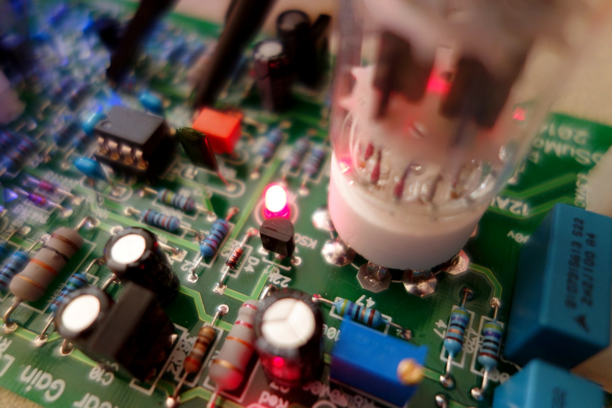

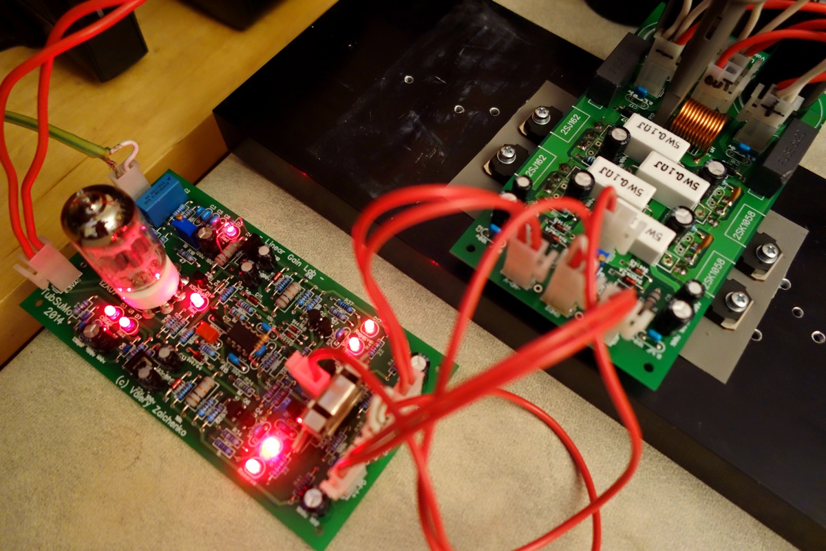

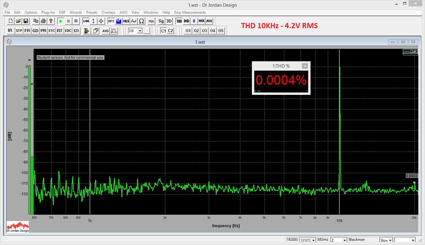

IPS first power-on
The firs impression is pretty cool. Great performance at wide range of signal parameters. Attached is a square wave response at 20KHz and 120V amplitude 😱
Next will be some DC servo tune-up, testing noise levels for blue and double-red LED options for VAS cascode offset and distortion level measurements.
After that - overall testing together with OPS.
Out for scateboarding for 2-3 hours (Hugh, as promised 😉).
Valery

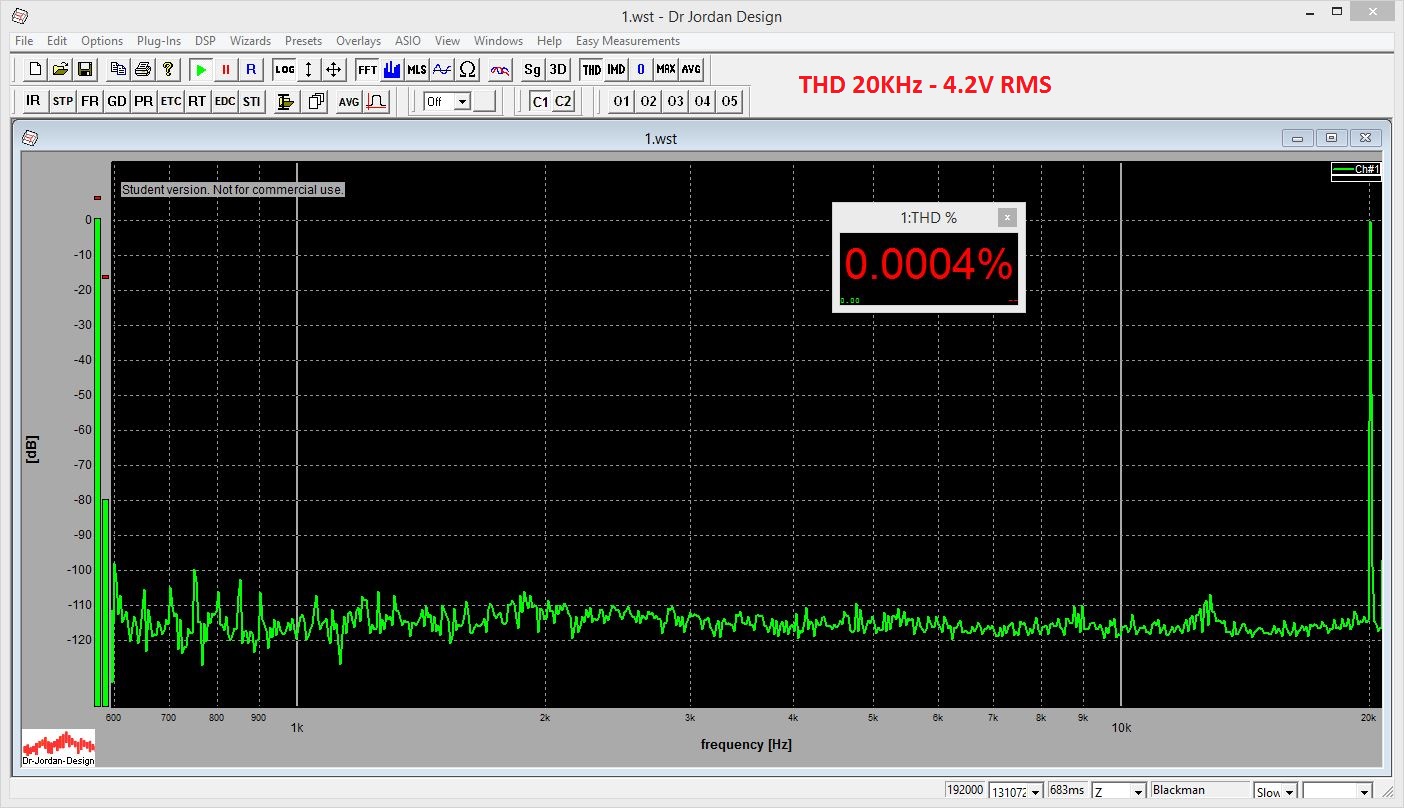

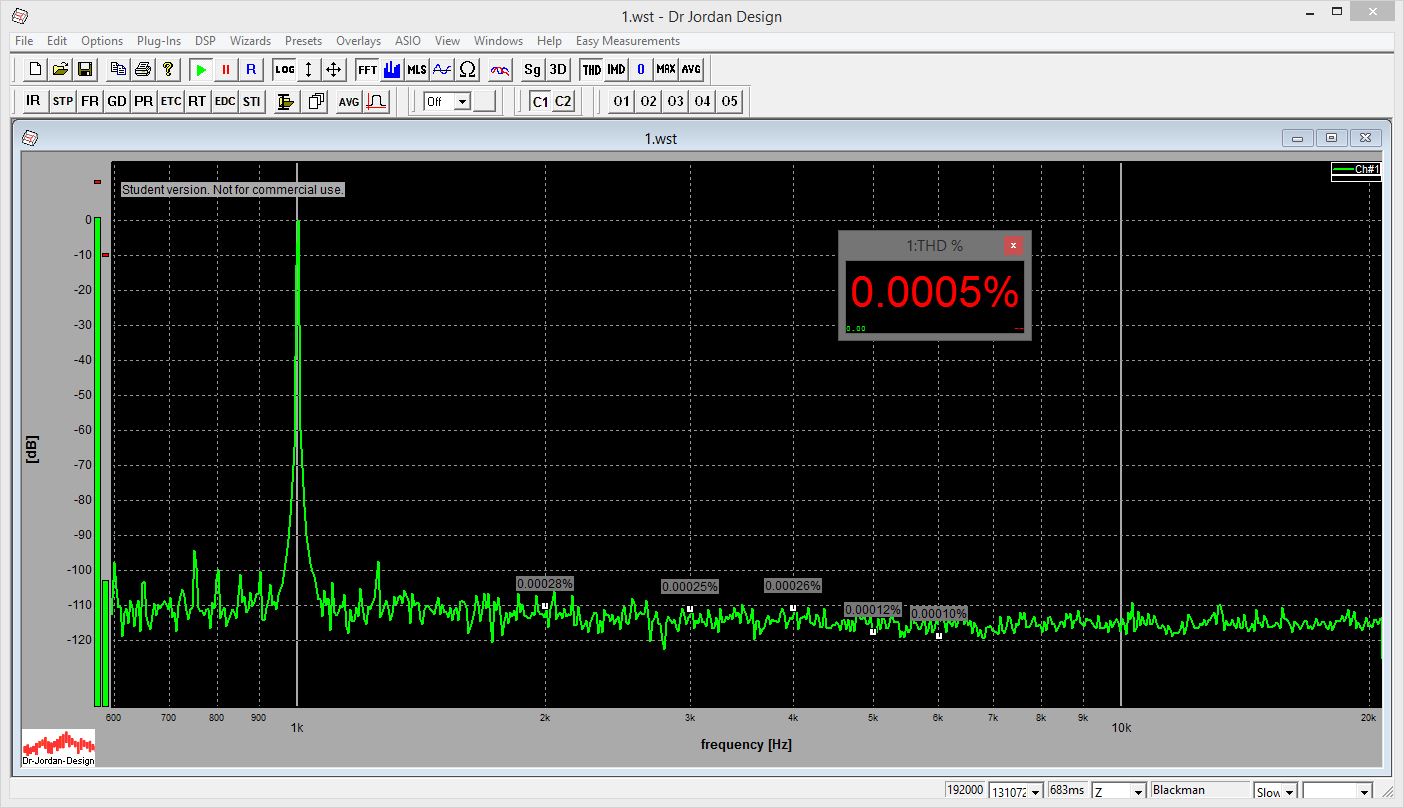

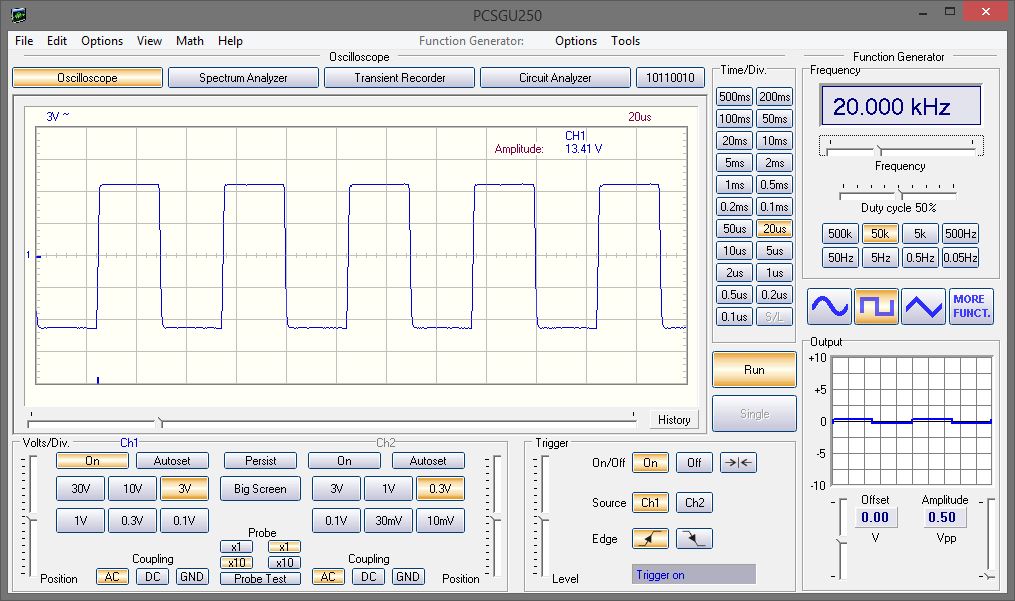

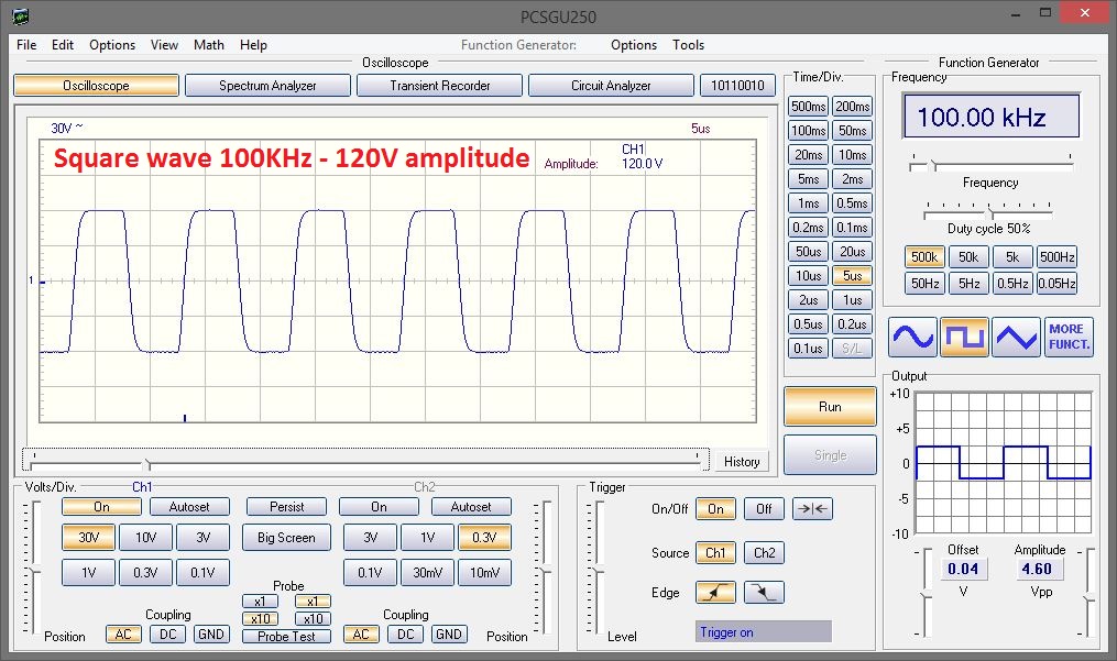

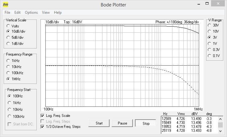

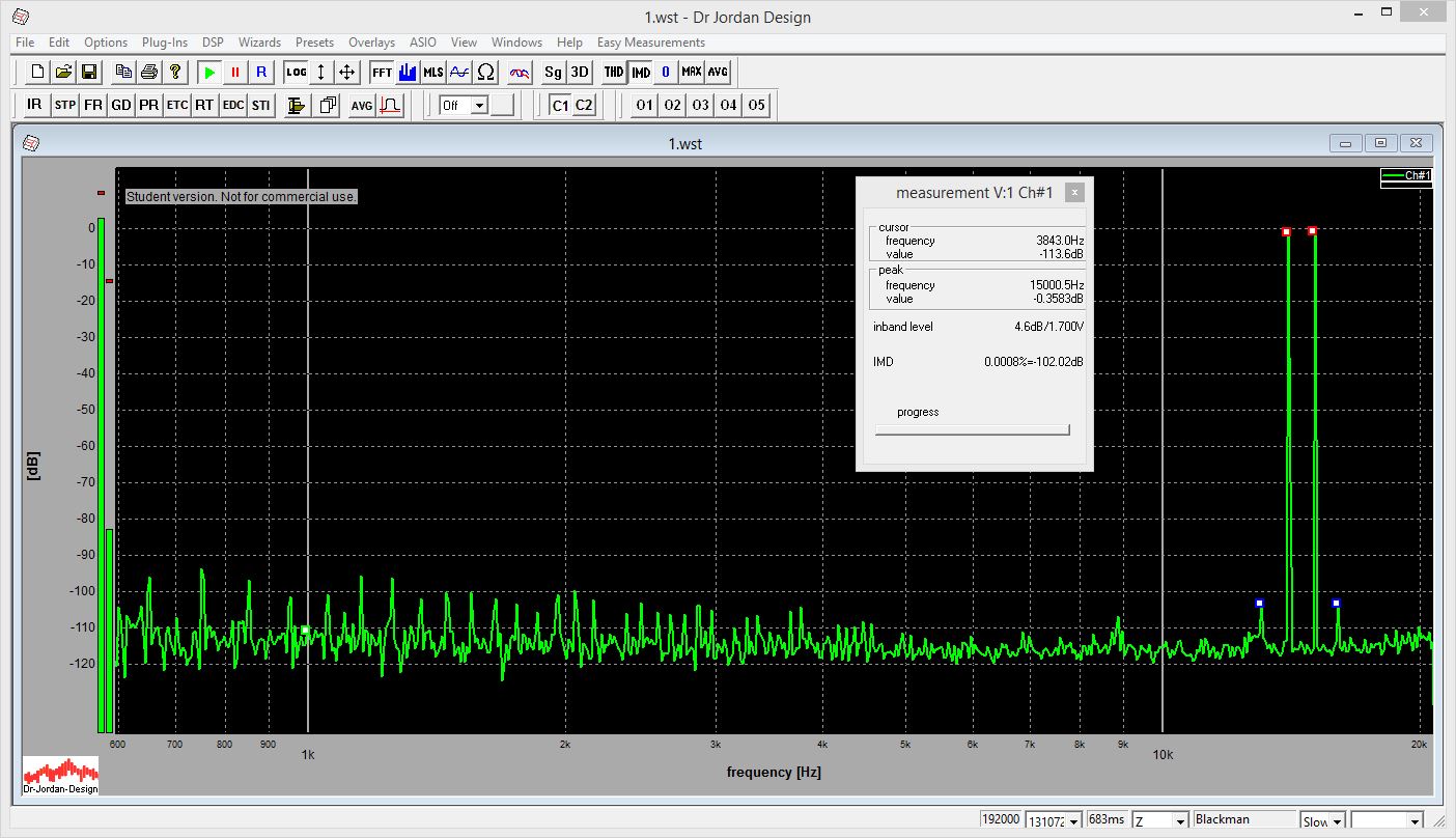

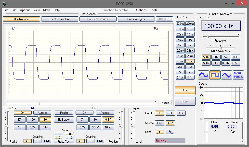

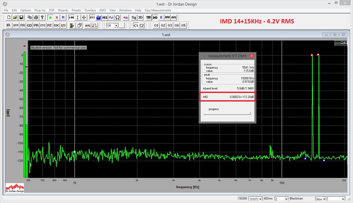

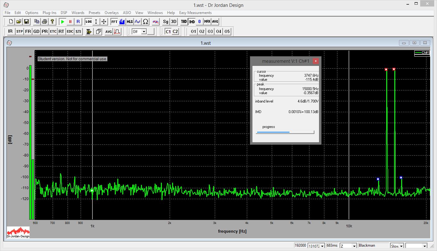

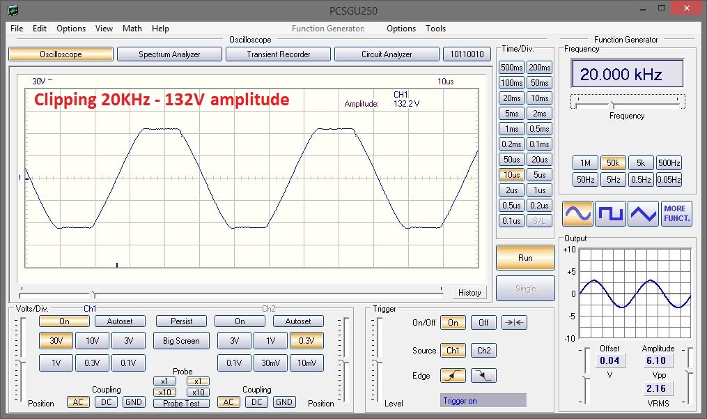

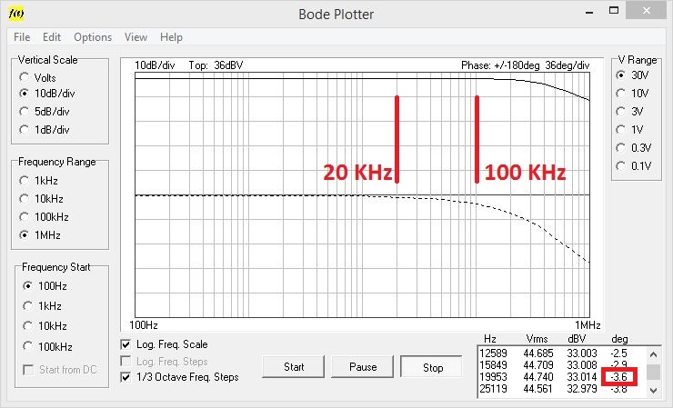

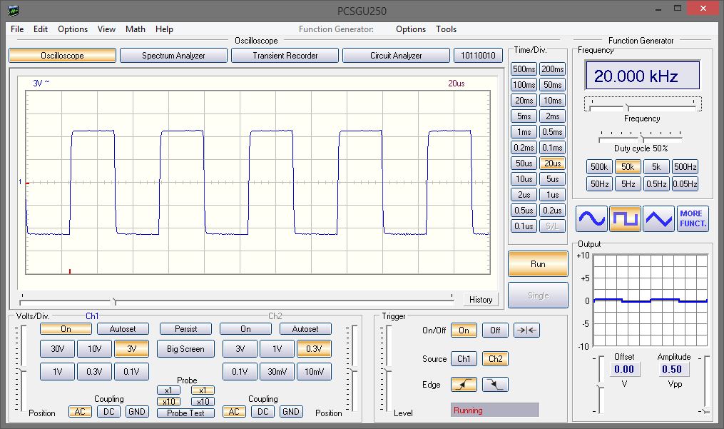

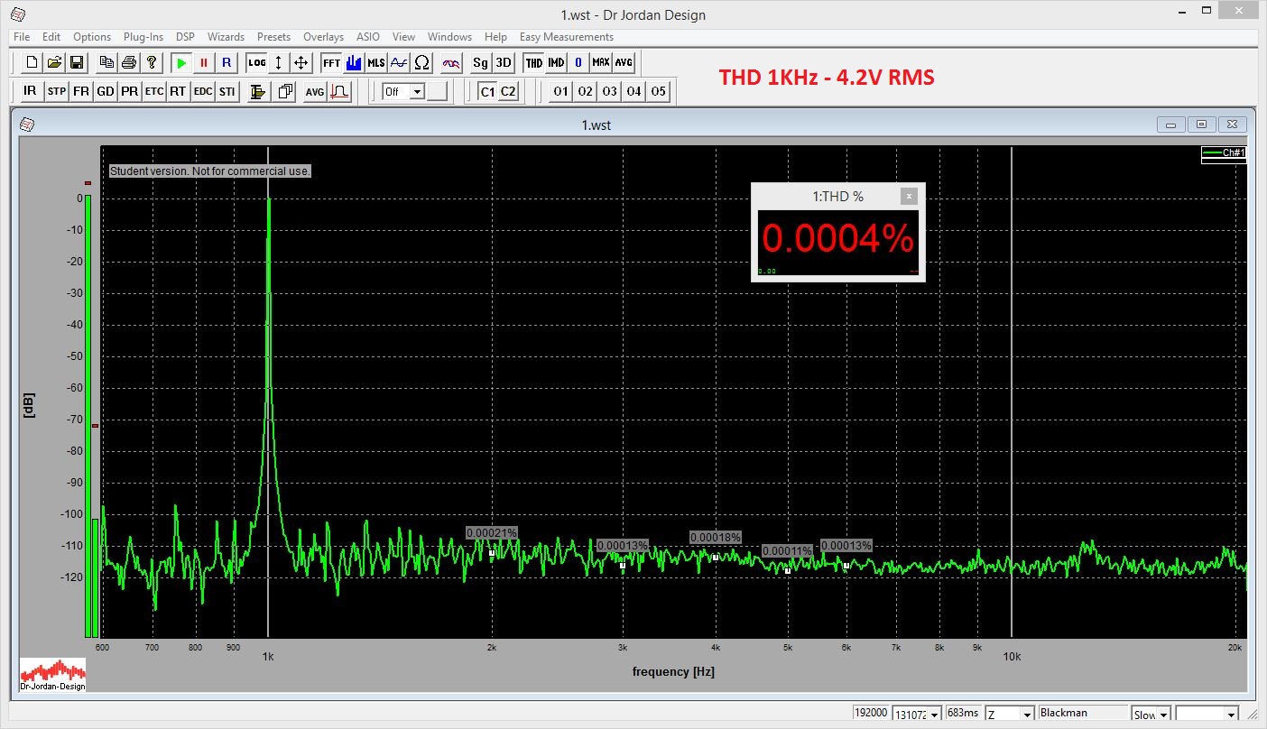

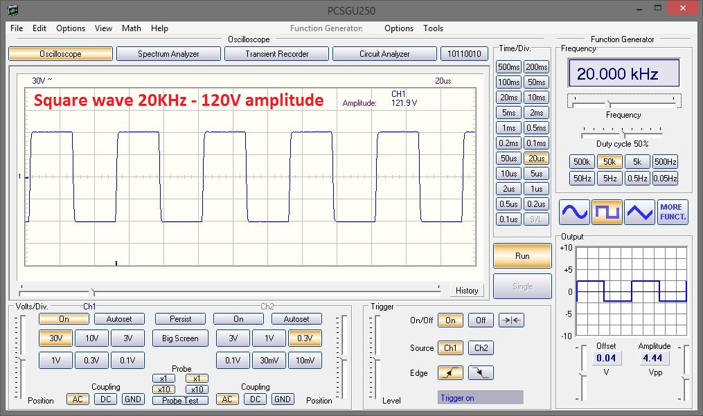

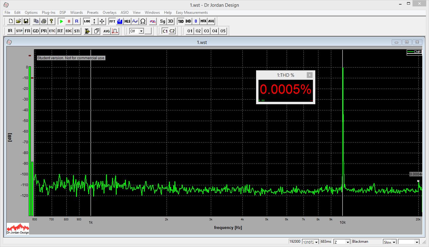

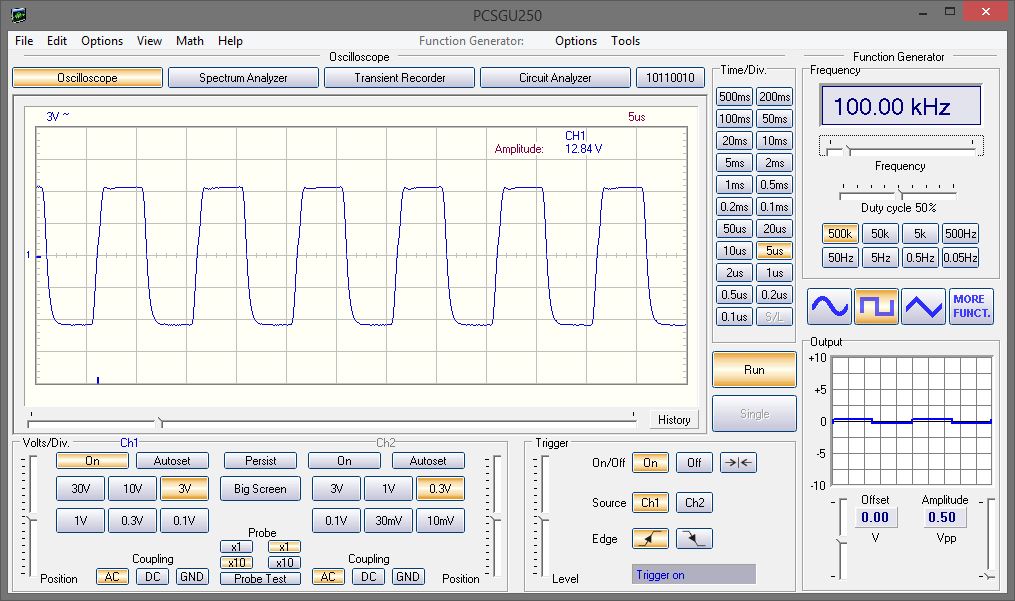

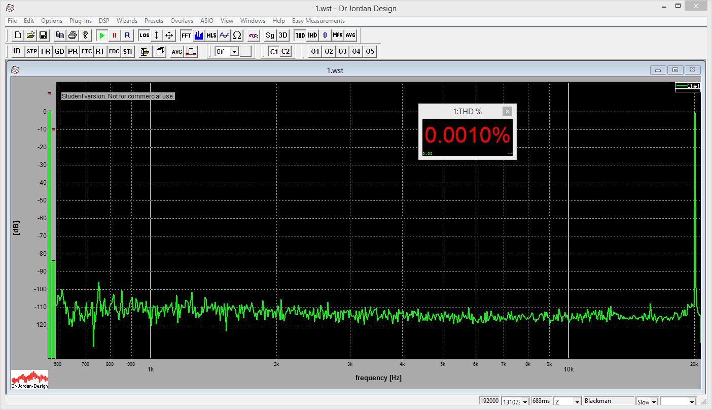

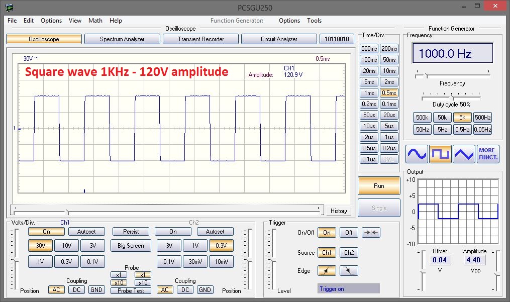

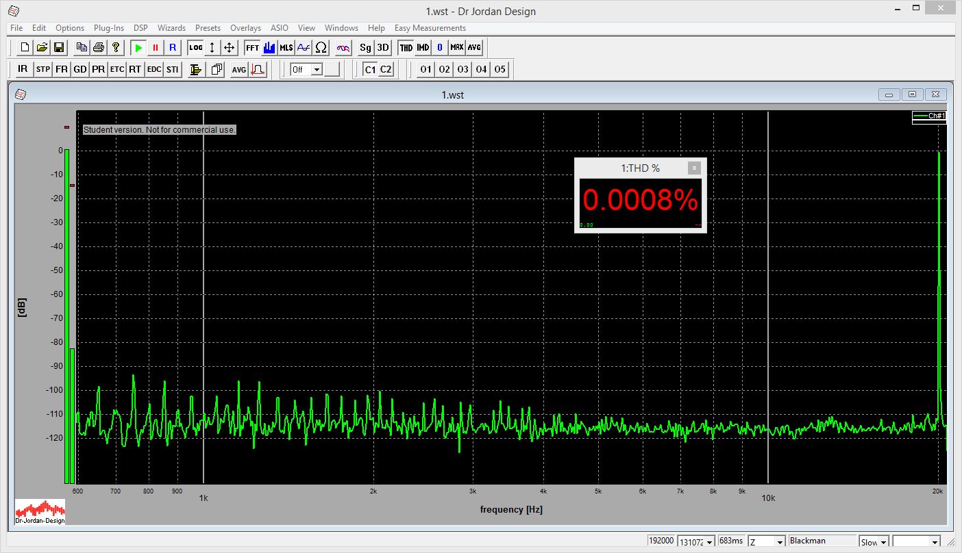

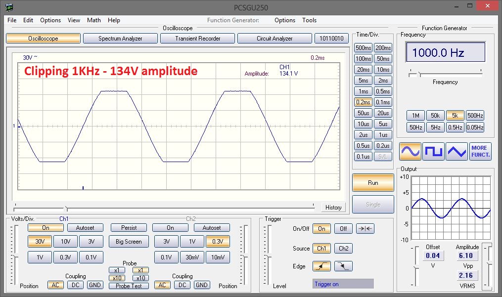

IPS standalone
OK, some measurements on IPS alone (~20Kohm resistive load).
I deliberately ran the square waves at high swing - that's where some artifacts normally appear.
Good points - only 3.6 degrees phase shift @ 20KHz, nice clipping, very good square wave response, THD / IMD - no comments.
Pretty fast VFA. Well, OPS will slow it down - we'll see, to what extent...
Checked with a pair of blue LEDs in VAS offset circuit as well as with the double-red pairs. No difference in noise floor. Just not at all. Nothing. Left double-reds for now, but either can be used.
So far so good... Next test - with OPS attached.
Valery

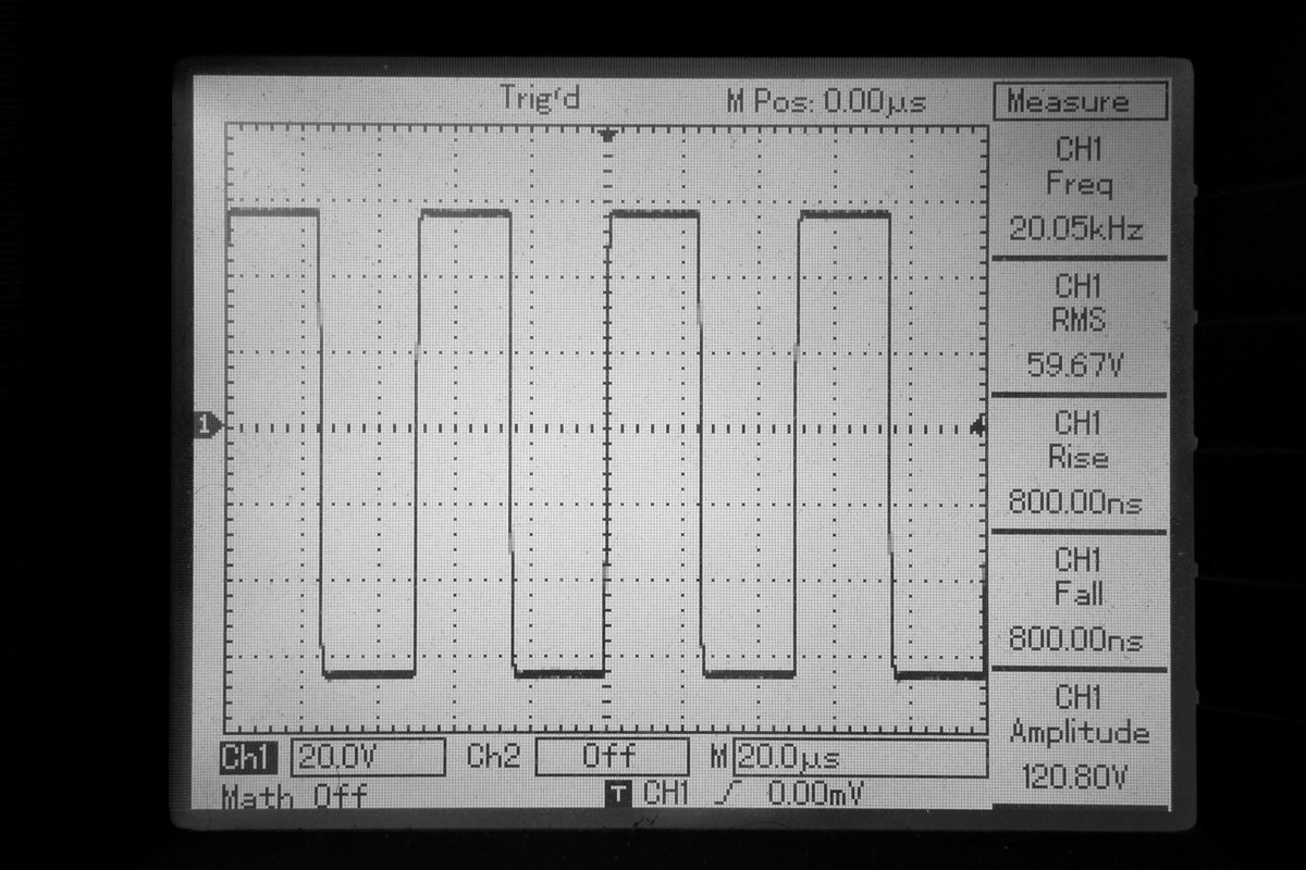

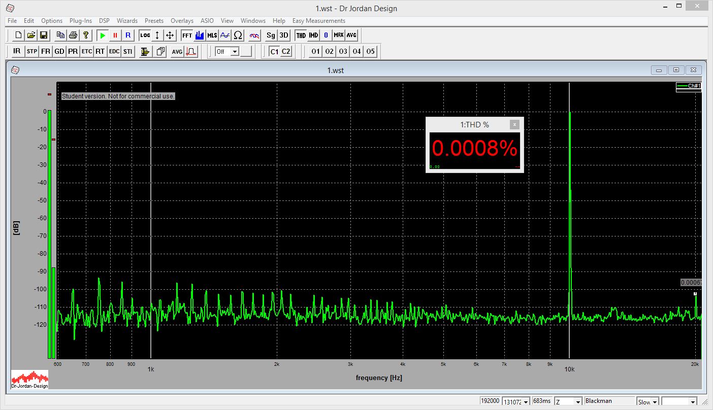

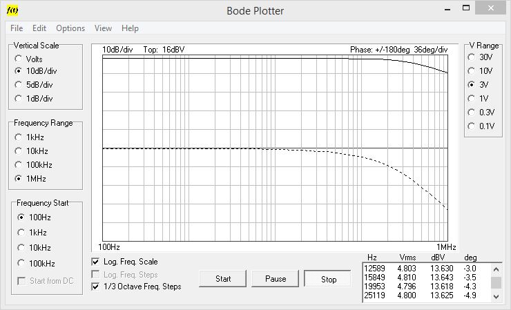

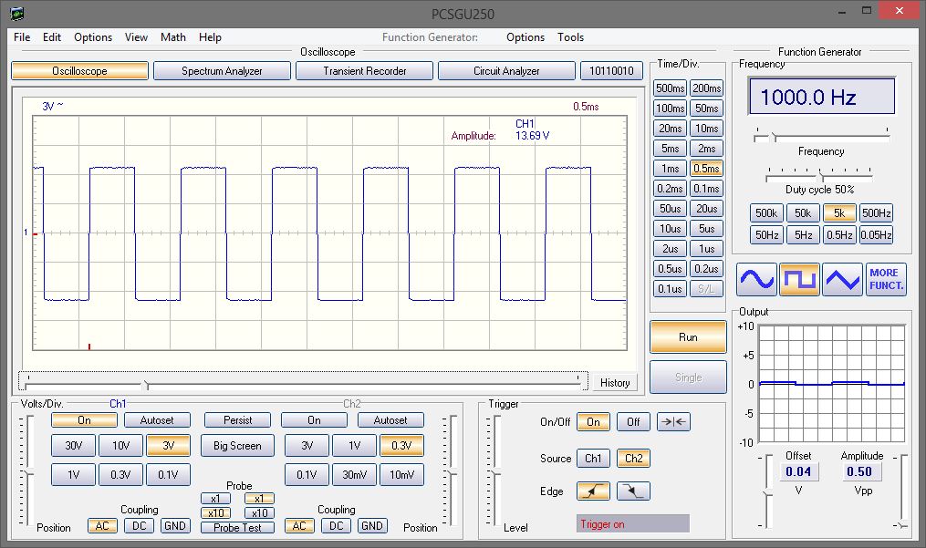

Alright, here we go.
Measurements are done with 8R load.
This one is with the Lateral FETs OPS.
One poorly soldered wire gave me some really hard time. Everything looked fine during measurements, but when I disconnected the measurement system for doing some listening, it started giving some 0.7V negative offset at the output. Then it slowly increased and at about 1V protection triggered. Drove me insane 🙂 Almost an hour of tough troubleshooting, until I realized - a thick wire, connecting G1 and G2 grounds is soldered, but does not really contact the trace at G2. During the measurements, the ground was coming to IPS module through the cables. It was a long way, but it was a connection. As soon as the measurement system was disconnected, IPS's ground started floating...
I will probably re-measure this setup as it may show even better results with the proper ground wire. Can't do it now - exhausted 🙂
Well, after proper soldering, it plays nicely. Dynamic, detailed, natural sound. Very pleasant. Will ride it tomorrow at high volumes.
Both setups are rock stable (76 degrees of phase margin according to simulation). No sign of oscillation.
Terry, you can order the PCBs now 😉
Test with SlewMaster-based IRFP OPS - see the next post.
Measurements with EF drivers + IRFPs at the output.
Pretty close to the previous one.
Slightly higher distortion at 10KHz, but very slightly lower at 20 KHz.
Anyway, overall distortion level is so low - it doesn't really matter...
Need to listen an high volumes to see if there are some audible nuances.
Also - would be cool to test with BJT OPS, just don't have one in hand now.
