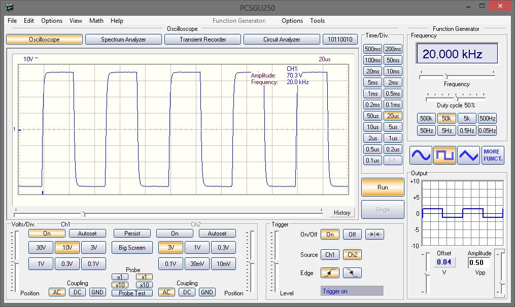

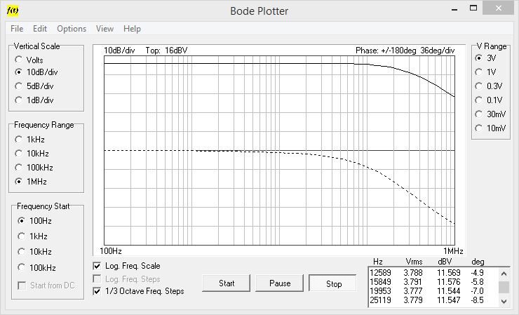

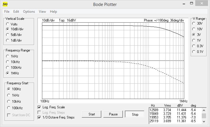

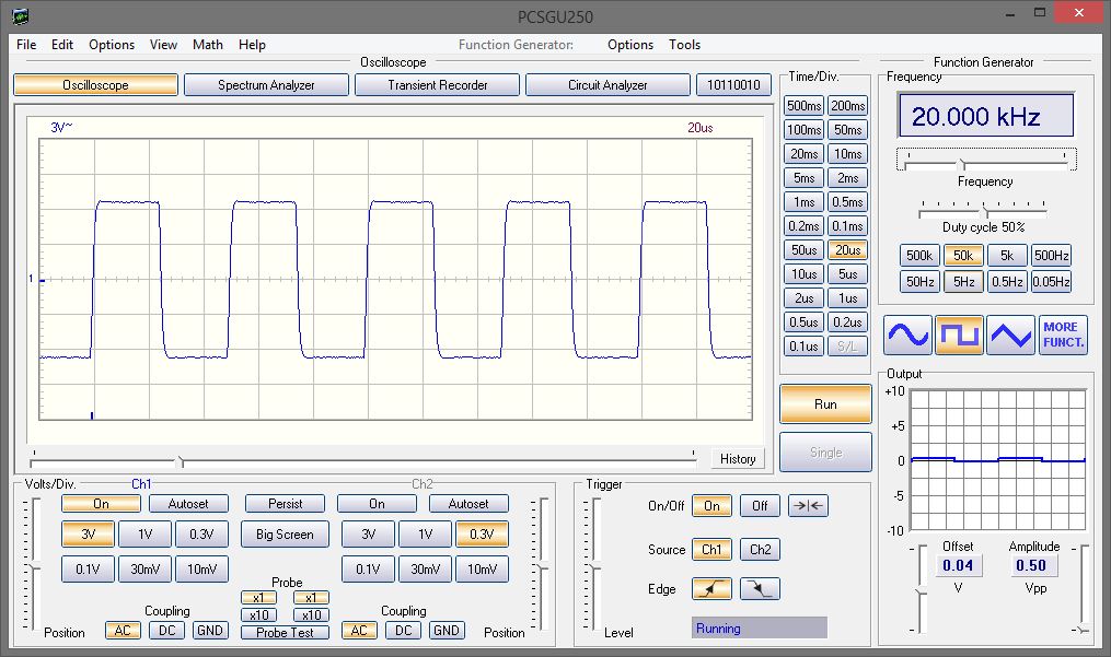

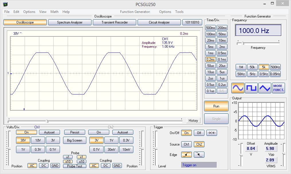

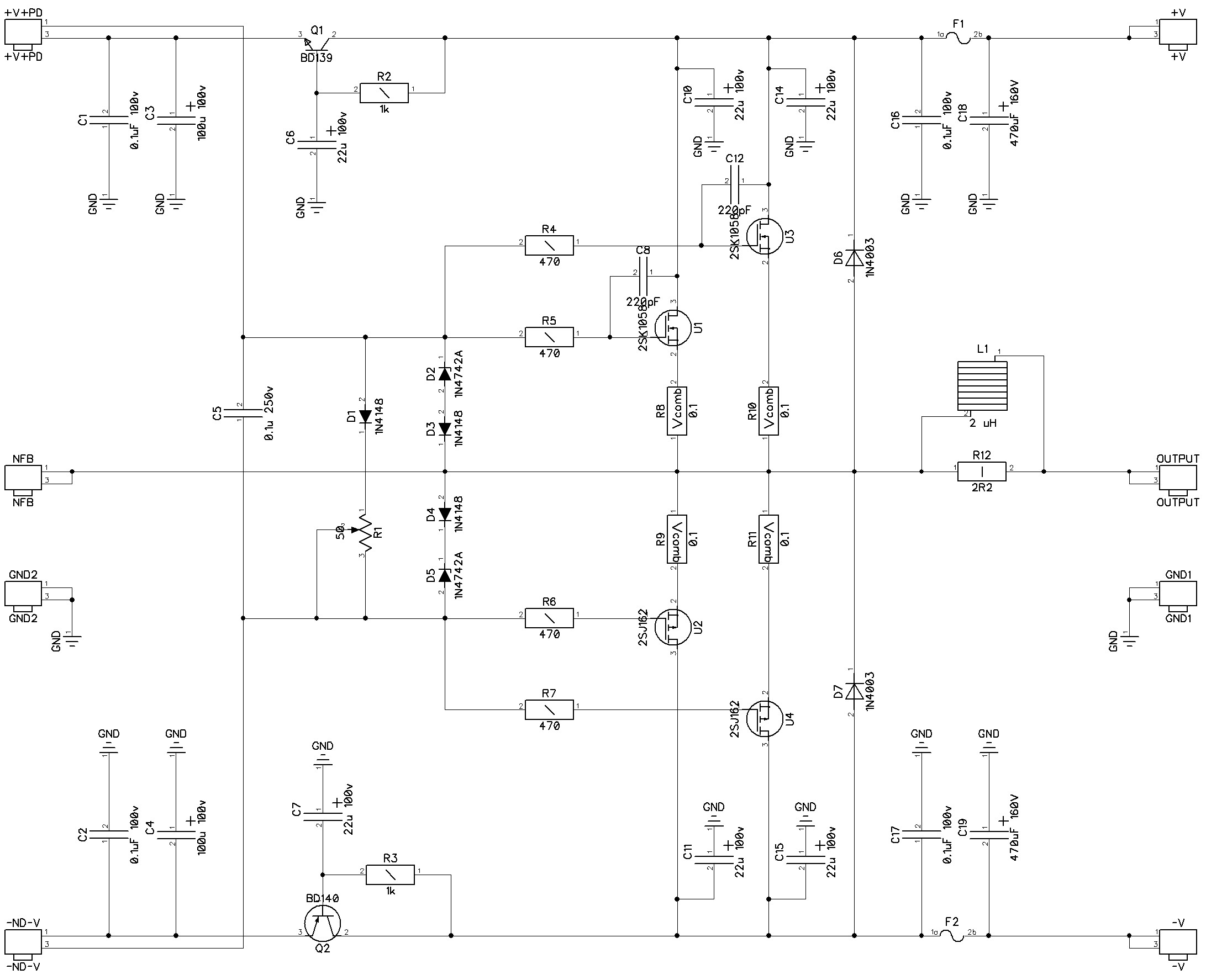

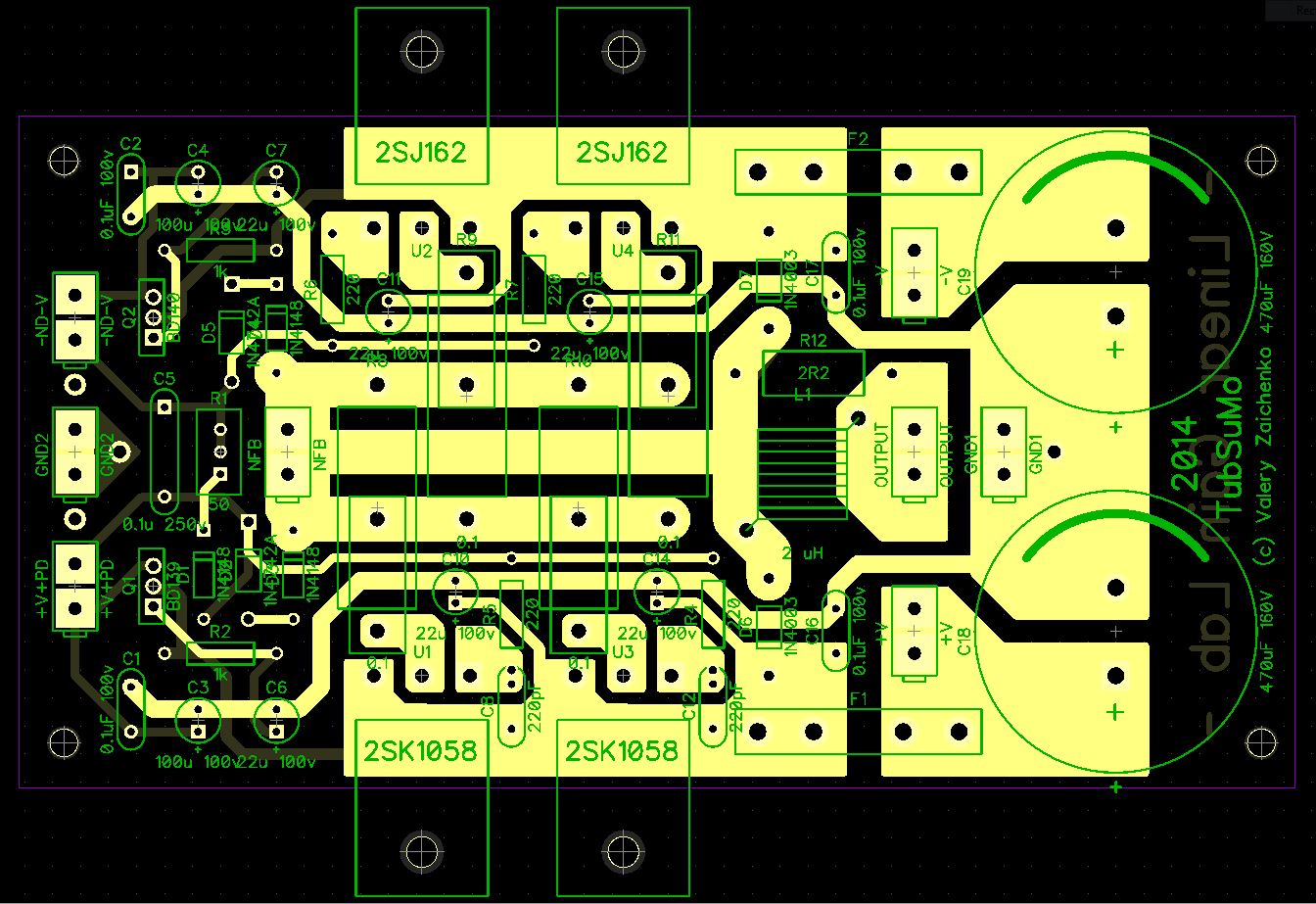

OK, attached the OPS to the heatsink, hooked up the Low TIM Hybrid IPS and gave it a try. Initial power-on showed stable low-volume oscillation at 5.38 MHz. Well, rather expected. 220pF caps between the gates and the drains of 2SK1058s solved the problem. Later on I have also increased the gate stoppers'value up to 470R in order to optimize the fast fronts response.
Load is 8R resistor.
Attached are the live measurements in the following order:
1) Bode plot for Low TIM Hybrid IPS (no OPS);
2) Bode plot together with the new OPS;
3) 20KHz 70V amplitude square wave responce (no OPS);
4) 20KHz 13V amplitude square together with OPS (reduced for keeping the load not too hot);
5) Clipping of the IPS alone (need much more powerful 8R for testing with the loaded OPS)
6) Updated schematic;
7) Updated PCB layout picture.
Some spectrums - in the next post.

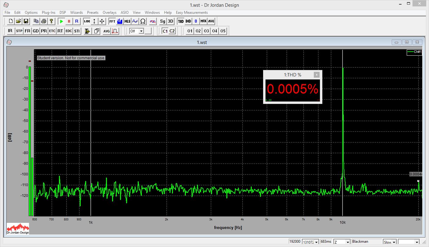

Spectrums

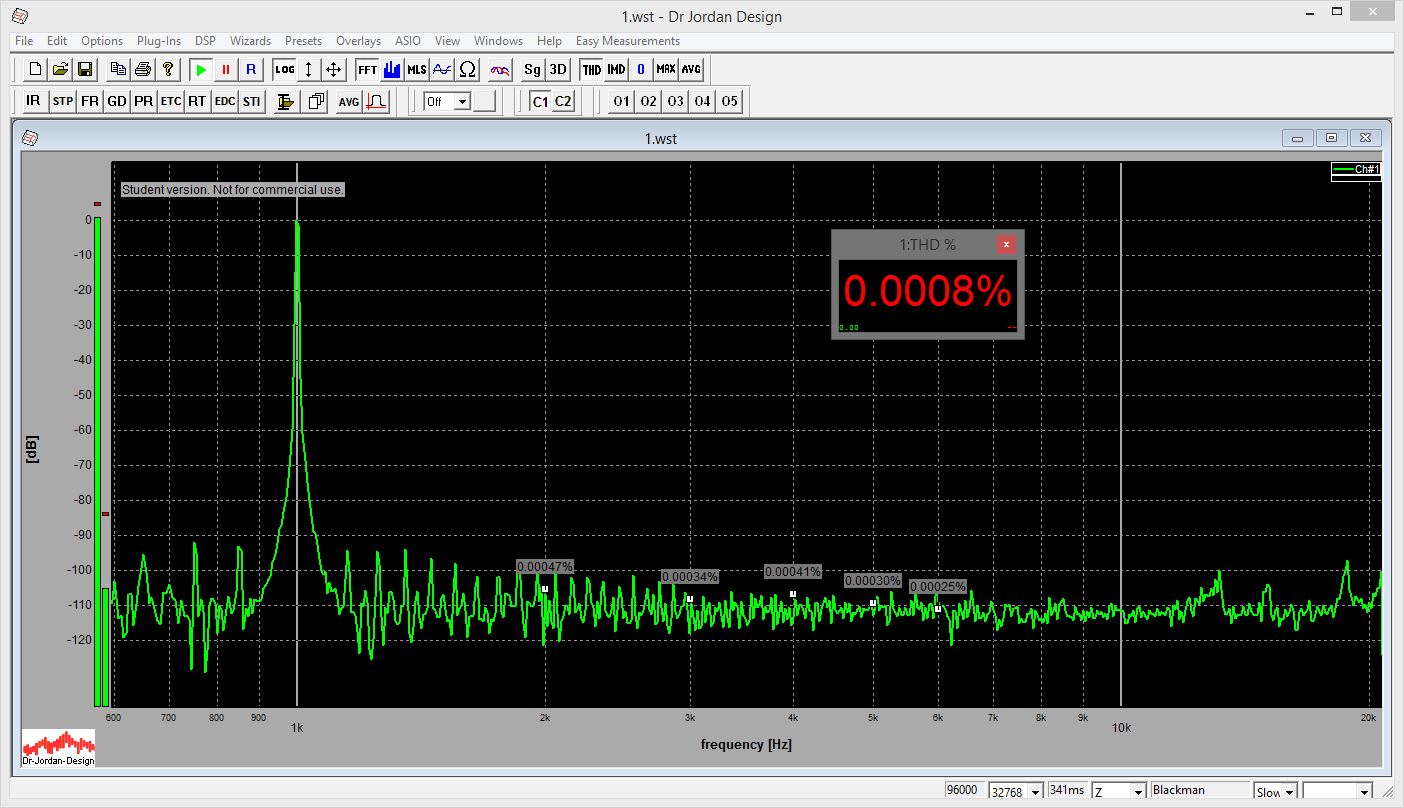

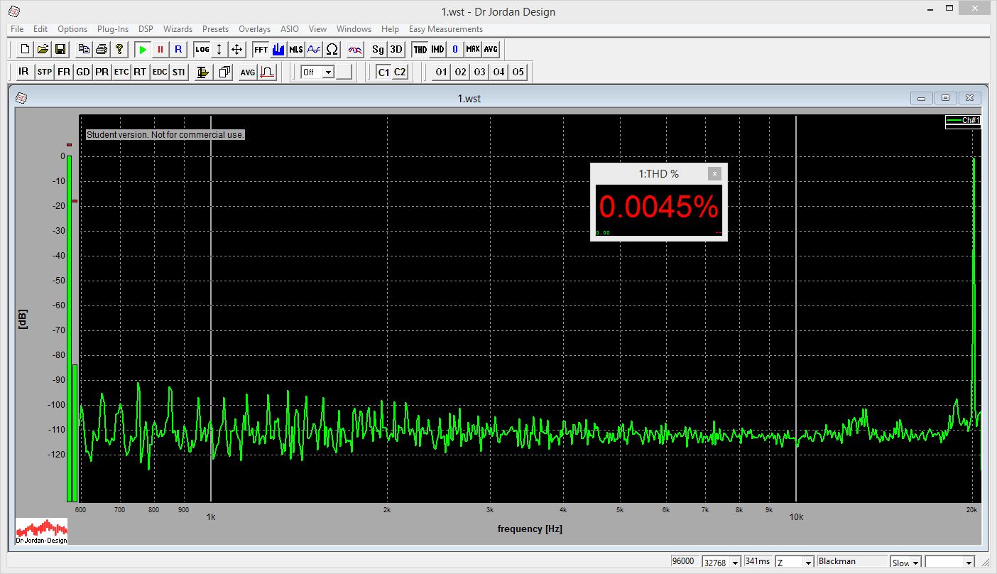

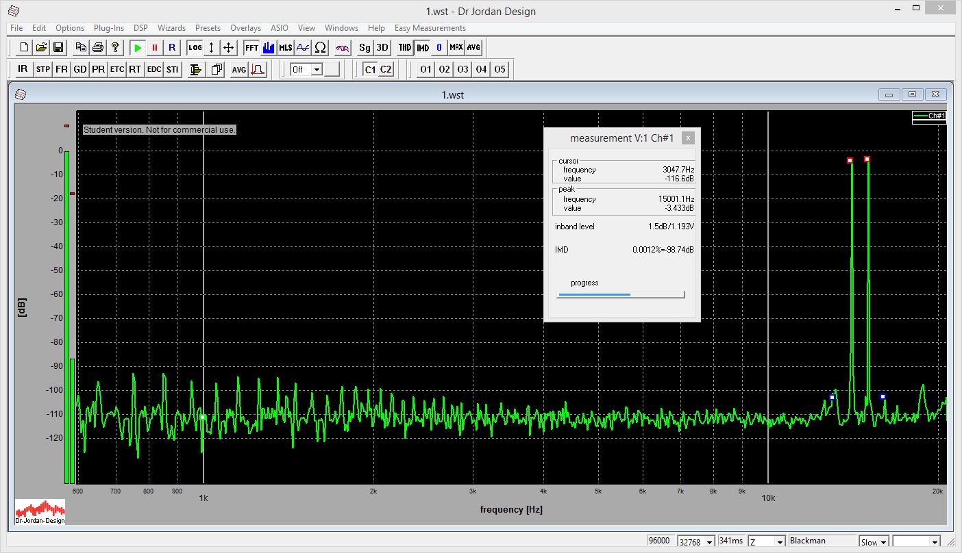

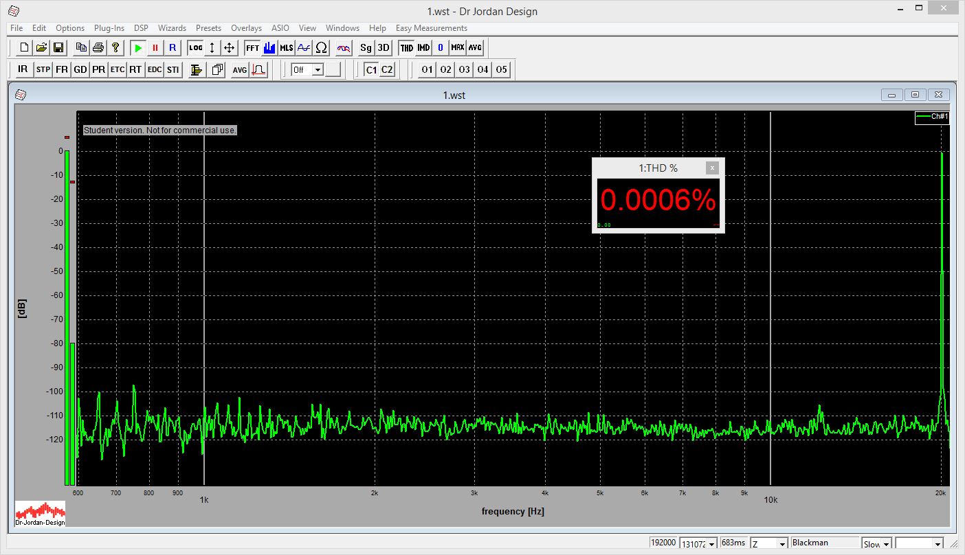

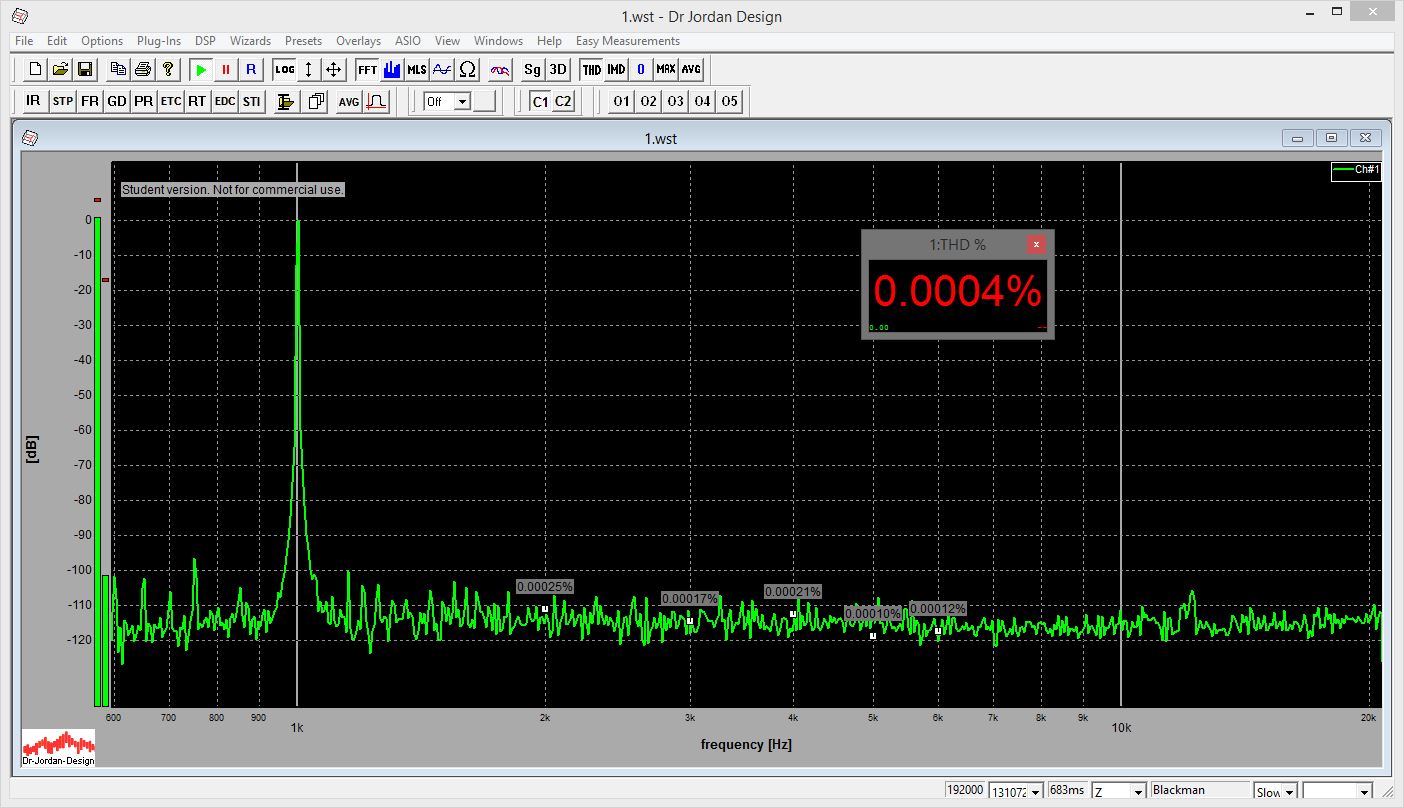

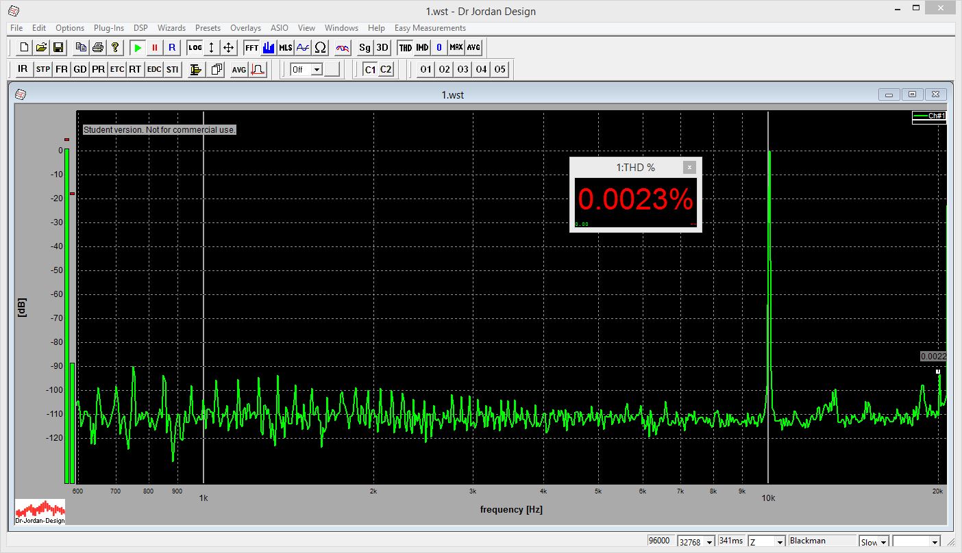

Here are the spectrums together with measurements in the following order:
1) THD 1KHz 4.2V RMS - NO OPS
2) THD 1KHz 4.2V RMS - with OPS
3) THD 10KHz 4.2V RMS - NO OPS
4) THD 10KHz 4.2V RMS - with OPS
5) THD 20KHz 4.2V RMS - NO OPS
6) THD 20KHz 4.2V RMS - with OPS
7) IMD 14KHz + 15 KHz 4V RMS - with OPS
Listening - delicious, high resolution, dynamic, natural sound. Excellent elastic low-distortion bass. In fact, very close to the other OPS with 3-5 pairs of IRFPs and EF drivers, based on SlewMonster - well, pretty much ensured by IPS.
Waiting for ksc1845/ksa992 transistors for testing the new IPS...
The new one has got extra 6db of loop gain, plus at least twice as much of VAS current. Will be interesting 😉
Valery

Couple of observations
Just listened to Pink Floyd's "Mama" (from "The Wall") at the volume, where I can confidently feel the bass with my stomach 🙂 Perfect! Ocean of sound, still with lots of micro-nuances and great instruments/voices separation.
Another observation - rock stable output pairs' quiescent current. After switching on, it goes up, then, within a minute, goes slightly down and settles at 90mA per pair. That's it. No fluctuations, that I can usually see in the designs with the spreader. Not even small ones. Amazing...
I like Lat-Fets more and more 😉
Don't blame the bias spreader, it is the laterals that don't need the spreader.
Still I suggest to use a spreader here too just don't thermally connect with the laterals, it is safer as bad trimmer contact will not provoke the bias current to jump high, JLH school.
Well, right, the reason is not a spreader, but more a thermal loop. Auto-regulation within Lat-Fets works much faster and tighter. Agree, spreader makes sense. Though, at the moment variable R is in the position, close to maximum resistance.
Hi Valery,
Looking very interesting! Do you think values will change in the OPS once the higher output IPS is attached? Also, did you need to match the outputs? I know on my ESP P101 it was highly recommended that the pairs be matched.
Thanks, Terry
Thanks, Terry
Hi Valery,
Thanks, Terry
Hi Terry,
No value change expected for IPSs with higher VAS current - R1 will allow to set the bias properly.
I did not do any matching - in this case you may have 2-nd harmonic a little bit higher than in case of matched ones, but a) with such a high loop gain, as we have here, difference will be rather low, and b) 2-nd harmonic is not "dangerous" for sonic impression, especially is its still at around -100db' level 😛
With higher VAS current, I expect THD20 to be even lower, than you can see now.
Valery
