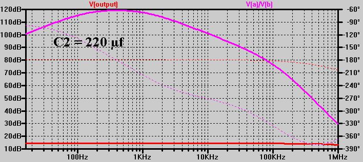

Hi!
Thanks for the reply!
You can assemble this head-amp with C2 47.0 µf , 100.0 UF, 220.0 µf or 470.0 µf, and it will not be wrong, will not lead to the loss of sound quality - as you can see in the image frequency response, the depth of the NFB still remain 88 dB at 16 Hz, at 47.0 µf, 100 dB at C2 220.0 µf, and 107 dB at 470/0 µf.
For Phono preamp required C2 1000,0 uf and more.
Thanks again for your opinion. This will help me to make the amplifier if not better, clearer. 🙂

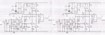

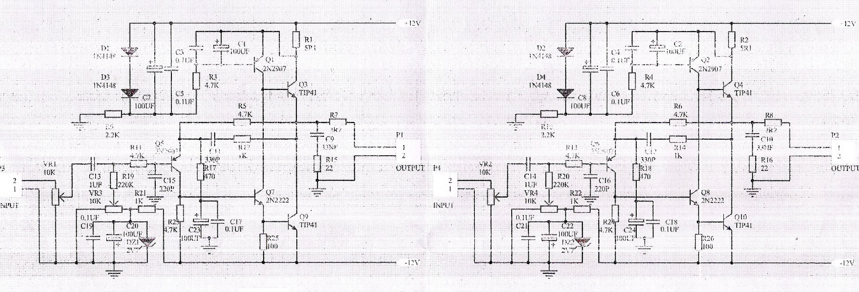

Hi T117,
These are the kits I've been ordering.
2016 NEW JLH HOOD1969 Class A Headphone Amplifier PRE AMP KIT DIY-in Headphone Amplifier from Consumer Electronics on Aliexpress.com | Alibaba Group
The schematic is posted below.
I lower the gain(by changing R17 I think) and add a DC servo to control the nasty DC offset at the outputs.
That's all.🙂

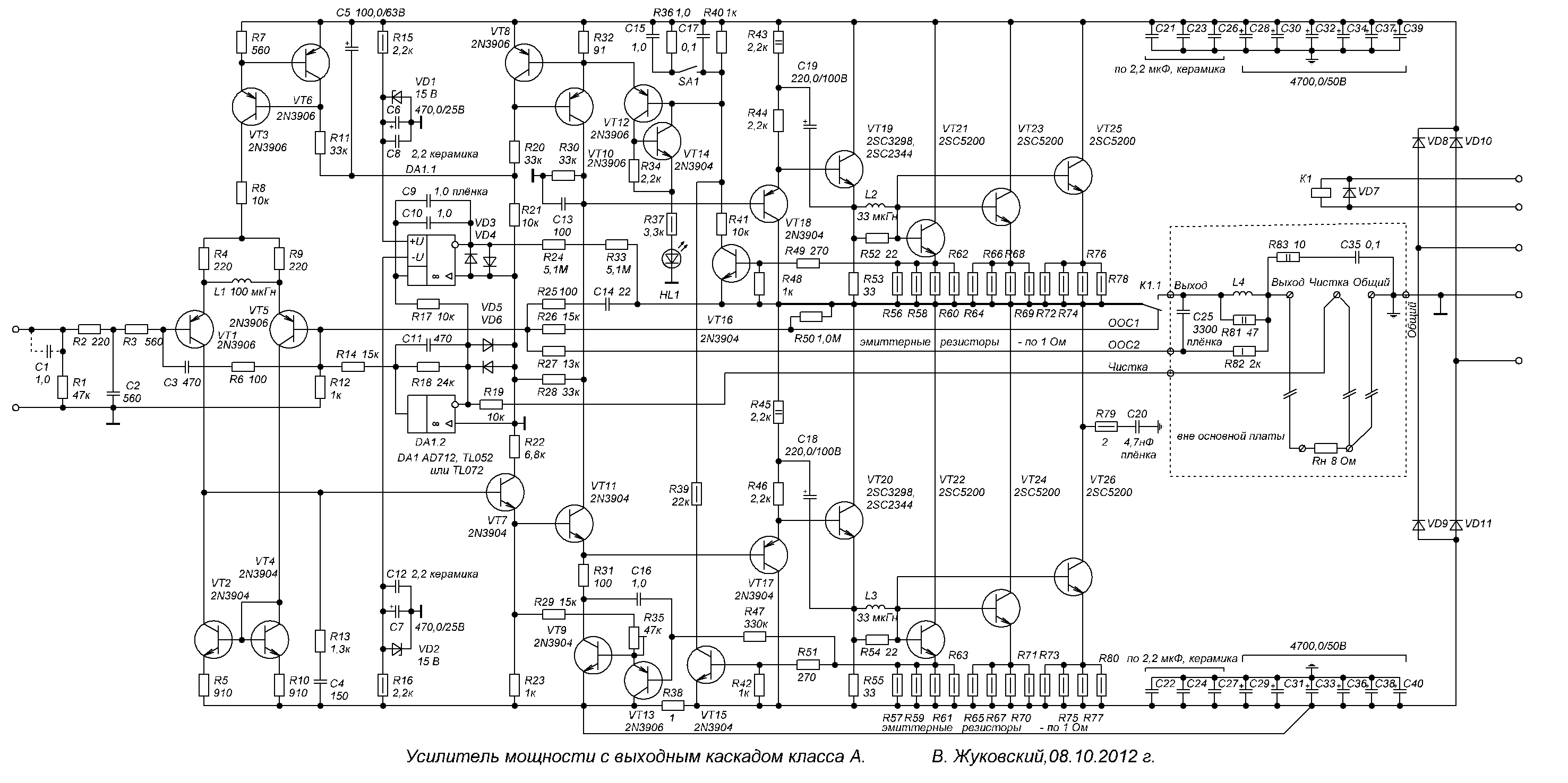

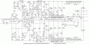

Thanks for the reply. Here is my version of this amplifier. Power output - 30 watts into 8 Ohms. THD - 0.000,1%. Supply voltage - 2х29 V.
For the sounds he was given the name "Lassie". It may seem complicated, but there's not a single superfluous component.
DA1.1 - integrator servo, DA1.2 - compensator resistance cables acoustics systems(the voltage drop across the resistance of the cable from the nonlinear current acoustics contributes to 0.2% needless distortion), VT9VT13 - idle current regulator output transistors, VT12VT14VT16 - current protection.

Nice design! I'm assuming it's Class A?
Yes. This is a modified JLH. 1.5 A for each transistor of the output stage.
A real stove. Can omelets frying. 🙂

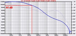

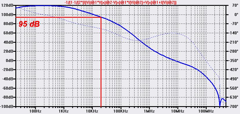

I by mistake put in the first post incorrect graph of Open Loop gain. Here is the correct graph.
http://s018.radikal.ru/i507/1611/e1/b441aa6033f1.jpg
