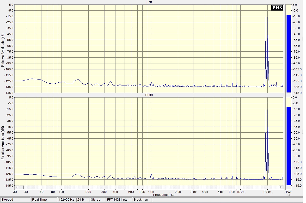

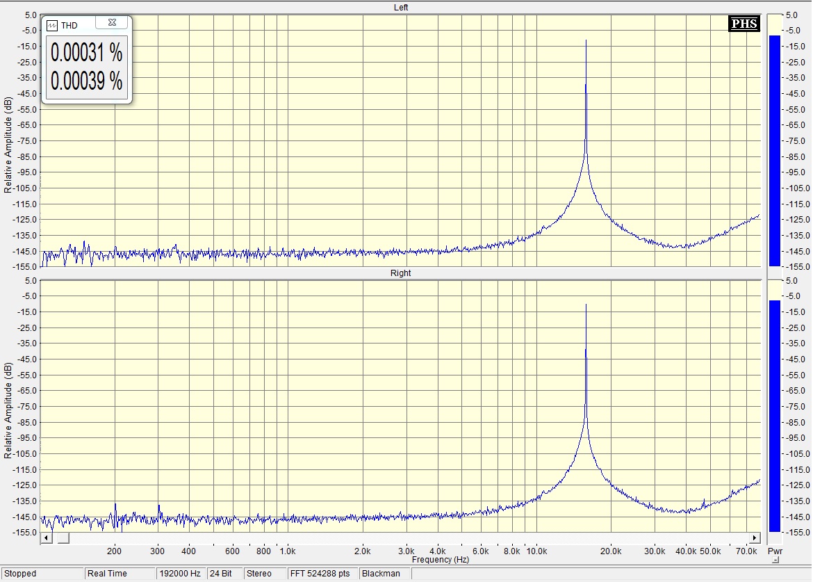

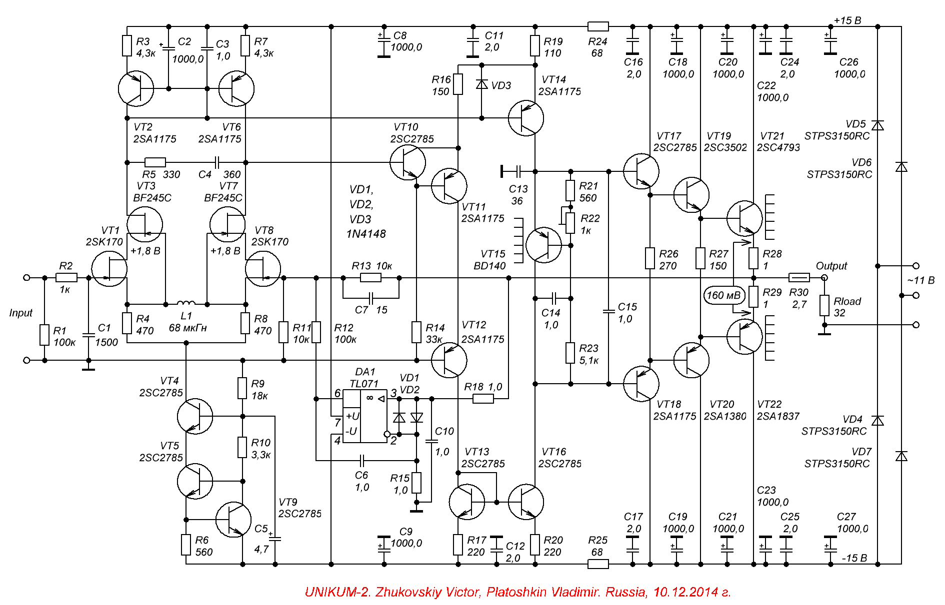

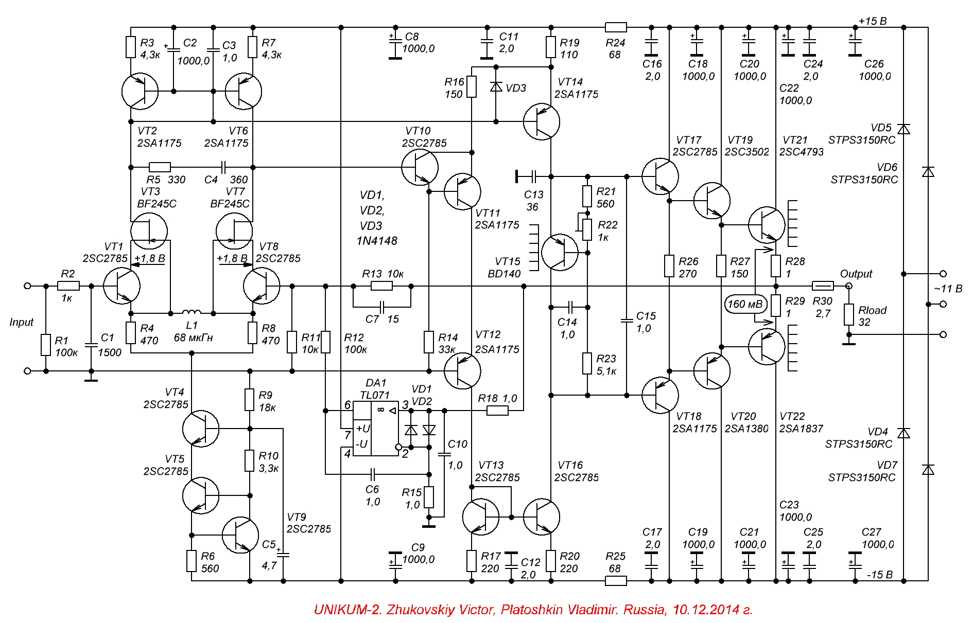

I design amplifiers high resolution with great depth of feedback. This is one of them.
The input stage VT1VT8 performed in a differential mode. VT3 VT7 is the source followers, and at the same time - stage with a common gate. This gives input cascade ability to work with almost no distortion from a signal source with high internal resistance, for example, directly from the volume control with a large output resistance.

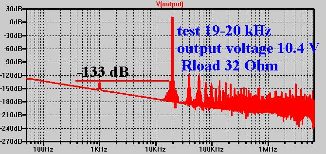

Not all amplifiers can do this without introducing distortion. The amplifier is tested typically by a signal generator with low output resistance, and shows good results, and how it works from sources with high output resistance remains unknown to the developer.
The input stage thanks to a high-impedance load VT6-VT10 has a gain of 80 dB at frequencies from 20 Hz to 1 kHz, and 50 dB at the frequency 20 kHz. Practically, it is a gain limit for these stages.
The feature of this cascade is that VT1VT8 can be either JFET or BJT without additional schema changes.
The second stage built on VТ14 under the scheme with a common base and dynamic load VТ16. VТ10-VТ11 drive this cascade through the resistor R16, and its dynamic load - through VТ12 and current mirror VТ13-VТ16.
Why is it so?
Cascade with CB, due to the lack of connection input and output using the Ccb the most stable against the generation of a cascade of voltage gain. A nice bonus is that the amplifiers with such cascades it is easy to provide frequency compensation.
The second cascade up to a frequency of 20 kHz gives a 60 dB gain. Both cascade together, the first and second, have a gain up to 140 dB at 1 kHz and 110 dB at the frequency 20 kHz. Therefore, the depth of the NFB - 120 dB from 20 Hz to 1 kHz and 95 dB at 20 kHz. Such a large depth feedback allows to obtain a very high linearity of the amplifier. The output stage is built on the good old scheme of three-stage emitter follower and operates in class A.
OpAmp DA1 is used in the service node for stabilization regimes of the amplifier. This OpAmp can not install.

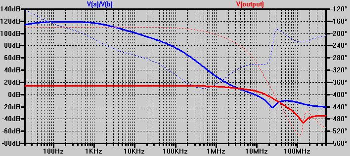

Hi, Nickolay!The loop gain looks kind of weird. Are you sure it works?
Yes, of course, this amp works. It is built in many exemplars, his scheme published in our journal, which is fairly competent editor Nikolai Sukhov. Not so hard to model it and work to make sure the advantages of such circuitry. A graph of loop gain you think it's strange because the amplifier is compensated for by the stability criteria of the Harry Nyquist.

No, that's not the reason.A graph of loop gain you think it's strange because the amplifier is compensated for by the stability criteria of the Harry Nyquist.

Just providing an email address to order your boards is pretty vague.
People would want to know the cost of the boards and whether they would need 2 boards or one board for 2 channels.

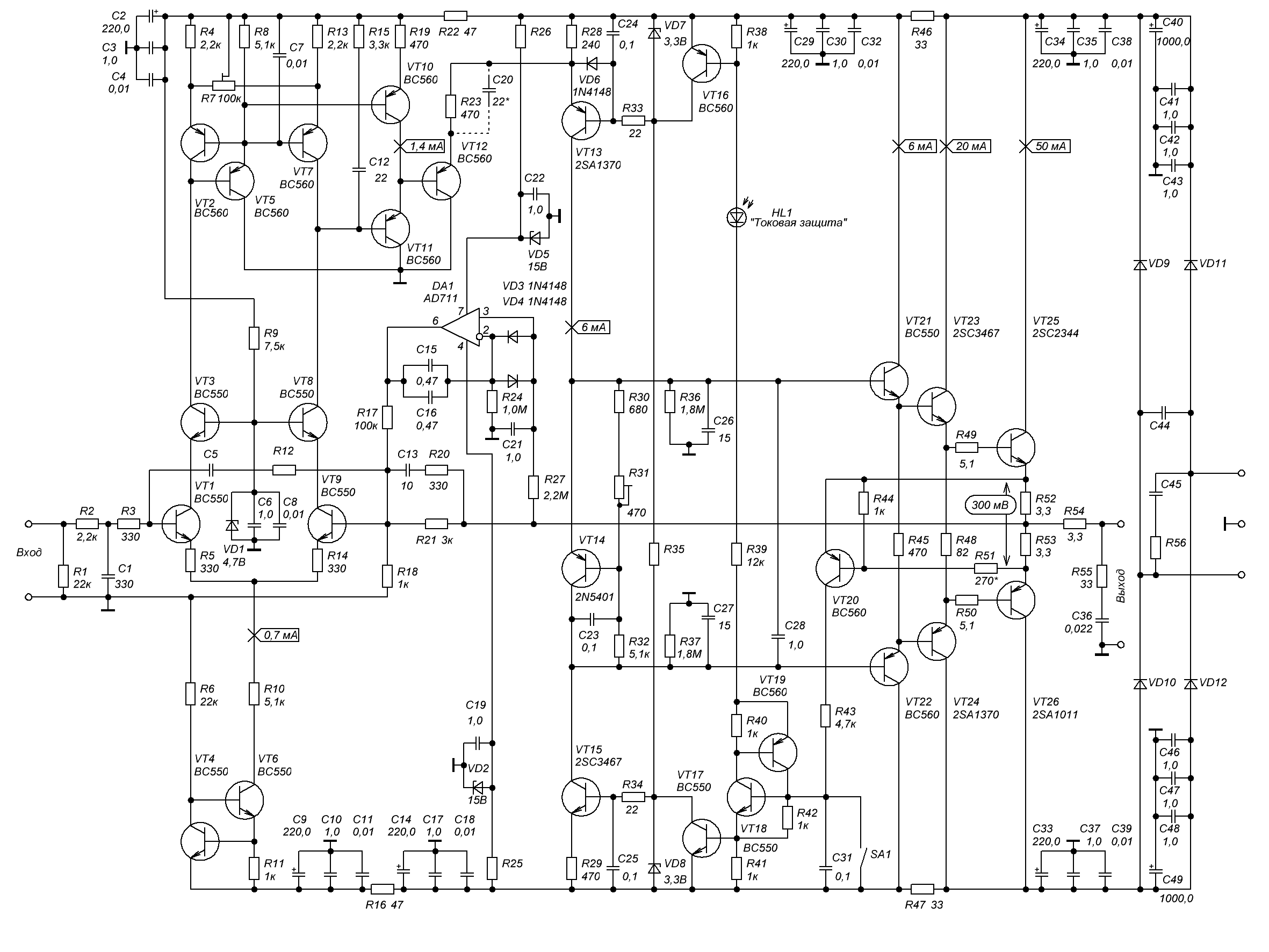

What's the deal with C20? Is it 22pF or 22uF and is it used in parallel with R23 or not? I see a dotted line connecting it to R23 in your schematic above.
What is the gain of the circuit and which 2 resistors set the gain?

Hi, ammel68!
Two channels of the amp need 2 of the Board + protection from DC (I always protect the headphones, which can be much more expensive, than the amplifier).
We denote microfarad with a comma for brevity: 1,0 = 1 µf, picofarad not designated: 220 = 220 pF, 5600 = 5600 pF. Similarly, the megohms indicated by the comma: 1,0 = 1 MOhms, and ohms is not indicated: 47 = 47 Ohms.

This question relates to which of the diagram? According to my diagrams at the beginning of the topic, C20 - 1000,0.What's the deal with C20? Is it 22pF or 22uF and is it used in parallel with R23 or not? I see a dotted line connecting it to R23 in your schematic above.
Gain amplifier - 2 times. This gain is set by resistors R13 and R11. If for high impedance headphone will need more voltage output and need more gain, reduce the resistance of R11 unchanged in the circuit.What is the gain of the circuit and which 2 resistors set the gain?

T117, thank you for answering my questions. I did receive a PM from Alexandr about the boards.
Looking at your diagram in your first post, what is the purpose of L1 and what value is it?
Is it a through-hole inductor you can purchase or does it have to be wound from insulated wire?

Please.T117, thank you for answering my questions.
I was interested in how much gain can give two cascades VAS, and how deep the NFB can be obtained. As can be seen from the graph, the audio frequency range in such a simple amplifier can be quite easy to obtain the depth NFB 120...95 dB.Looking at your diagram in your first post, what is the purpose of L1 and what value is it?
But the band steps NFB is limited to 10 MHz. If I would use standard Miller compensation with a decline rate of 20 dB/decade, from frequencies 1 kHz to 10 MHz only 4 decades, and would have to sacrifice the depth of NFB, displacing the first pole lower in frequency. Therefore, it was necessary to use three-pole frequency compensation with a plot twice more rapid decline in frequency response from 100 kHz to 1 MHz.
The inductor L1 100 uH together with R4 and R8 forms the third pole of the frequency response at the frequency of 1.5 MHz, because these elements create a local NFB in the input stage.
I bought this inductor. It is better to use inductors with a closed magnetic system to avoid electromagnetic interference: toroids or pot-core type.Is it a through-hole inductor you can purchase or does it have to be wound from insulated wire?
Just found here are matching transistors. Model in LTspice IV contain 2N3904 and 2N3906, so you can build an amplifier with them.The 2SC2785/A1175 aren't easy to find here in the U.S.. Are these transistors common in your country?
