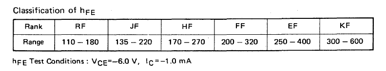

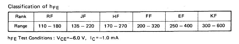

As for the A1175/C2785 NEC transistors, I see there are different grades or Hfe values.
The most common grades I see for sell are "E" and "F" grades, assuming the first letter after the part no. is indeed the grade.
I have already ordered some "F" grade A1175 transistors. Can I use the "E" grade C2785 with the "F" grade A1175's without issues?

I'm not focused on when designing the Hfe. On the contrary, it is because this parameter has large variations, and is changing, for example, the temperature, must rely on Vbe. Vbe is approximately equal even for different types of transistors. That's why I said that it is possible to apply at least BC550/560, though 3904/3906, or any other transistors, similar to the marginal frequency current amplification.

The General rule is that transistors with high Hfe should be set in the input stages (to reduce input currents) and followers (to increase their input resistance). The output stage VAS can work with the transistors with low Hfe. Buddy who built a lot of amps are advised to apply at the input BF862 and MMBF4391: the first in the input differential stage, the second - higher, in the cascade tracking. They have a fairly high degree matched. But they have SMD cases.So, at this point I'm going to assume that I can mix E grade C2785 and F grade A1175's since you stated the Vbe is approximately equal for different types of transistors.
I'll say it clearer: in this amplifier, you can set the NPN and PNP transistors with different Hfe. Deep negative feedback will correct the small non-linearity from the use of transistors with different Hfe in the output stage and the VAS. Moreover, the classes F and E do not differ much in Hfe.

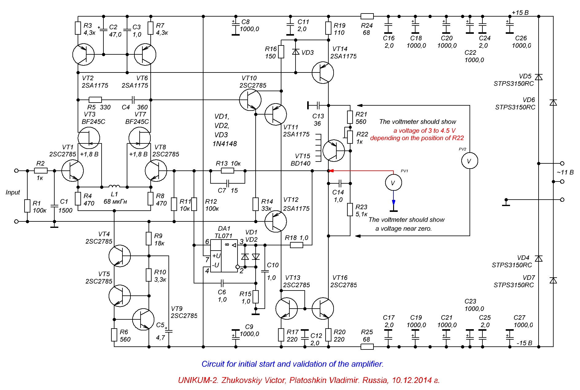

The biggest mistake that you can make novice hams - after the construction to enable full amplifier circuit. Mounting the amplifier can have bugs, and its launch could end sadly. It is therefore important to test the amp in stages.
For the first run of the amplifier cascades the output of the follower is not mounted. These stages are very powerful, can take high current, and his refusal may lead to serious consequences..
The most important cascade, that specifies the modes of the amplifier - VAS. Its elements are mounted at first, and it is first checked after assembly on the absence of errors.
Circuit for the initial start-up are shown below. It is necessary to perform two measurements:
1 - the voltage at the output of the amplifier relative to ground,
2 - voltage on the transistor VT15 thermostatic output stage follower.
If the measurements do not correspond to the shown values, it is necessary to look for errors. If they correspond to these values, you can proceed to build the output stage follower.
During the operation, check the possible mistakes can lead to burnout relatively cheap resistors R16, R17, R19, R20, R24, R25.
Such preliminary checking may be useful when building any other amp, in another schematic.
After checking and assembly output follower stage, the slider of the resistor R22 must be installed in the upper position on the scheme. This corresponds to the smallest idle current of the output stage follower. Full test of the amplifier need to start with a minimum idle current. Then this current can be increased by rotating the slider R22. If the minimum current is too large, it is necessary to increase the resistance of R21.
