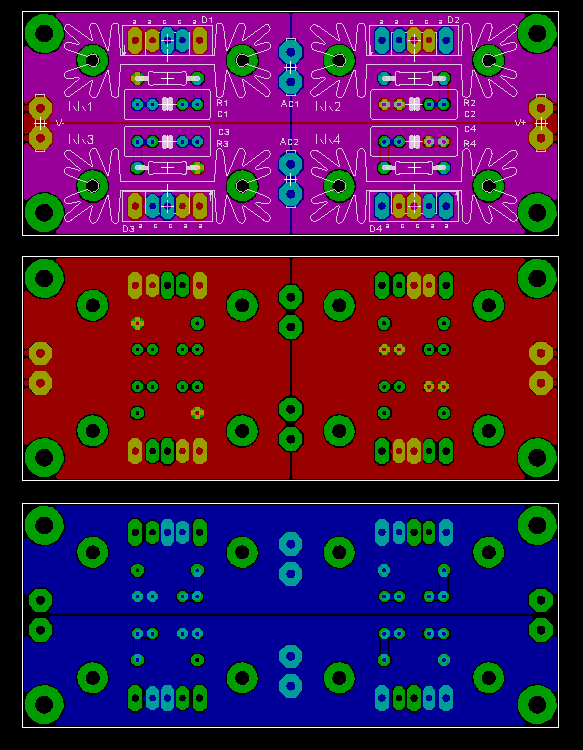

I hadn't thought about it before but yes, you can use pretty much any TO-247 common cathode dual diode, as well as all two leg TO-220 devices. The only thing that you may have a problem with is mounting the TO-220 devices as they will be slightlyoff centre on the sink.
Scott Nixon put a couple of holes on on each side of a cap in his DACKit. Thus you could use 5mm, 7.5mm or 10mm (ISTR) lead pitch on the component.
Would it be possible to drill another couple of holes to centre the 2 leg TO-220 on the sinks??

Also, I should have the final board layout done this afternoon, and I will post it up here when I have it finished.
http://cgi.ebay.com/ws/eBayISAPI.dll?ViewItem&category=7287&item=2596844068
Right, I have now finished what will hopefully be the final version of the rectifier board, with as many of the requested features added as possible.
I have added the option of the different leg spacing for the capacitor, with 0.2, 0.3, 0.4 inch pitches possible (2.54, 5.08, 7.62 and 10.16 mm respectively), so most people should be able to fit their capacitor of choice onto the board.
Also, for those of you out there who would prefer to use the TO-220 two leged type diode (like the MUR 1520, or MUR860's), I have added an extra set of pin holes, that will allow you to mount the diodes and still have them sit centraly on the heatsinks.
If there is anything that people still think is missing let me know, but hopefully this should now be flexible enough for most peoples needs and we can get a few more people interested in the board group buy to see if we can get enough orders to drop the unit price down a bit more.
Andrew.
Andrew.

I'm not too sure on the pricing as yet, as I have only had one quote back yet. But, with them, if we managed to hit about 500 boards, the price would drop down to around £3.00, or perhaps a little under depending on postage costs for that many boards from the manufacturers.
I just looked at your Specification page, I hope you mean 55um copper not 0.55um! I would definately prefer 70um if possible.
oops, that's what happens when you keep going to lectures about integrated semiconductors and photonic devices. But it should be fixed now.
As for the final thickness it all depends on the people who final make the boards, what they can do, and how much it will effect the price one way or another.
OK, I have had another quote back now ofr producing the boards, but it looks like this plae will offer slightly better prices than the first couple of quotes I had back.
If we can hit about 200 boards, the price should drop down to £3.50 (per board as the initial cost for the photo plots is being spread out more.
However, if we can make it all the way up to around 500 boards, the price would drop down to a far more user friendy £2.50 per board, as we would get a discount on the cost of the boards at that point.
It also looks like I will be able to include the four terminal lugs required for each board, as they will only be a couple of pence each and there are enough orders to justify buying the large size bags they come in.

The version that I had in mind measures 50.8mm in length, has pins so that it can be soldered onto the board, a thermal resistance of 9 deg/W and will fit both TO-220 and TO247 devices.
If you do want to try and find a cheep source of these, bare in mind that at the moment, for quantities abouve 100 (only 25 actual boards), these can be had (without postage cost as I can pick them up from the shop) for 92p each from maplins.
