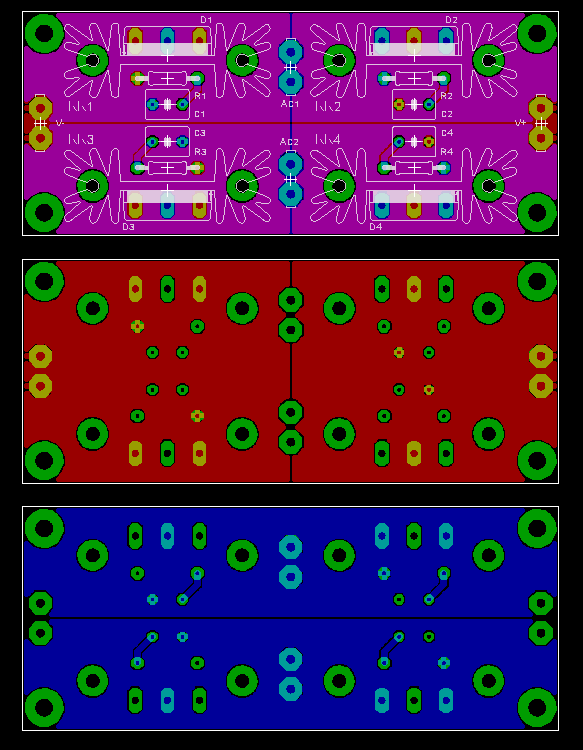

Ultra Fast Diode Bridge.
Ok, here is a new updatd version of the board, with back to back diodes for Rod, and improved contact areas around the diode legs and terminal points. If people have any further requests or sugestions let me know and I might even change this again.
Andrew.
Edit: Rod, does it matter to you that there are components between the diodes at all? as it may be possible to move these if the space needed to be clear between them.
No. The diodes being close to the edge of the board will allow me to bend the lead so the diode is off the surface of the board, or I can mount them upright and mount them to 2 separate heatsinks. This design is much more flexible. I will probably mount the diodes on the opposite side from the cap and resistor which will keep the heat away from them. That would make plate through holes a plus.😀

BP,
Since your going to wait a little bit, I have one other critique. If you could add another set of hole for the cap just outboard of the current ones. The resistor is fine. The leads are always long enough, but the box caps can be a PIA if the lead spacing is different. 1mm in both directions will give us 3 different possibilities.
The other item is non-technical. Have you thought about how you're going to take orders and how you will accept payment? I use PayPal with my Cardas Bulk Purchase and it works great. I will ultimately insist on emails for an official order with quanties, shipping information, and payment method.
Hi, I'm sure I can sort out the Capacitor thing, I should have a bit of free time tomorrow night if I don't end up down the Pub so I'll try and get it sorted then (Hopefuly, I should be able to set it to 0.2, 0.3 and 0.4 inch pitches?).
