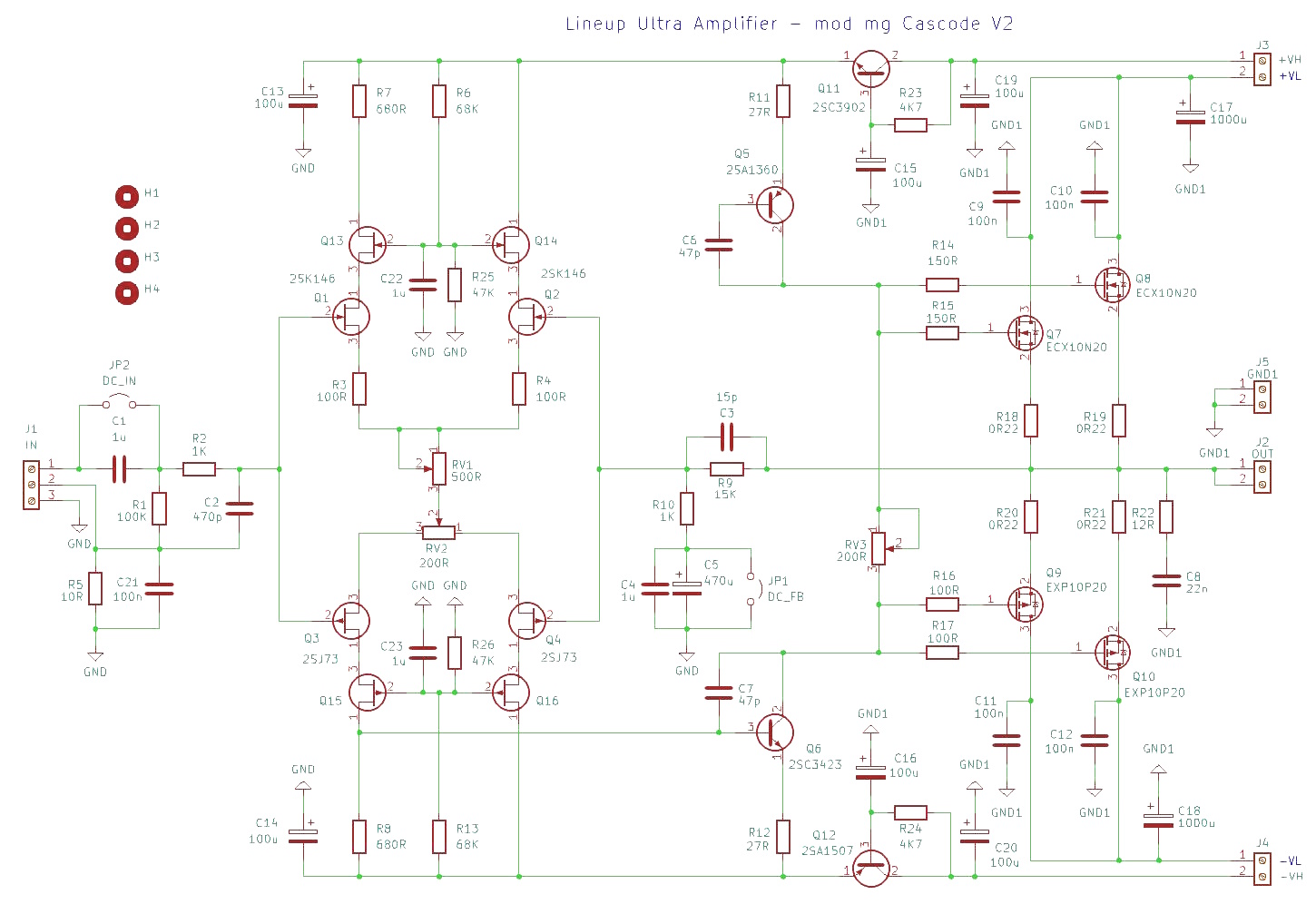

If the emitter on VAS transistor is not on the same voltage rail as the VAS base, then you're basically amplifying noise/ripple on it's power rail, which could include clipping it, creating chaos.... Remember to add the capacitor ripple to simulations.... And what happens at power up, driving that high current though the VAS transistors....Nico and soekris:
To clarify, the VAS and input is on separate regulated supply. Is it still neccessary to put VAS inside cap multipier?
I don't know who added that noise filters, the original schematics did't have them....
Drivers negates the mosfets ciss, reducing THD at higher frequencies.... Try simulating at 20 Khz....
Feeding the VAS/Driver stage higher voltage than the output mosfets is a good thing, giving higher output power....
Hi Søren! I don't know how to comment on this, my knowledge is not up to it. Do you mean that the VAS acts as a common base amplifier for the (possible) noise that may be present at the VAS emitter?

Is this a better approach?If the emitter on VAS transistor is not on the same voltage rail as the VAS base, then you're basically amplifying noise/ripple on it's power rail, which could include clipping it, creating chaos.... Remember to add the capacitor ripple to simulations.... And what happens at power up, driving that high current though the VAS transistors....
Thank you, I am becoming blind now!Q5 base to Q13 drain.

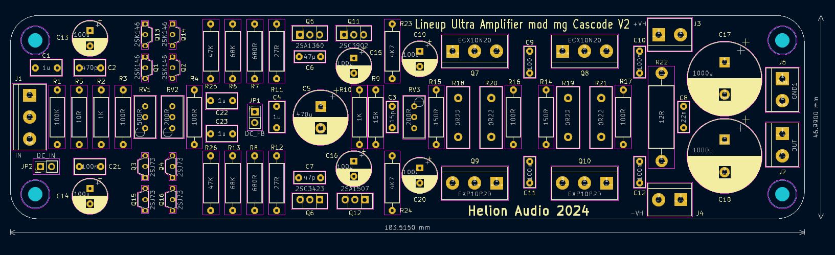

PCB updated, no errors
Should not the Q7-Q10 placed on the pcb other way turned around to fast them to the heatsink? If I would make now a pcb then I would add SMD option for JFET-s and some SMD resistors. 2SK146 and 2SJ73 are hard to get and would be good to have a some substitute options and footprints for these JFET-s.
I find it interesting that you included a ground in J1, On the other hand someone may want a separate ground on a double screened cable. The PCB still remains one of the nicer ones I have seen.
I would say it is time to stop making changes else you will never end.
I thought the same thing. But if you think about how you insert them before bending, the footprint is correctShould not the Q7-Q10 placed on the pcb other way turned around to fast them to the heatsink?
I think that right now the back of the mosfet is turned on inside the pcb. I can not figure out how to fasten then to the heatsink. If the back of the mosfet would be turned to the outside then I can bend it to fasten to the heatsink. Maybe someone else can confirm it?I thought the same thing. But if you think about how you insert them before bending, the footprint is correct
