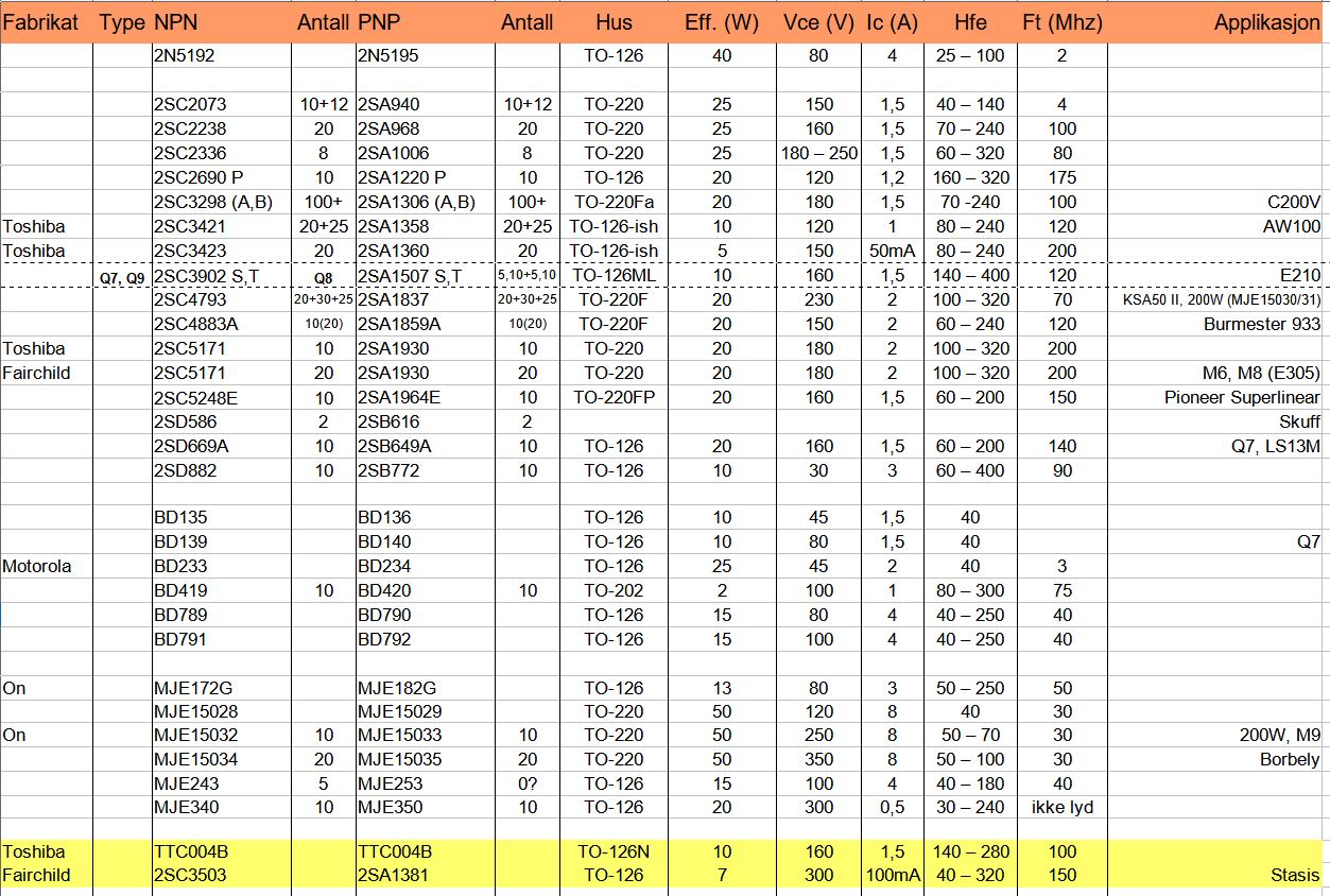

The original transistor are not in my drawer, but maybe you could suggest other alternatives? I have a reasonable amount of "older" transistors...

If you use those, might want to reassess compensation. With their higher Cob, I assumed that the compensation caps could be lowered. I don't have simulation models for those devices, otherwise I'd give it a shot.
Generally speaking, low Cob is preferred for the VAS. This is why @lineup and me both focused on SC3503/SA1381. These about the lowest Cob TO-126 devices available. But even now the last source of these (Onsemi) are going EOL. TTC004B/TTA004B are probably the next best alternative.

Thanks for sharing! I have neither of those, but here is a list of what I could use. Would you give it a glance to see if there are any good (or at least better) candidates for the VAS?The parts bin - That makes sense.

2SC3503E / 2SA1381E would probably be the best. I see you have 2SC3423 / 2SA1360 listed - those would also be very good depending on what VAS current you plan to run (due to their 50mA limit).
I'm not familiar with many of the others. I entered this hobby after the "golden age" of through-hole components.
The VAS current according to rule of thumb, I do not remember who's thumb, should be about 10 mA. (I remember John Curl or maybe Bob Cordell in a thread about 10 or so years ago, I adopted that stance and it lived with me ever since) I guess it was for a normal home amp not running 24 transistors and 1500 watt output in class A!

If the 50mA 2SC3423/2SA1360 is adeqaute, I will use those.2SC3503E / 2SA1381E would probably be the best. I see you have 2SC3423 / 2SA1360 listed - those would also be very good depending on what VAS current you plan to run (due to their 50mA limit).
