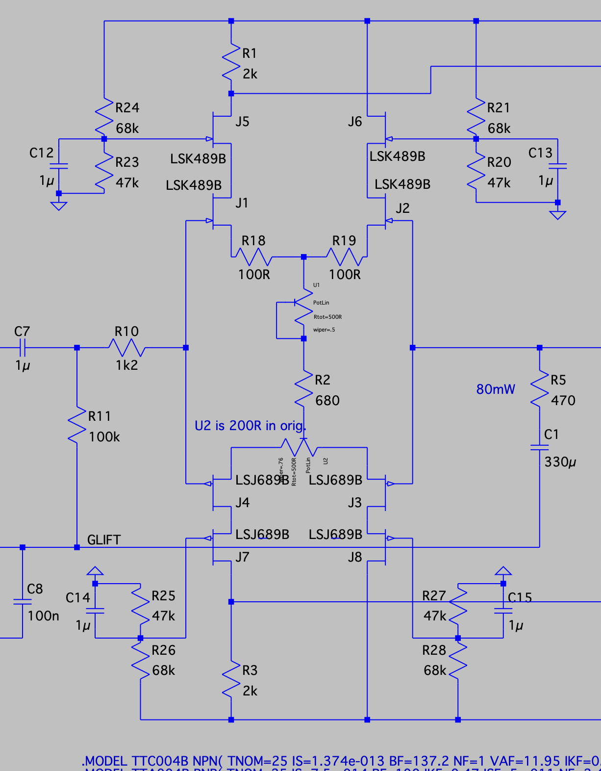

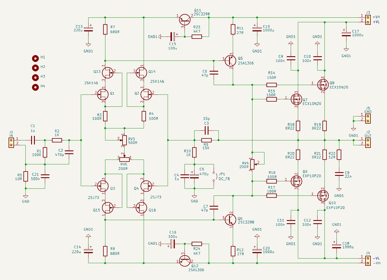

Just a suggestion by Nico to cope with the 25V devices I want to use. I'd rather be without them, hehe
The cascode discussion is for using JFETs other than LSK489 / LSJ689. These have 50V ratings were other JFETs are often around 25V. A cascode mitigates this.
In my Spice experiments, the voltage drop on one of the FETs in above scheme is 95%. With my very limited understanding, I can only imagine, the above usage of multiple JFETs as a diff purpose.Not quite sure what you mean, but I found some designs by Borbely, amongst others, that looked promising (read Simple).

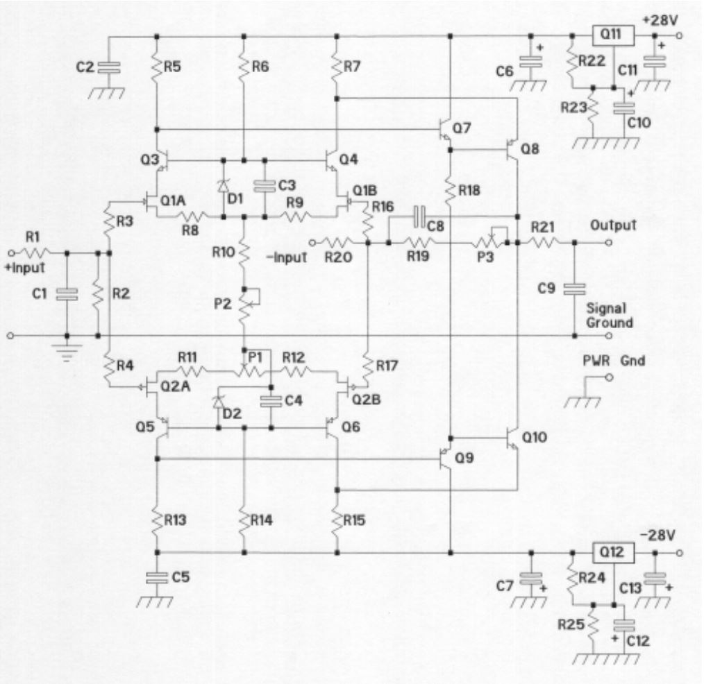

So here is one of Borbely's RIAAs followed by my copy-paste attempt.
Borbely RIAA
Could it be this easy?
Looking at examples for JFET cascodes, I was able to get a well working circuit, in which the voltage is distributed across both JFETs as desired (well, you need to adjust the resistors building the voltage divider to really get 50/50). Since this is just looking at examples and trial-and-error, I might have gotten something wrong.
In Spice it works fine, though.
I have just used the JFETs of the original design to minimize effort. I expect this works similarly with 2SK146 and 2SJ73.
Thanks! Looks fine, but is it necessary to have separate bias for the cascode FETs? Here are a couple of example using BPs, but that shouldn't matter, I believe.
And another Borbely
I am in doubt about the Borbely variant. It looks like the cascode bias shares current with the FETs, so the some calculation is needed. Not for me.
The first one is similar to what you suggest, if the cap is added. Is that right?

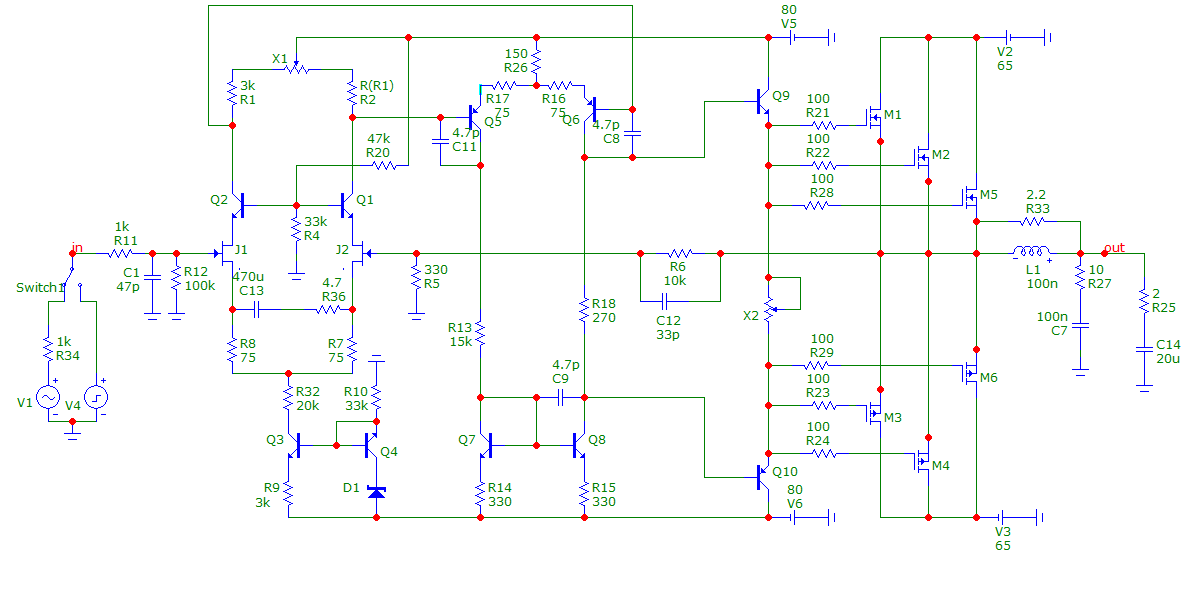

And another Borbely
If using FET for the cascode has advantages over BP, I will gladly use FETs. In addition it looks rather serious with those vintage aluminium cans! 😎
No, it was just late and LTSpice, while being a really great tool, has a bad UI and I was too lazy to combine after I had it.but is it necessary to have separate bias for the cascode FETs?

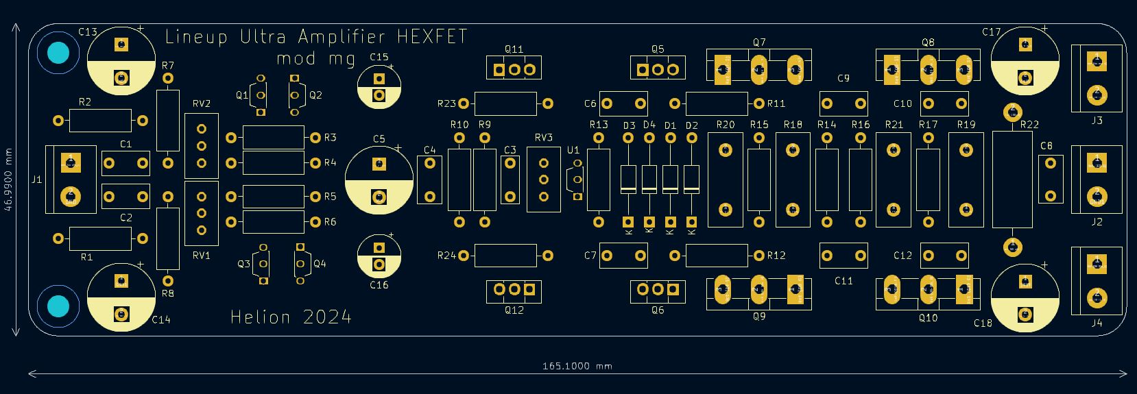

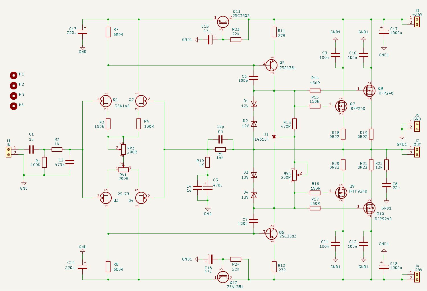

Yesterday I finished PCB for the IRF version by lineup.

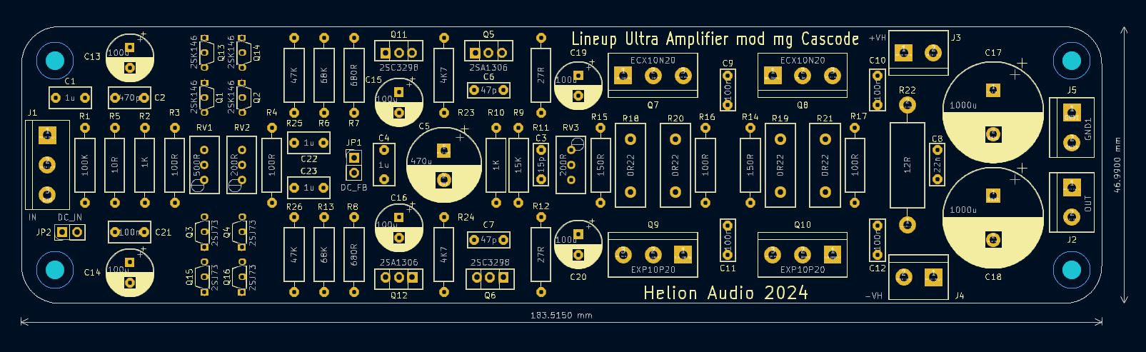

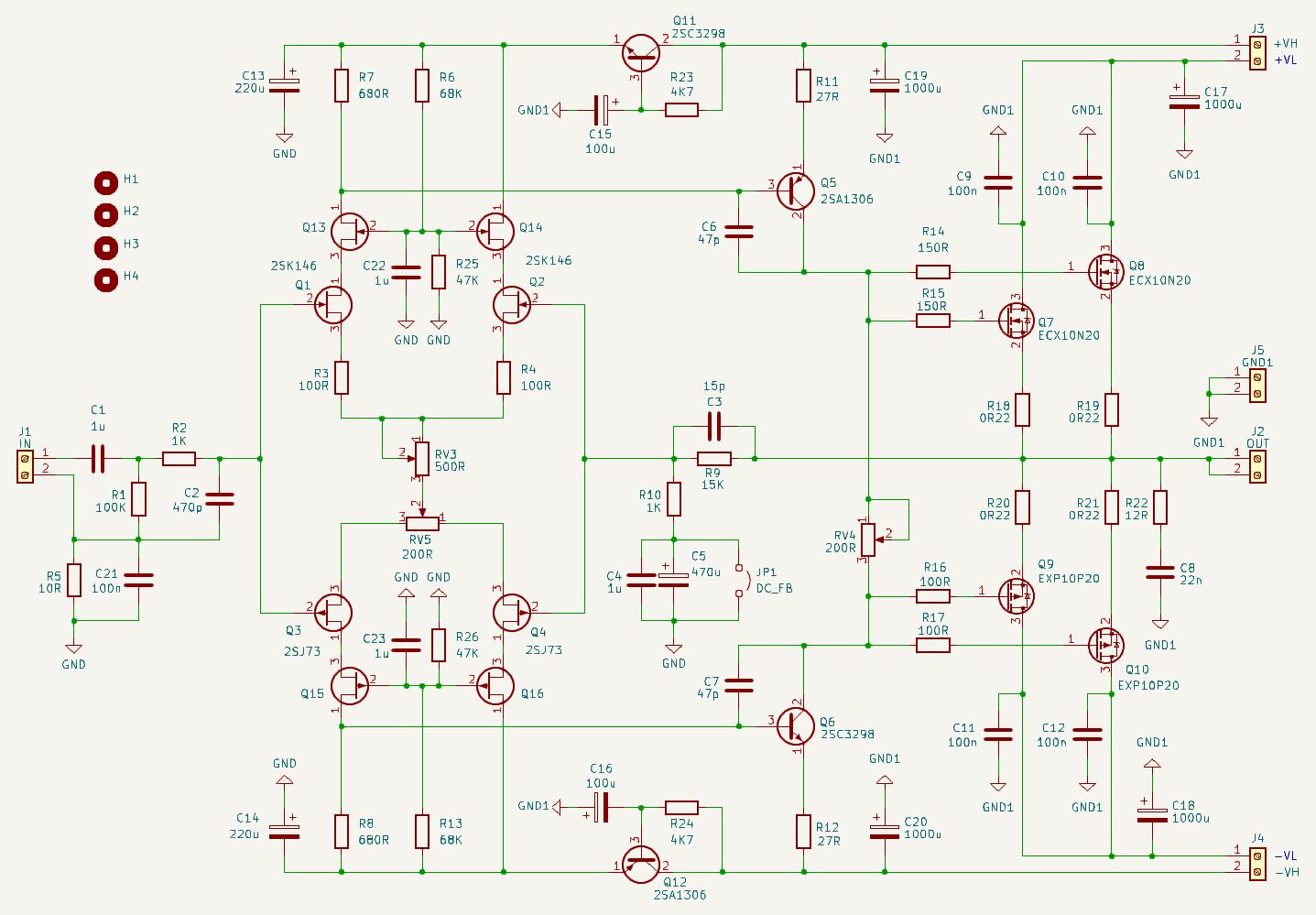

I think I'll go for a PCB for this cascode version.
A lot of people choose to small an input capacitor, not realizing the the preceding equipment may come with a capacitor in the output. The two caps in series may impair the bass response without even realizing it.
Here is what I have so far. Corrected missing GND on input connector. Added Groundplane for input GND. Added AC/DC select jumper on input.
Made space for screw terminals on MOSFETs in case I want to use TO-3 Exicons. Placed VAS transistors on PCB edge in case someone tells med they need cooling... Don't think cap multipliers need cooling, though.
Any thoughts?
Any thoughts?
About 100 yesra ago my first real job was at NDRE (Norwegian Defense Research Establishment,.. puh!) where I started making PCBs. My supervisor told me that "first it has to be nice, then it has to work". I guess it stuck. But I have no expertise in audio layout, as all my work back then was more or less digital designs. So "star grounds" and and other rule-of-thumbs. I am bad at those. Usually the 2-3 last routes don't make me proud! At least it looks good.

I don't understand the question. The terminalblocks will accommodate plasitc FETs the normal way. The blocks are supposed to be place on top side of PCB.I would give two likes if I could. Are PCBs your job or are you just naturally good at it? Just one question, when folding the power fets outward can you get to the screw because I assume they are under the PCB

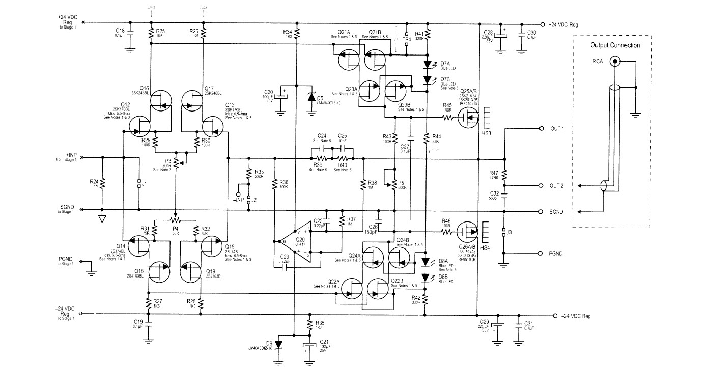

- Ultra Amplifier with JFET input and Lateral MOSFET out
