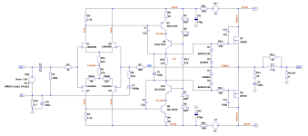

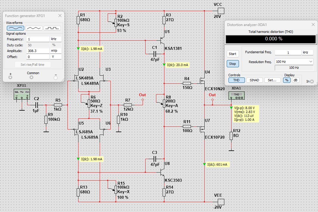

I like the simplicity of this design. But have been tinkering in sims with variations on it. Cascoding of the JFETs is one of them, as you suggested. The main benefit here (from my perspective) is to run at higher voltages for more output. I was envisioning a 2 pair design with the OPS running at 49V to 56V.
Regarding the VAS Cascode, I attached a pic of my quick sim. I image Q5 and Q6 could be replaced with TO-92 devices and R14 could be a current regulating diode. I also did not do a loop gain analysis. Not sure if C3 and C4 would need adjusting.
Question for the experts - since my version uses boosted IPS-VAS rails, would the cascode benefit for a higher reference voltage? I could always increase the V2 boost to allow for a higher voltage without sacrificing output potential.

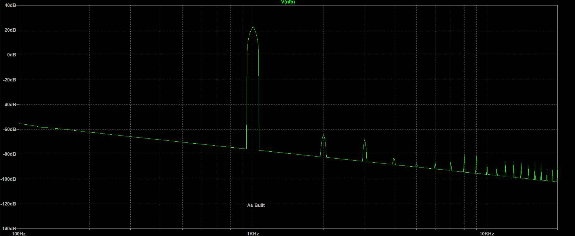

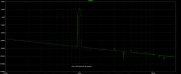

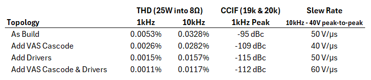

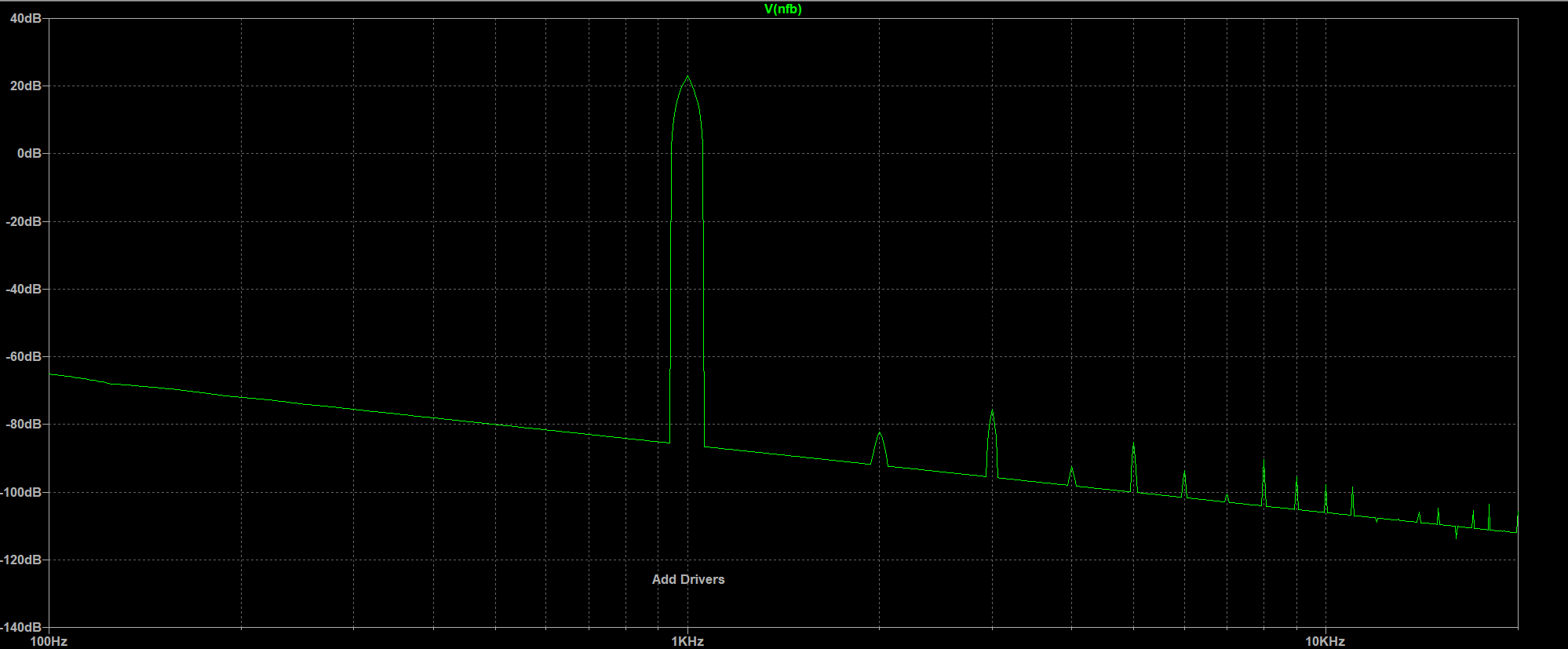

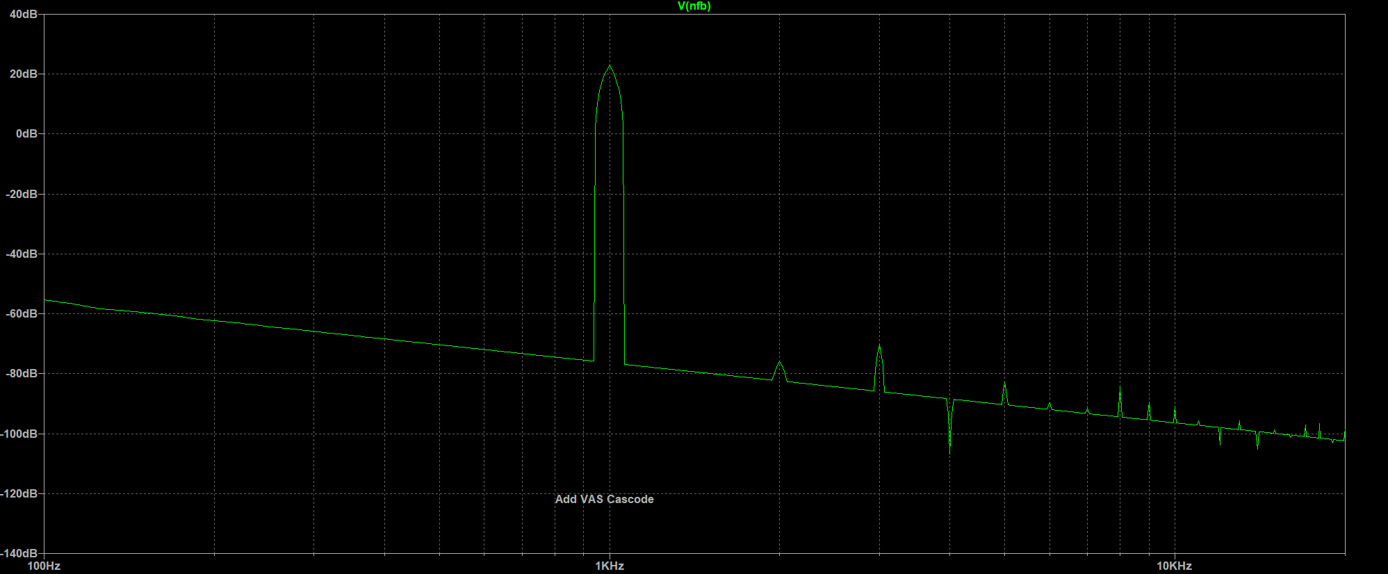

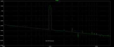

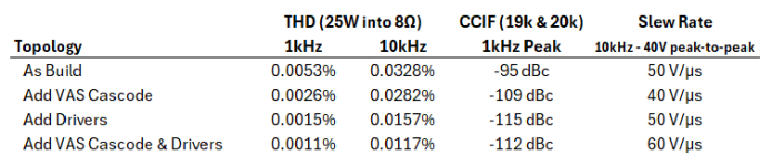

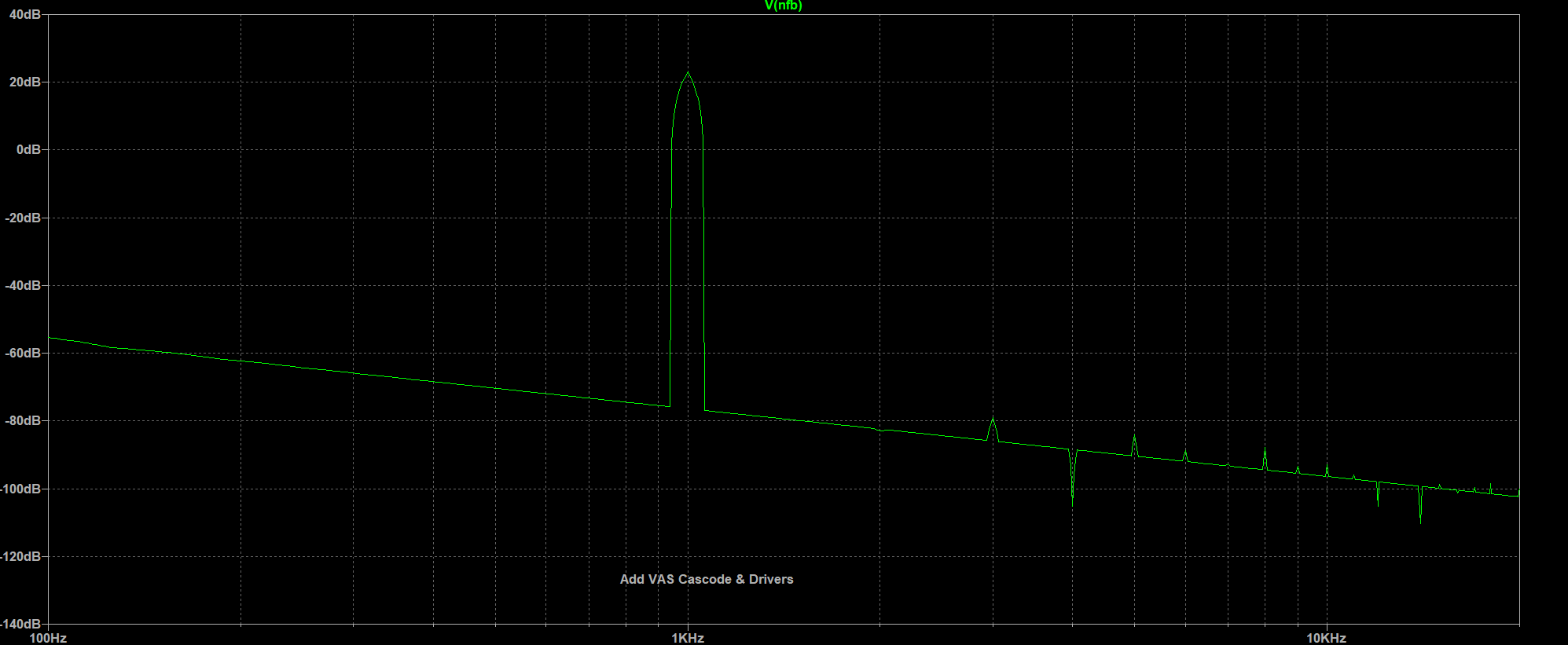

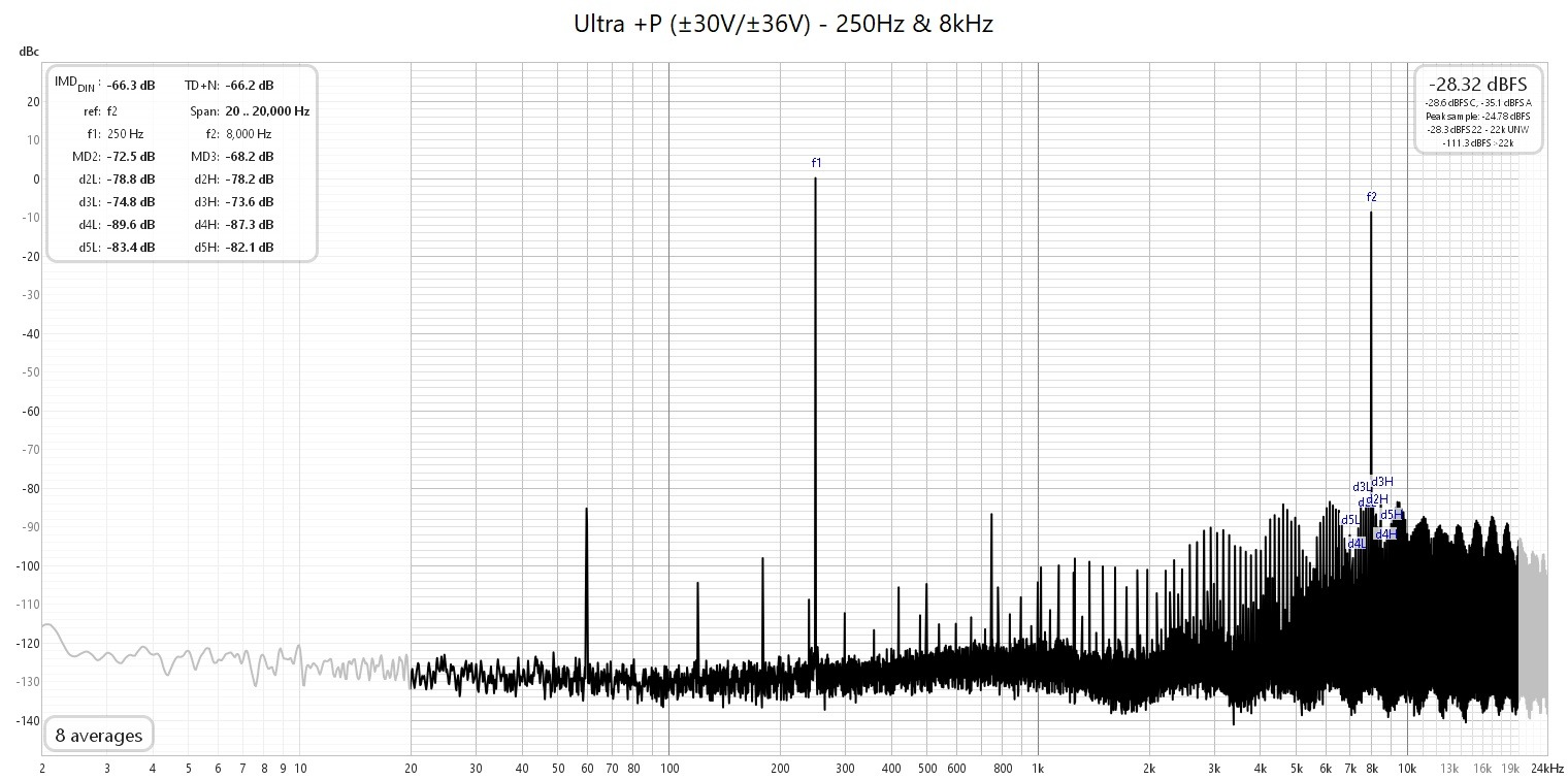

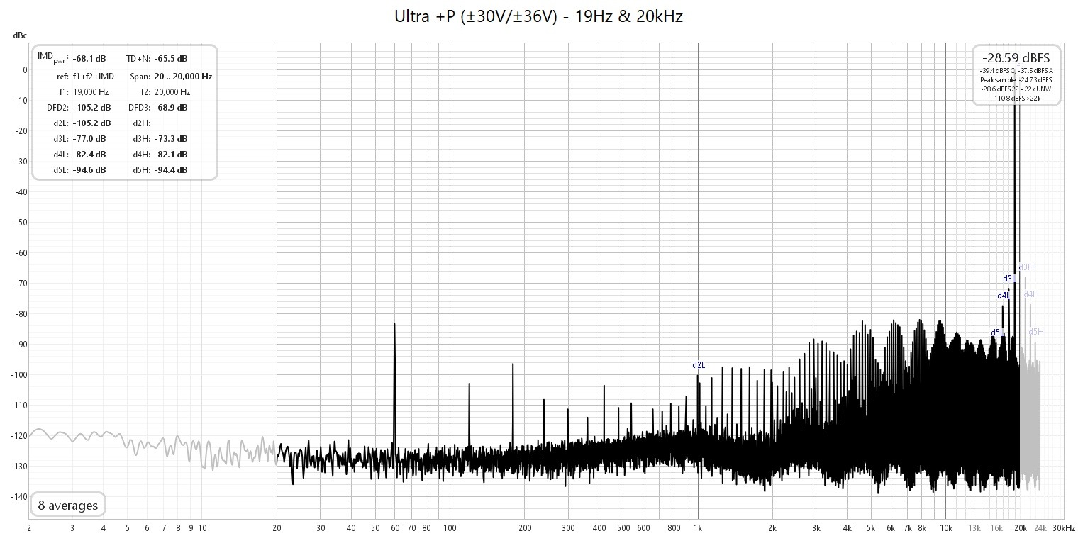

So, I thought it would be interesting to do a deeper dive into comparing topologies in simulations. All of these are running with 30V main rails, 36V IPS-VAS-Driver rails, and 500mA of bias. The compensation was adjusted for 67 degrees and 15dB to 20dB of margin. I compared these variants:
  1. As Built
  2. Add VAS Cascode
  3. Add Drivers
  4. Add VAS Cascode and Drivers
The attached FFT plots are all 1kHz at 25W into 8R.
Of all of these, #3 seems to be the smallest change with the biggest impact. It retains the as-built distortion spectrum, but lowers the overall THD and improves IMD distortion by 20dB.
#4 improves it further with most reduction THD, though the change seems to be all even order harmonics reduction. It also has the best slew rate.
I believe #3 and #4 also provide less dependence on matched gain in the VAS devices.
However, the as-built isn't bad either 🙂.

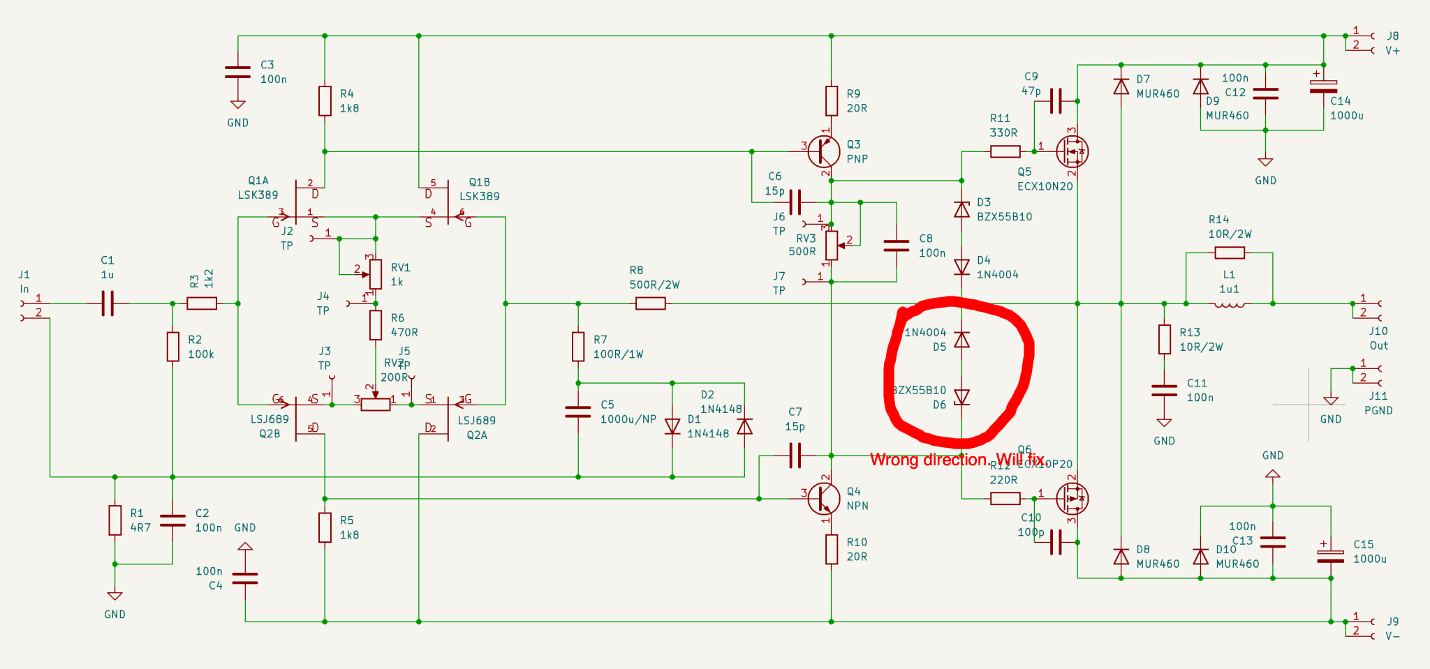

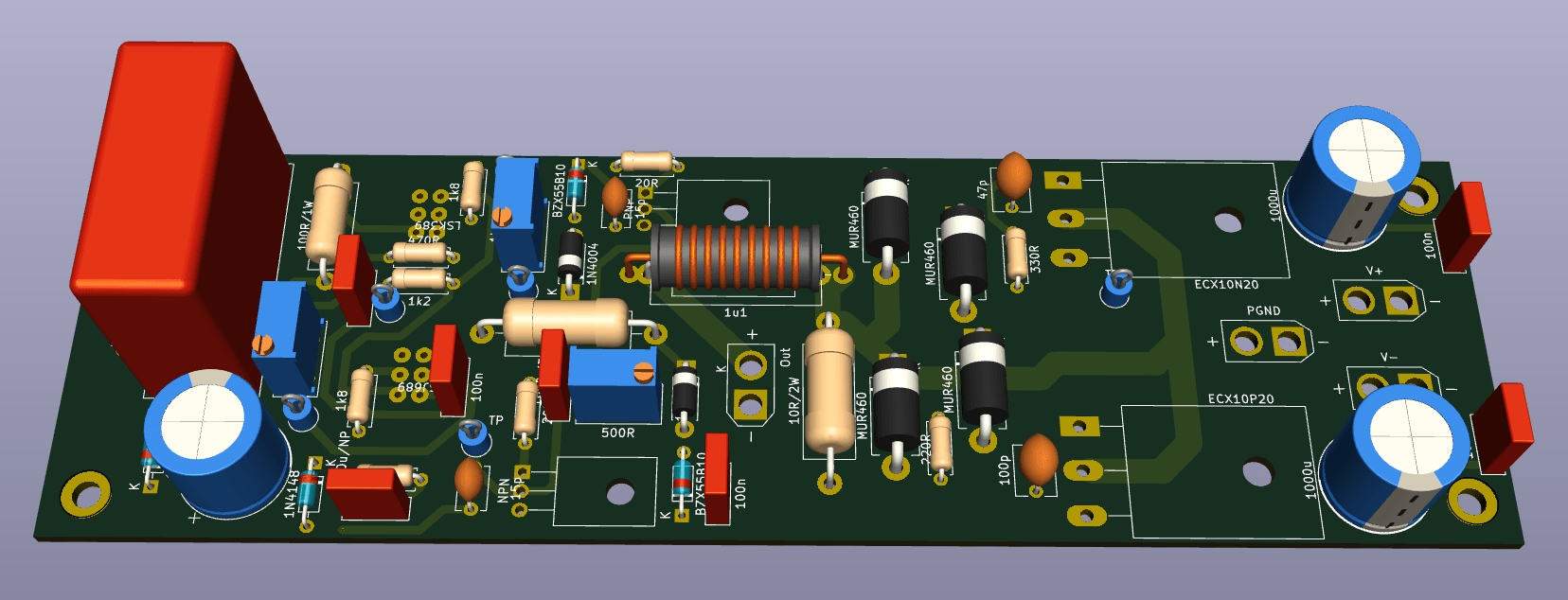

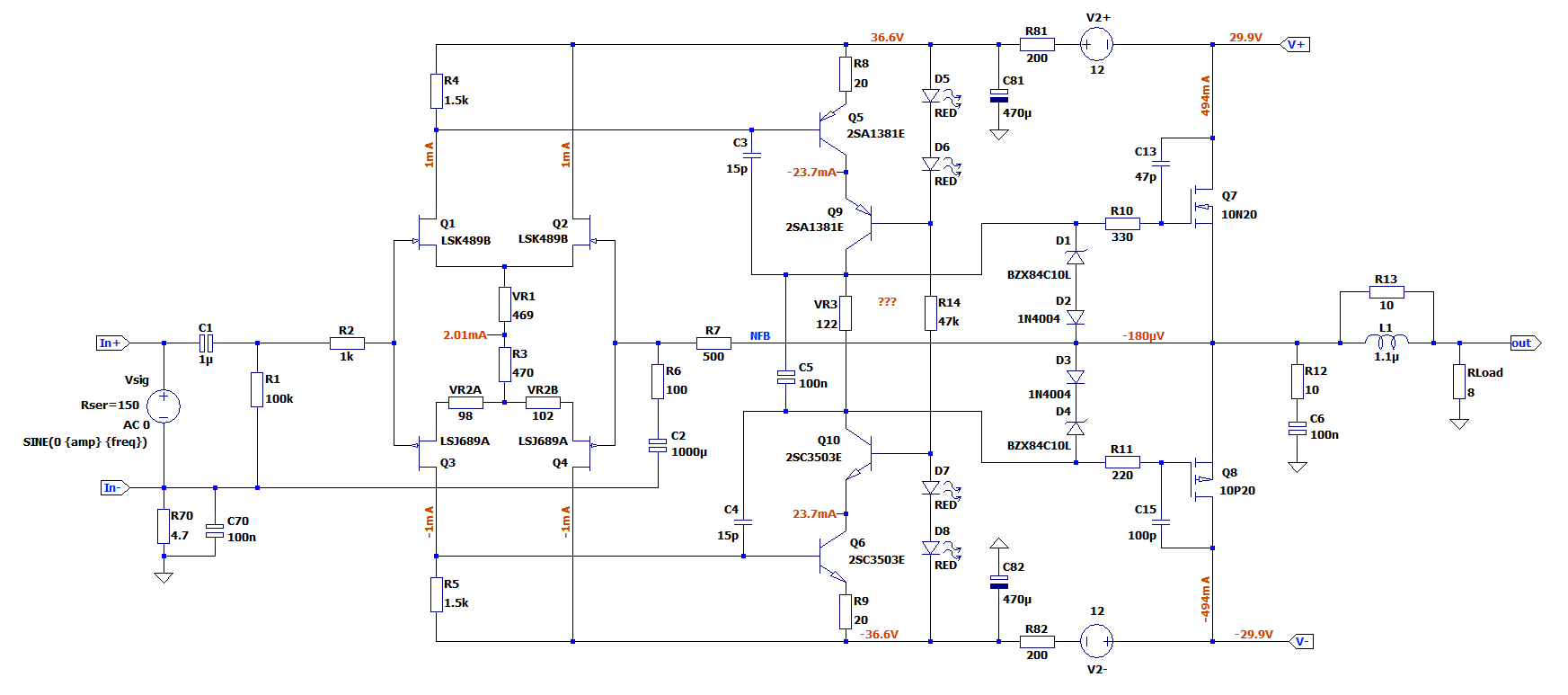

I have started working in a layout for a simple version (same rail voltage for driver and power section). First attempt doesn't look too bad.
Size is 50mmx165mm.
Would appreciate a 2nd pair of eyes on the schematic. If the schematic is correct, KiCAD's rule checker will ensure the PCB is not wrong as well.
EDIT: Found an error: lower Zener and 1N4004 have wrong direction.
Thanks to @lineup for the schematic and @brian92fs for additional tweaks.

What is the purpose of D1, 2, 9, 10 and why D3,4,5,6 the protection diodes are built into the MOSFETS die, see data sheet. D7 and D8 should be omitted they are in parallel with the MOSFET body diode.
C9 and C10 just adds to more gate source capacitance making it even harder to turn off. That is why the VAS needs 18mA, Rule of thumb is that VAS is rater 10mA, R11 should be 270R while R12 should be 330 R due to the bottom MMOSFET having lower gate capacitance. This is not from siming it, it is real life. Also R7 and 8 should be much higher so that C5 can be made smaller with better stability.
Diodes across capacitors was one of Randy Sloans odd design ideas but could never tell me the reason for them just to protect the capacitor from what - nothing. A better implementation is two capacitors back to back making them non-polar.
I am guessing RT8 and R19 at 100R would decrease THD and bring the VAS down to about 10mA the optimum value. Yjr reason for your lower resistance is to discharge the additional caps pasted around the MOSFET,
Why C3 and C4 it duplicates C12 and C13
That was my two cents worth, otherwise a nice design
Diodes across cap (D1/2) makes sense to me when the cap is high value and a low voltage cap is used to keep is physically smaller. If there is a fault condition with high DC on the output, it saves the cap from failing. Now if R7/8 are increased and a smaller cap is used that can be rated for the main rail voltages, then I agree these are unnecessary.
The MOSFET gate-source and drain-source caps are unnecessary if Exicon outputs are used. Not sure if this is the case with other out of production devices - assuming a builder was using NOS parts.
D9/10 protect the rails if there is a fault on one rail. Bob Cordell suggests their use. Just protection - not needed for the amp to function normally. Many designs do not use these.
For the lateral MOSFET gate stoppers, there isn't a clear consensus among designers on exact values. I've seen anything from 100R to 470R in these positions. I suggest 330/220 for TO-247 devices and you are suggesting 330/270. I don't think either is wrong. Just try to keep the N channel stopper bigger than the P channel to account for differences in capacitance as you pointed out.
I know we disagree on C9/10. I see them as being cautious and not really causing much harm. But I can't say for certain they are necessary.
For VAS currents, I don't think the exact value is critical. I choose to use around 25mA. But running a bit lower shouldn't make a significant difference. We are assuming that sims reflect real-life. Ideally, we'd test this on the bench if we really wanted to dial in peak performance.
As this is not a ultra-low distortion design, I didn't feel this was necessary and found around 25mA to be suitable. But that's just my opinion - no magic here. I'm guessing performance won't be materially different if 18mA is used.
