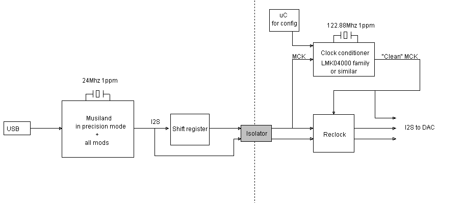

The issue is that if you us a common receiver in "slave mode" you need to feed it a clock that matches that input clock average speed very well.
If you use a clock with a guaranteed frequency deviation of no more than 1ppm for all three clocks (44.1KHz base clock, 48KHz base clock and 24MHz clock for the Musiland) you loose or repeat in the worst case 2 samples per million samples. But jitter is fully locked out.
Of course, you need to select the clock and division ration for the receiver side correctly for this to work.
Ciao T
OK thanks,
i understood correctly, i was curious if you had found a solution with these two clocks (one for usb receiver an one for spdif slaved receiver) synchronized by any means.
I was thinking about something like one Xtal osc for the slaved spdif receiver and a dds or pll synthesized clock for the musiland to mantain phase relationship between the two clocks.
Maybe this isn't feasible or anyway not so important.
Ciao
Andrea
Sure. Secondary PLL. But strictly for DIY the other solution performs acceptable.
Ciao T

Well, you need to use MCK for recocking. Isolation of a clock running from 12MHz to 50MHz without introducing a ton of jitter is quite non-trivial. Most commercial opto and capacitive isolators are hopeless in terms of jitter, Transformers have their own problems.
So I guess you need to look at a Video Line driver designed for HD analog video and try to find a matching isolation transformer (so both have enough bandwidth) and then optimise the resulting circuit to minimise jitter. There are also some dedicated clock distribution IC's that have low jitter and likely matching transformers for communication systems, but similar caveats apply.
Alright, thanks. That was my initial thoughts also. I was going for Musiland as a closest match back in GB thread, but having some doubts till now. Biggest question still remains, can this 1 clock concept (as attached or with similar mods) come close to 2 clocks, that we all would prefer ?
Money wise musiland is still a very good price/feature performer. Manufacturer was not interested in 150psc. deal, but some reliable ebay'er sure will. So ~45 USD + shipping is achievable imho.

Nowadays the best syntesised clocks manage < 50pS Jitter in the baseband up to 20KHz for "budget" devices. Mil Spec stuff can be better. And usually the nature of jitter in such system is noise, meaning it broadens the central peak of measured spectrum of (for example) a J-test spectrum, instead of producing distinct deterministic jitter, something which I think is less of a subjective impairment than deterministic jitter.
Ciao T
Measuring jitter at the transport output is pretty meaninless, I mean its how the jitter gets spread across the frequency spectrum after the DAC that determines its impact on sound?
I was not talking about transports, but integrated players.
A low jitter clock is shure nice too have, but it needs a squeaky clean supply to with really low noise. And then it needs to be injected into the system in ways that overcomes on-chip ground-bounce in the lead-frame and bondwire and other sources of what Ed called Logic Induced Modulation), all of which conspire mightily against having the 1pS Jitter from your clock arrive at the output of the DAC.
The lowest documented transport jitter I believe was just under 1nS (some $20k Boulder transport.)
And common receivers from cirrus logic do not attenuate this jitter at all until we reach two digit KHz frequencies.
So I can see how your argument that 100 ps of jitter is insignificant, the issue is when converted to analog does that extra 100ps of jitter all center at 1khz? That would be a problem.
Well, it is worth looking at synthesized clocks jitter spectrum, they usually display a double-wing shape. Further, the PLL Synthsizers tend to be quite good in cleaning up LF jitter from the VCO within their bandwidth, if designed right.
Ciao T
Have you tried 3.2V LiFePO4 batteries, I am stunned by their performance.
No, not tried these? What noise levels do you measure?
With my active supplies I get a few microvolt wideband and < 1uV above a few Hz. Are these batteries better?
Ciao T
Ciao T
