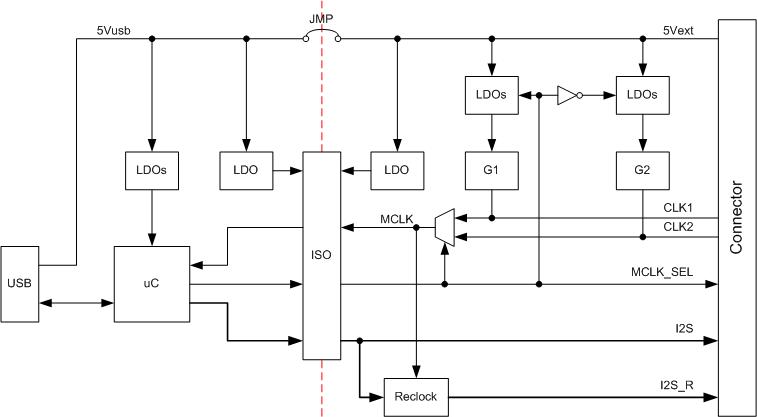

Hi Patrick,
AFAICT nobody proposed to design a complete, finished DAC with async USB input here. Surely PSUs, DAC, I/V, etc. should be left to anyone's own choices. I want to be free to try and choose whatever I like as much as you do.
What I had (and have) in mind is something not very different from what you propose. That is, only USB to I2S, nothing else. But I want it "done right"!
That is, in the best possible way. Which IMHO necessarily implies (among the other things) a clean clock and properly clocked signals on the DAC side and the best possible isolation from the computer / USB bus noise, grounds, etc. Hence something like what's depicted in Eric's block diagram.
IMHO there may be various useful options on this "thing".
One is about the clock(s). That is, whether to mount them on the USB to I2S board, on (your own) DAC board or on a separate, dedicated clock board.
Either way a clean, low jitter clock will be on the "clean" side and is (or can be) directly connected to the DAC as it should.
In principle, it doesn't matter where the clocks are mounted. The overall design and its functioning remains exactly the same. The only concern is about the transmission of the clock signal and the jitter increase that this may cause (I'd say not much if done properly, but surely quite a bit if done badly).
Mounting the clocks (+ clock "switch") on the USB->I2S board or on a board on their own IMHO should not make any difference (does it?). But having them on a separate board will surely cost more money, so why bother?
I'm sure many people will like to use whatever DAC they like (perhaps the one they already have...) without messing too much with it. Having the proper clock generated (and selected) on the USB->I2S board, one may have different options to do that. Even with little or no modification at all to the existing DAC.
Of course someone else will rather prefer to have the clock as close as possible to the DAC chip instead. Doing that will almost surely require a custom DAC board (or some more in-depth mods to an existing one), as you need to provide a way to control (select) the appropriate clock according to the control line coming from the USB->I2S board as well as sending the selected clock signal back to it.
Nonetheless, the same USB->I2S board can be used. All that is required is to omit to mount the clocks and clock "switch" on the USB->I2S board and feed in the (proper) clock signal back from the DAC board.
Of course, proper connections for both modes of operation (clock in & out, clock control line out) should be provided on the SB->I2S board.
(should we like to do so, it may even be possible to provide some quick, easy way to disable the internal clocks and enable the external one using jumpers or dip-switches. That way a fully stuffed board may be used in both ways without modifications).
Another option that I can imagine is about avoiding isolation, reclocking, etc. That is exactly with what you proposed: just the uC, a few required supporting components and a bunch of connectors.
But this can be done also with the same board implementing Eric's design: all that is required is to provide the option of not installing (and easily by-passing) isolators and related circuitry and/or providing some extra connectors on the board.
Yet the user will still have the choice as to whether place the clocks on board or provide it externally.
This is what I meant with "flexibility"... basically one board fits all needs.

If you look at Ayre QB9, or papers from Hawksford, or indeed comments from Jocko and the like, you want to place the clock at the DAC, not the uP.
That can only mean outside the module we are discussing here, as everyone has his own DAC choice.
And if you want to do the clock right (lowest jitter), there is only one choice IMHO -- differential Colpitts driving ECL logic.
http://www.diyaudio.com/forums/digital-source/154401-differential-clock-4.html#post2054656
Not everyone want this complexity.
Buying a Crystek XO and adding a LT1761 is for me not lowest jitter.
Hence my proposal.
But till now there is no chip which comes with affordable software, so we might well be discussing for nothing....

what do you mean? physically or logically? 😕If you look at Ayre QB9, or papers from Hawksford, or indeed comments from Jocko and the like, you want to place the clock at the DAC, not the uP.
From a logical point of view, with Eric's diagram the clock is "at the DAC" (and is sent back to the uC from there).
From a "physical" point of view, if you mount the clocks on the uC board of course it will not be "at" the DAC (yet likely only a few cm apart).
But does this really matters? or is it more a matter of proper connections (impedance matched lines) and terminations?
sure, that's exactly my point!Not everyone want this complexity.
If you want to make it simple, install the clocks on the uC board.
If you want to go fancy, just leave that part of the board empty. Place whatever "super" clock(s) next to your DAC and feed it back to the uC board.
That's it.
As said, the board should support both clock input(s) & output(s) as well as a "clock switch" control line (which tells you the SR "family" of the incoming stream) to make your design as simple as possible even if you decide to go fancy. With a diagram like Eric's one, that's easy to do. Basically it's just a matter of adding the required connectors.
indeed. That's sad... 🙁But till now there is no chip which comes with affordable software, so we might well be discussing for nothing....
