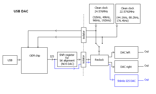

All these chips can be equivalent since they work in asynchronous mode and are bit fluency.
I join bloc diagram of an USB DAC (NOS or OS) whatever the OEM chip used.

Hi, Eric!
I think you forgot include control signal for clean clock switch originating from OEM chip.
Oh! shame on me, I had seen the other thread some time ago but forgot about it!http://www.diyaudio.com/forums/pc-based/135313-pc-dac-how-5.html#post1953944
XMOS Support Board • View topic - USB 2.0 Audio: How many channels?
Sounds like we are 6 months behind with this thing anyway.
Maybe the other guys are already further ahead ??
I guess we should join the efforts...

Perhaps we should first come to some form of consensus before we proceed further to discuss implementation details.
My first point would be, what should be in the "module" and what not.
In the original GB, the module for 50 Euros is basically a single PCB with a USB in and a I2S out, with a uP doing the conversion and a clock switching command line between 2 clocks. I think we already said the clock should be close to the DACs and hence not next to the uP. We also said we want external power supplies for uP, DAC, clock, ..., meaning they are also not on board. Also no SPDIF, otherwise just easier to buy Hiface or whatever....
On the software side, Windows (& Mac, Linux...?) driver(s), I2S out, optionally other formats like left justified, etc.
To give full flexibility for choice of DAC, I would also NOT include shift register, digital isolators and reclockers in the module. They add costs substantially and are not tailored to everyone's needs.
If what I described is what we are looking at, then it is simply a few connectors, one uP chip and a few local decoupling caps. And we should be under 50 Euros if we can get a minimum of 100 units signed up. Otherwise it's no go.
For all the other functional blocks as suggested by Eric (thanks for the excellent block diagram), I think they should be implemented as individual modules so that everyone can decide what he might or might not need.
For me personally, I would only need the USB to I2S converter, since I am already designing my own for the rest. But that's just selfish me ....
Just my personal view.
Patrick

Hi EUVL,
- This reduces individual acquisition price of each module (but increase global price),
- This reduce design time,
- Each of them can choose necessary modules,
- We can design various modules for same function (example: power supply),
- It offers very wide flexibility and easy evolutions.
It seems to be a very interesting idea
It is a very interesting point of view, I see many advantages:...all functional blocks [...] should be implemented as individual modules so that everyone can decide what he might or might not need...
