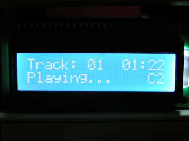

pls see the cd-rom kit running!
thx
thomas
