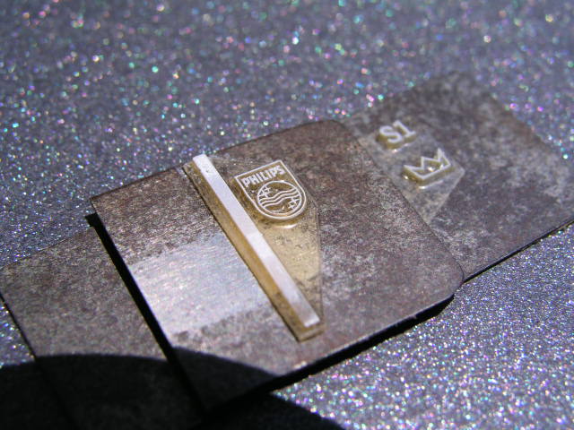

hi all,
i was back. Alert, alert, alert!!!!!
Don't paid much money to buy the S1 or S2 chips.
I call one of my friend in china & take me to go to the reprint base of many IC chips. Most was famous as PCM1704 to K grade, AD1862 to N-J grade, opa 627Ap to BP etc.
some was use NE5532 or other chip IC reprint to famous one.
such as in TDA1541a to S1 or S2.
i told them that I was the middle man & hope to see the re-print chips. I will order many chips MOV 200pcs. I ask that can i paid money & take them away. they said no. I said if not how can I show to my boss to see the quality.
At last they only agree to show me the mould for print. Sp pls take care, In my opinions, Pls don't buy S1 or S2 in China or east asia. so why recently quite many 1541a S1 or S2 chips in market.
take care feiends. They use polishing machine to erase theold words & re-print the new one. its not east to versify the reprint or not.
I hadn't ask them any overseas order or not. So I did not know any chips was sold to oversea or not.
BTW, take care!!!!!!!!!!!!!!!
thx
thomas

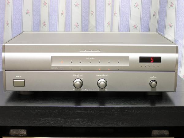

Its
Marantz project D-1.
Project D1 (\500,000) D/A.
http://www.geocities.co.jp/Hollywood-Miyuki/7088/projectd1.htm
I bought one second hand from Japan for me to compare with the new coming machine.
The new version coming will operate in this format.
