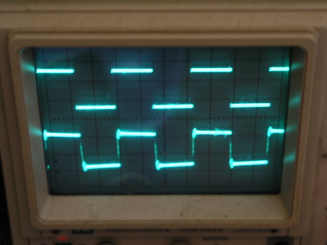

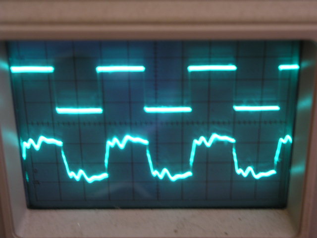

Hi all,
I was back because so so busy recently. I go to china north side for one trip for a dream coursethat construction the drean primary school to the village children. The communiction & transportation also not good. I only call my brother help me to answer some emails.
very sorry to late reply.
let me answer step by step for the questions.
Hi quantran, very thanks to help me to answer the question when I was not here.
Hi jleaman,
not need to worry about the voltage, when U loading with the tubes(EZ80), the voltage will drop back into the regular voltage. I test already.
Secondary. Pls series connect the 82 ohm follow with the dac & the op-amp. otherwise change the value can adjust the level of the sound. Pls try to do. I was back, can answer U quickly.
Pls see some of the photos. The dac & all the product coming will low in price. since I arrange a small prodution team in china, Or I said help some poor people to earn money in the small factory but the salary ( labour cost) now will be low. I can use low cost to develope the products.
When I back to hong Kong. I saw some of the emails that said although the maimatching of the dac cause some of the problem. So I will run back to single chips.
When I was on china. Some of the electric sales told me that will very easy to change the standard 1541a to double crown, only cause USD 100 for the sample. I was very interest for this. so I buy the sample/. The sample was a imprint word that can erase the old word of the chips by sandy machine & re-print for them. I will post to forum later Pls Pls Pls. don't buy any stated double or single crown chips in china or from china seller. This is high risk.
I was testing the sample of the pre-amp OPT for the 6c45/417a tubes. 5K:600ohm.
The test result as about.
