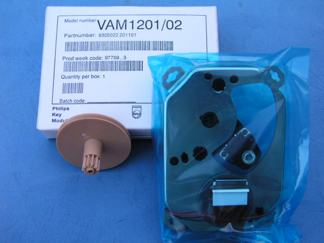

tray gear for CD-M4 and CD-M9
I had both CDM4,9 gear & CDM9 mechanism.
Pls understand that this is not a selling forum,
I had several set only. This is my stock.
If U like to buy the plastic string same time. pls let me know.I can order fromthe dealer only USD 3.5 per pair. Then full set can extend your cd machine long time.
thx
thomas

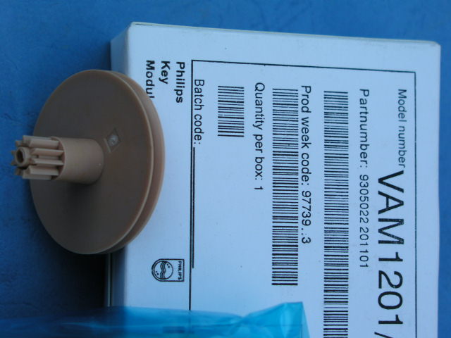

Phillips CDM9 Pro opening/closing gear
I had several set remain.
Got from Philips with my TDA1541a chips.
Pls let me know which diyers had interest.
Hi delapoer,
is the whit wheel was CDM4 one. Pls let me know if U like & hope considerate change the plastic string same time.
thx
thomas

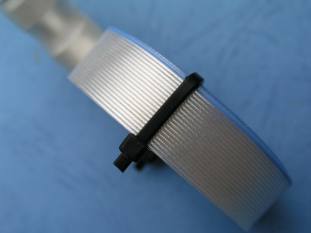

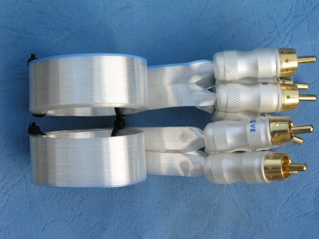

hi deandob,
very thanks for your informations. This is a 75 ohm digital cable which use in the aerospace for digital signal transfer.
I order them from a factory which OEM for USA areospace transmittion signal wires.
I tested them already & send to several friends to test already too.
Both test good feedback & i compare to gotham professional silver digital cable will better than gotham with faster feeling.
Price was reasonable to me from this factory diyers. so I prepare promote to diyers.
Pls saw my this year project. all will very low profit.
as the 1545DAC. It can use USB or RCA input. use chips change back the digital signal from computor to I2S.
hope diyer will love them. In this cheap price level. I guessed that more diyers will love them more.
photos show was anothers heavy silver plated telfon stranger wire which will be a cheap good project for diy cables.
I offer to all diyers include two pairs silver link gold plated OFC RCA with 20m this heavy silver plated wire in USD 45 include postage worldwide.
20M diyers diy one pair 1.5M signal wire.

Ultimate Twin TDA1541a Non-oversampling DAC with tube buffer & reclock set...........
Hi elso,
long time no see!!!!
can u share the experience to me that is the ribbon type digital wire not suitale for the dac. Pls informe me the detail because the aerospace fatory told me that this is the digital signal wire. I connect in my transport & DAC work well.also I send to my friend hadn't an problem too. If they really not suitable for dac. will return to the fcatory.
pls help.
thx
thomas
Thomas,
Your wire does not have any shielding and as a ribbon is unlikely to be 75 ohms - as Elso says you need a coax. Just because it works when connected does not mean it is optimum (and silver is not necessarily better).
Can you explain how the ribbon cable is 75 ohms?
Dean

Hi ,
you need a properly terminated transmissian line. That is 75-Ohm coax terminated with 75-Ohm at both ends. And a 75-Ohm connector sytem (not RCA). See Horowitz.

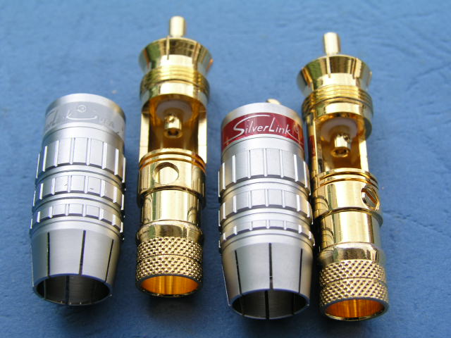

re: Digital Cable
As far as I know only WBT offers RCA plugs that are 75 Ohms. These are expensive NextGen types though.
http://www.partsexpress.com/pe/pshowdetl.cfm?&DID=7&Partnumber=093-604

hi elso,
very thanks for your advise. I neglected that take more data for the cable & I only considerated tha the cable was for digital signal transmission. I will return the cable back into the factory to prevent the diyers unhappy.

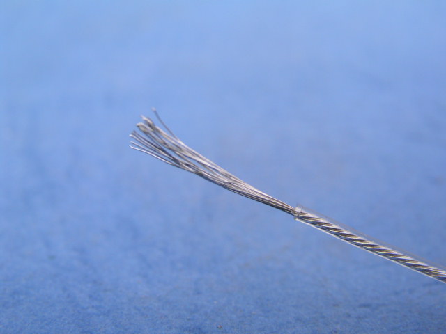

Hi fred76,
I still testing the tube buffer PCB. One of the diyers told me that after He change the Power transformers. The Hum noise lose much. Do U had another power transformer to test for this.
The another tube PCB cab use back approx all the parts.
about the 75Ohm RCA. Look it was a expensive parts. I suggest bought themselves to diyer cable.
For te cable, its a heavy silver plated cable. Not silver core cable.
If U lke to see the solid silver core cable pls see the photos.

Hi Thomas,
I agree with Elso. 75 ohms is a must for a proper coaxial S/PDIF connection. I use Belden 1506A or 1695A with Canare 75ohm BNC connectors and receptacles (not the 50 ohm types widely used). If one must use RCA connectors for S/PDIF, I'd recommend Canare coaxial RCA connectors. Neutrik also has 75ohms BNC's (male and female) that are heavier duty (outer body is made out of stainless steal) than the Canare ones but more expensive as well. I haven't tried them so I can't comment on their sound.
