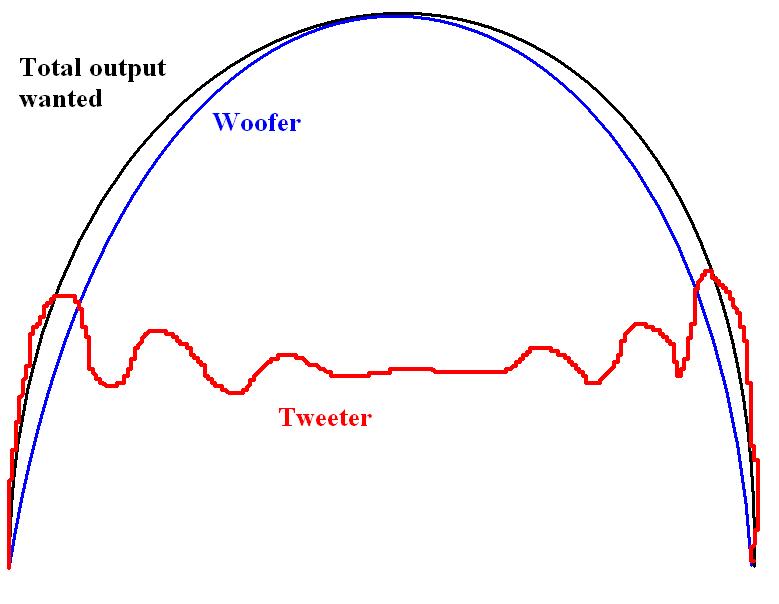

As pinkmouse said, if it needs to stop fast, then it's not the subwoofer problem, it will be the tweeter problem.
X-over will direct the "too fast climbing" and "too fast stopping" parts to the tweeter.
This image is a very gross simplification...
We're not pushing analogies - we're pushing cones... (grin)

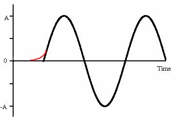

The problem, as I see it is not so much speed, as distortion. The issue seems to be that some are worried that a speaker can't move fast enough or have enough control for transients, not that it won't produce the fundamental sine wave. Correct?
Now, as I said in another post, we don't really need to worry about this. Any frequency above that of the crossover sine wave, must, by definition be crossed over to the next driver. No bass driver needs to move any faster than required to produce that basic sine wave.
Ok, if we take that as a given, then we only have to worry about the transient condition, when the cone first gets the signal, say going from no signal to the initial slope of the sine wave. Note, I'm not worried so much about the opposite situation, when the signal stops, as I would guess 90 percent of bass signals have some form of fade out, ( even reverb on synths will do the same thing, so you can't catch me out there! 😉), so the problem will be so much less.
At this point, I have to admit my maths is very rusty, so rather than using equations, I'll try and explain in English.
So, if we assume that no cone can accelerate at an infinate rate, then the first part of the transition from stationary to movement will produce a rounding off at the bottom of the curve, and I think that this is what worries Scott, (if I'm wrong, please correct me).
Part two in a while, I think I need to draw a sketch... 🙂
Ok, here's a diagram. The part I think we are discussing is in red.

pinkmouse said:
Well, all right then! 🙂
1. The problem, as I see it is not so much speed, as distortion. The issue seems to be that some are worried that a speaker can't move fast enough or have enough control for transients, not that it won't produce the fundamental sine wave. Correct?
2. Now, as I said in another post, we don't really need to worry about this. Any frequency above that of the crossover sine wave, must, by definition be crossed over to the next driver. No bass driver needs to move any faster than required to produce that basic sine wave.
3. Ok, if we take that as a given, then we only have to worry about the transient condition, when the cone first gets the signal, say going from no signal to the initial slope of the sine wave. Note, I'm not worried so much about the opposite situation, when the signal stops, as I would guess 90 percent of bass signals have some form of fade out, ( even reverb on synths will do the same thing, so you can't catch me out there! 😉), so the problem will be so much less.
4. At this point, I have to admit my maths is very rusty, so rather than using equations, I'll try and explain in English.
5. So, if we assume that no cone can accelerate at an infinate rate, then the first part of the transition from stationary to movement will produce a rounding off at the bottom of the curve, and I think that this is what worries Scott, (if I'm wrong, please correct me).

1. Correct. (..and the problem with fourier analysis was "time" based - i.e. music is effectivly aperiodic, not periodic - you did get that correct? ..It wasn't my intention to be obtuse.)
2. Not entirely correct - go back and read my previous numbered comments, but esentially - correct. (..note though that using the description "faster" could be problematic again - and be interpreted incorrectly. Better to add the term oscilation i.e. "faster" oscilation.)
3. No.. we need to worry about leading and lagging conditions (i.e. rise-time and decay). They are inter-related subjectivly (the condition we are describing as "fast") and almost always objectivly. Most of the emphasis (what we look for in measurements) is directed to decay (as distortion - linear and non-linear). Rise-time however is rarely looked at beyond group dealy as phase relates to time.
The objective problem between the two is that the decay (and its amount) often delays and alters the rise in a music signal depending on the time between transients. (i.e. the reaction may be OK, but the re-reaction will likely be worse on short term transients.)
The subjective problem, (which is FAR more audible), could well be described as dynamic distortion (..and again the time between transients is very important). Here we have a transient signal (passband specific) that ..say.. SHOULD be down say 30db before then next rise - instead though its down perhaps 10 db. The problem then is the next rise is less "significant". The subjective effect has many different descriptors (with time as a modifier). In the short term that next rise or particular transient could sound slow, blunted, indistinct, etc.. An averaged response, (..averaged over the composition), would likely be described as compressed, loud, etc..
4. Heck my math is nearly non-existant. (unfortunetly it can be a much more precise language, but I seem to poor at languages in general - so I'm often sol when its used.)
5. Correct (modified by the above). Additionally, you need to be concerned about transient capability in relation to other drivers (call it quasi-group delay).
The problem then would be more than just time as a constant throught-out the group.. i.e. one driver actually seems "ahead" of another, but that one driver is only *occasionally* "behind" another.
This "sometimes lag" is often a problem with high x-max drivers. In otherwords when the transient is low in spl (relative to the average) and is activated in the passband where the high excursion driver operates - the sound seems OK. However (under that same general condition) when the spl increases for that transient up to or beyond the average then the high x-max driver seems to lag. -And yes, this is principally when some drivers are subjectivly deemed slow and others are deemed fast.- The classic example is a poor b@stard trying to "mate" a lowther in a BLH with something like a tumult-based subwoofer (in any configuration). Anytime any higher spl transient "hits" the tumult, the bass is deemed "slow". Of course it isn't that the driver is oscilating slowly - its that its transient capability is not that of a lowther in a BLH. (..and note to others - BLH means Back Loaded Horn - which reduces excursion.)

Good reply Scott, I'll have to ponder a bit on my reply. However, to give you a rest, I noticed an error, ( never post when you're half asleep), in my diagram above. Who can spot it? 🙂
I'll post again when we get the correct answer.

pinkmouse said:However, to give you a rest, I noticed an error, ( never post when you're half asleep), in my diagram above. Who can spot it? 🙂
Looking at that red line appearing before the actual signal, I hereby officially congratulate you for inventing:

perhaps there is confusion about what this sine wave represents... remember... it's amplitude vertically and time horizontally...
it would seem that any presumed "slowness" in the response of the woofer might simply be represented by a "delay" in the onset of the sine wave... not necessarily a 'distortion" of its shape...
This would then be a simple "phase shift" relative to the input signal and have nothing to do with rise time, transient response, etc.
So, perhaps, we're talking about phase distortion, which IIRC, was addressed back 2 decades or so ago when stepped baffles were first introduced... and often can be compensated for in the overall transfer function analysis of the WHOLE system rather than its pieces/parts...
