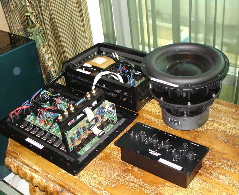

Deadly Subwoofer?
Hey Guys ,
I was looking for the ultimate subwoofer driver and i came across this driver.It is used in the wilson audio watch dog subwoofer , I dont know what brand driver it is , but it is mammoth , I have attched a picture with this message and you guys look at it and tell me what brand it is , If i can get it in the market I would surely use it in my subwoofer project which I intend to start soon.
Hey Guys ,
Hey, with another 3" you can spring for the PD2450. 😀
Then again, the Tumult is easier to work with since it's more naturally suited for sub-bass output.
OK.. Now even I'm impressed! Looks like he is using the velodyne eq. preamp as well. He isn't getting quite the low freq. extension that I think should be strived for.. but I'm starting to agree with his forum name.
What I'd really like to see is THD plotted against freq.. for this driver - both at 1 watt and 100 watts. As it stands the driver could be picking a nominal freq. like 100 Hz and then getting their distortion ratings for 1 watt. (.. which is absurd for sub-bass.) Hmm, looks like distortion is at least rated at 100 watts.
Which driver are you talking about?ScottG said:OK.. Now even I'm impressed! Looks like he is using the velodyne eq. preamp as well. He isn't getting quite the low freq. extension that I think should be strived for.. but I'm starting to agree with his forum name.
asside from the double spiders it doesnt look like anything too exotic. I'd say you could get a better driver for a smaller price without any knowledge of that woofer's specs, or price. Just knowing that its in any of wilson audio's speakers is enough to know that its overpriced.
