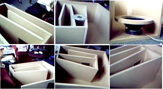

I'm making a folded exponential horn to suit 2 venom 8's tomorrow, start of the throat is 280cm2, length is 140cm and throat area is 2240cm2.
I'm actually horn loading a vented rear enclosure tuned to 55hz, no idea what horn resp will think of that, we'll soon find out though😉 (this is sized to fit in a hatch so I'm assuming 8pi space or better)

Volenti said:I'm making a folded exponential horn to suit 2 venom 8's tomorrow, start of the throat is 280cm2, length is 140cm and throat area is 2240cm2.
isn't that going to sound.. umm.. terrible? 😛
porting to 55hz ,if the response is flat already in HORNRESP will ofcourse cause an output peak near here.
i dont know how the 2 systems interact.
Be sure to report on its effectiveness,with and without ports. Because im interested in cars+horn

it's not supposed to sound good, it supposed to go loud 😀
besides it's un-charted territory, who knows?😎
