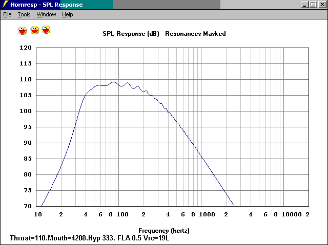

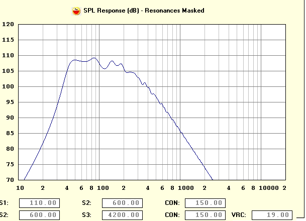

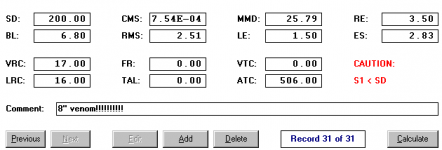

lol someone design me a horn box thingo for my cheap 8 inch Venom subs.. ok? lol
check my site.horn subs need specific specs and u never know how it will go exactly til u try it 😛 my 8" happened to be exactly right,i bought 2 for 19$ each or something 😛
my site

I really like cheap 8's cos I can get 16mm MDF for quite cheap.. (I think) and it would be funny as just having 2 8inch woofers..😀

I could never work out that stupid program.. looks like you did though... any chance of getting it flat to 30Hz? 😉 I know its a longer horn... but I can handle that... lol
i dont reccomend 30hz for this,seems to need a longgg length..but it could be worked around.
Check my website to see horns of similar types,it shows sizes.

well... I really just wanted to make a horn with a cheap but decent 8inch driver out of some "scrap" 16mm MDF...
id use 25mm MDF
high SPL + 16mm MDF=
resonance. could make the horn sound bad cos it has long dimensions.
30hz horn is probably400Litres.
40hz horn is about 150-250Litres(for my horns),so u can see why i like the 40hz ones.
I emailed u too.🙂
