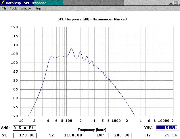

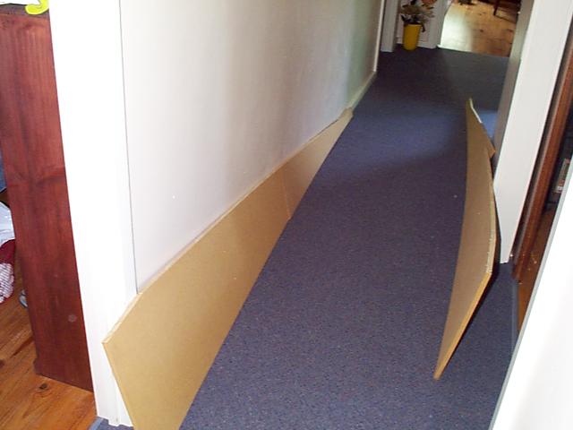

Started work on a Conical horn today... just for the fun of it, and to see if it works.. 😀 its 3 meters long with the 8inch woofer firing down... quite a small mouth actually.. lol 1100cm squared about.. 🙂 hmm... not sure where to put this thing...
might test it in the lounge room firing into a corner.. 😀 ahah... 3 meters long...
I gotta get some more cheap MDF tomorrow... and something for EXTERNAL bracing.. lol should do 125dB..... plus room gain... bit of a peaky response at 40Hz... but should be alright.. 😀 hehe hmm.... lol should be good.. 😀 cutting 2 layers of 16mm MDF with a hand saw is HARD WORK!!!

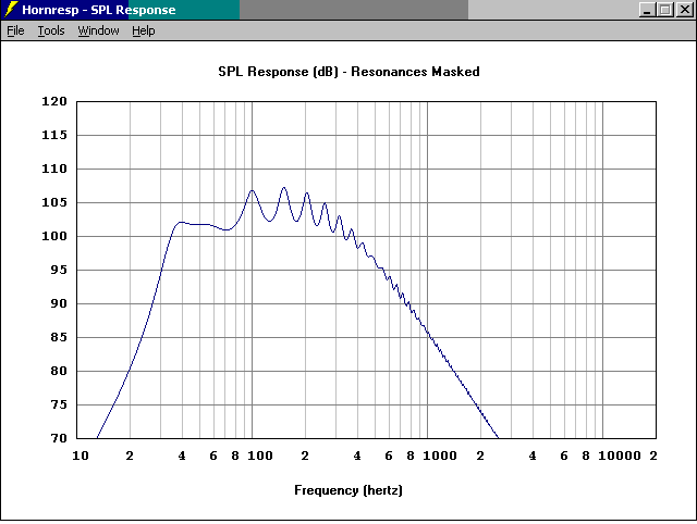

if this horn works, I will be starting work on a 6.5inch woofer in a horn, to give a 110dB 1w/1m peak at 50hz.. 😀 this equates to 128 or so dB with 70watts input, and a cone excursion of a mear +-2.5mm... the only question is how well will a horn work in a car? 🙂 is it worth me making the 6.5inch horn to enter SPL competitions, or not? thanx.. 🙂
I have to correct myself.. I found out my parameters were wrong... I can only get 107dB not 110dB.. hmm thats only 124dB with 70watts... lol 😛
SkinnyBoy said:I have to correct myself.. I found out my parameters were wrong... I can only get 107dB not 110dB.. hmm thats only 124dB with 70watts... lol 😛

I get the box cut today.

mikee12345 said:skinnyboy ur horn takes up ur entire lounge ;-)
mines only 143litres for 40hz🙄
I bet you don't even be able to see my horn once it is inplace.. 😛 lol
