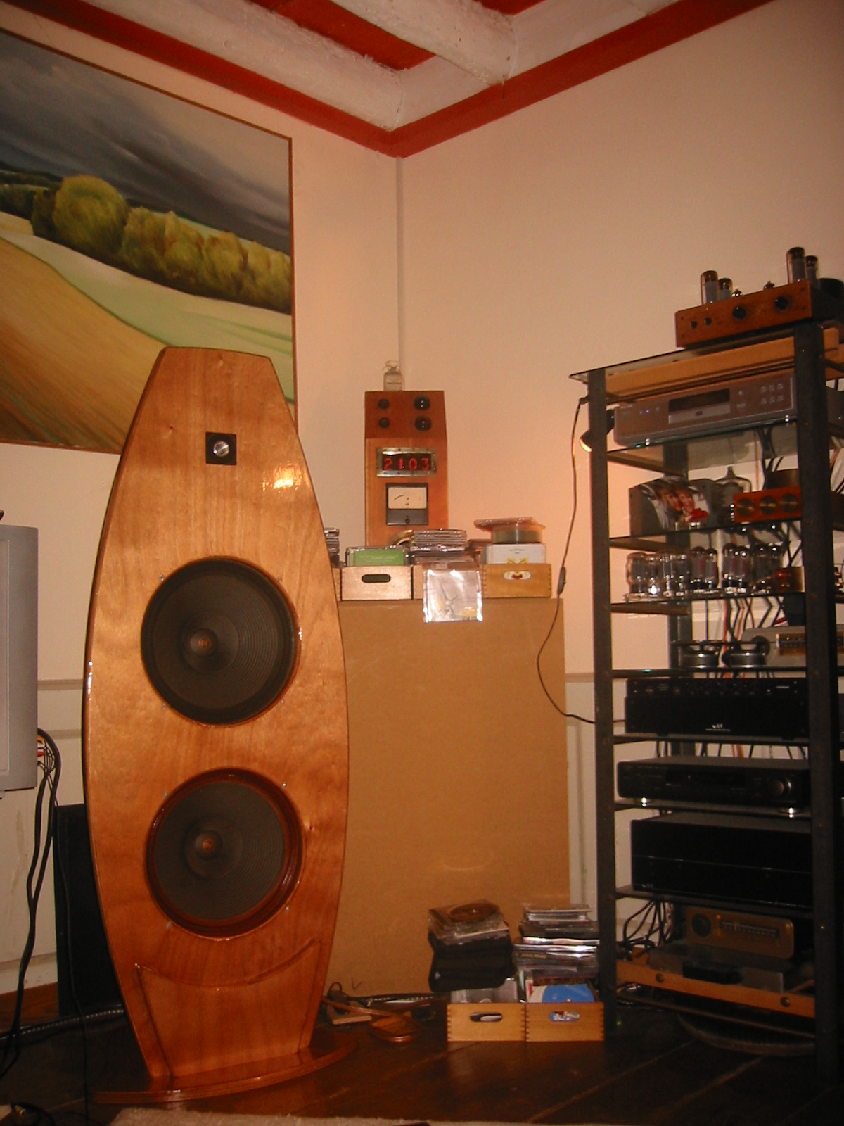

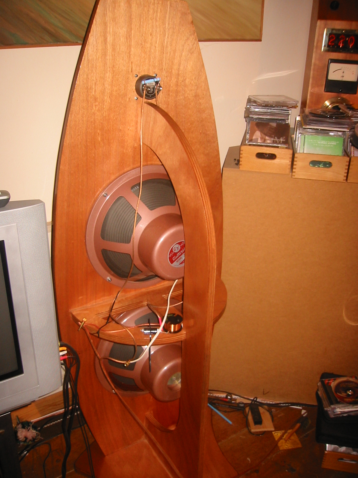

The speakers really fit the very nice looking room you have there!
I guess it's a passive design?
I'm curious of the crossover points chosen and if the the woofers can deliver the same kind of sensitivity in the bass as the Lowthers do in the rest of the spectrum? I have come to the conclusion that it is not possible to construct woofers that can put out bass down to to say 35-40Hz on a narrow OB at sensitivities anywhere near that of fullrangers (95-97dB). What is your experience regarding this?
Hello Oido,
I get close to 40Hz with 2 15" EV per channel.
Had to reduce the tweeter (FT96 Fostex) with 6dB.
This is passive, cut the woofers at 5kHz or so.
They don't need any extra bass, but they are huge, 3 times bigger than yours I'd say

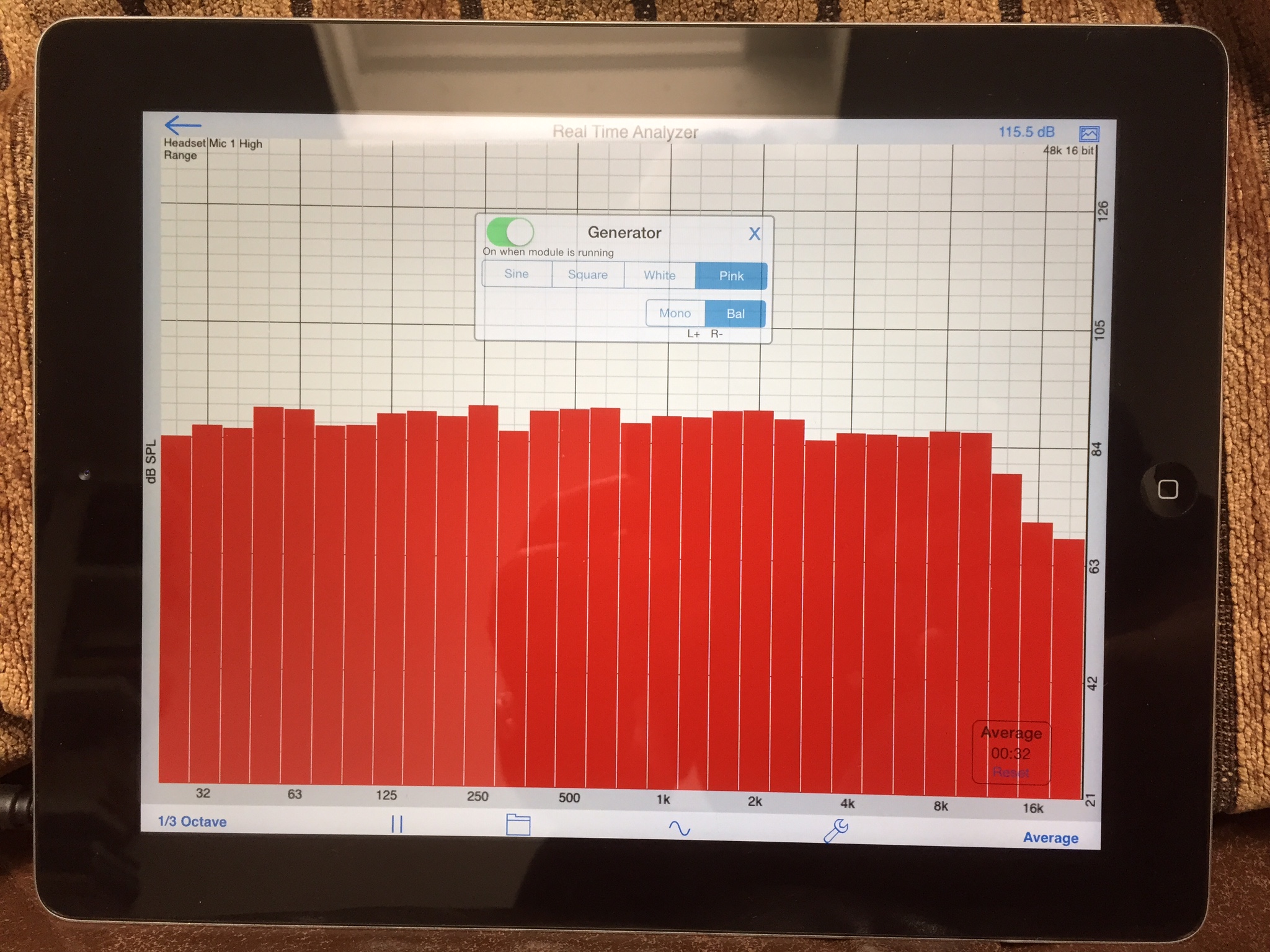

Nice Leon,
what tool is that? what mic did you use?
looking for a descent tool for a long time...
The prog is Audiotools by Studio Six Digital. It's in the app strore for about 20 euro.
The mic is by Dayton with calibration file for iPad.
This works pretty OK ; just walking arround in your room at several places.
However I do use Fuzzmeasure for more accurate.

In room ; dayton cal. mic on iPad.
Hi Leonidas, that response looks absolutely fantastic!
But you must be padding down the Lowther quite a lot, or active EQ or DSP on the bass?

Oido : there is NO eq or dsp !! Just my passive Leonidas XO.
In my room ; DX3 in minus 8 db.
Sound is optimised for medium 85~88 db. SPL.
according Fletcher and Munson I need plus 6dB bass for this level with smooth transition to the mid/highs.
Eff. about 88 /89 dB watt.

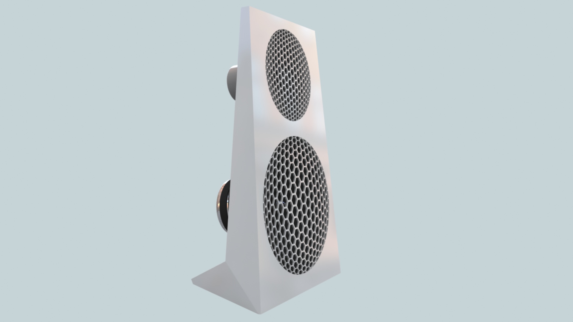

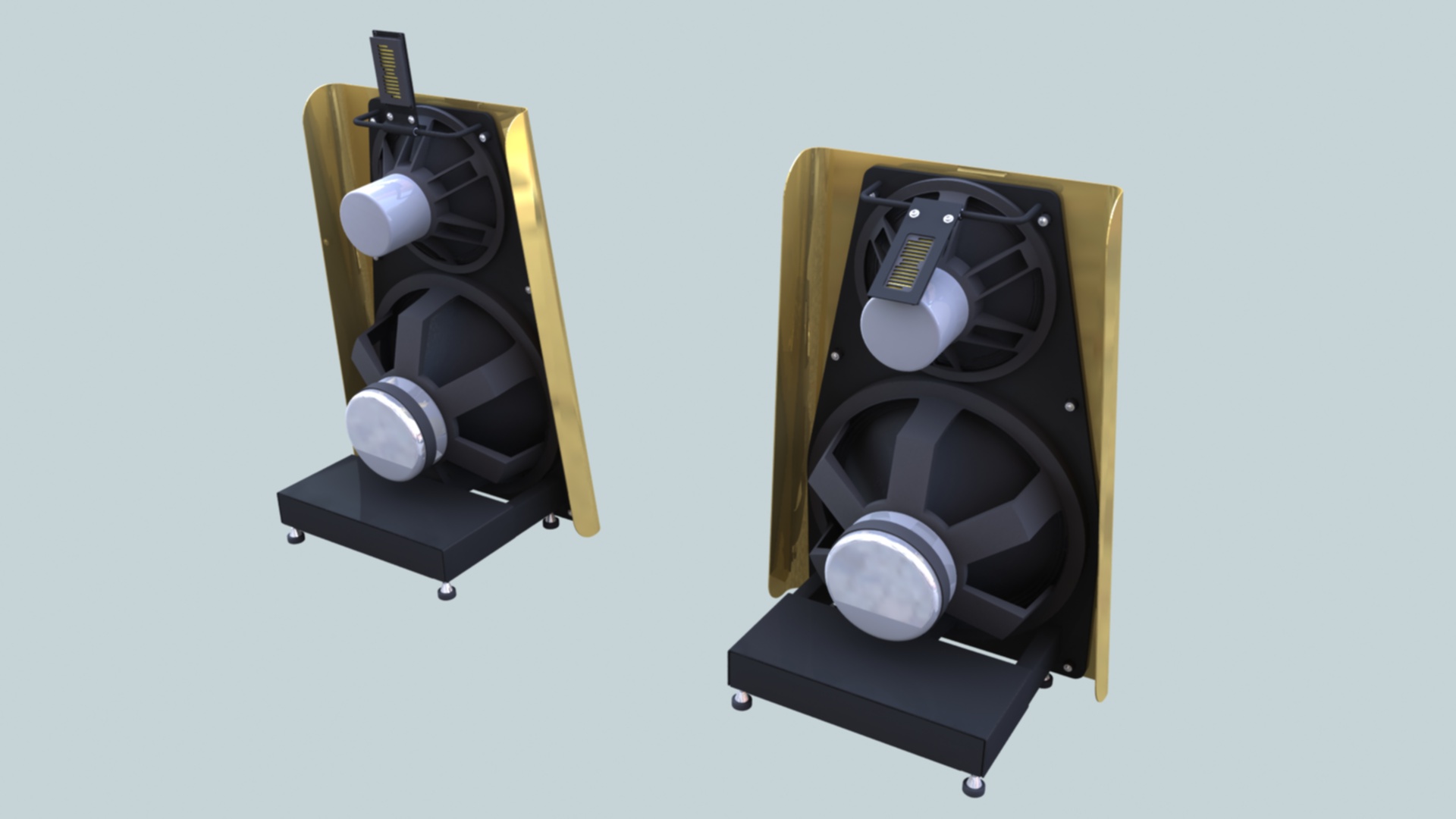

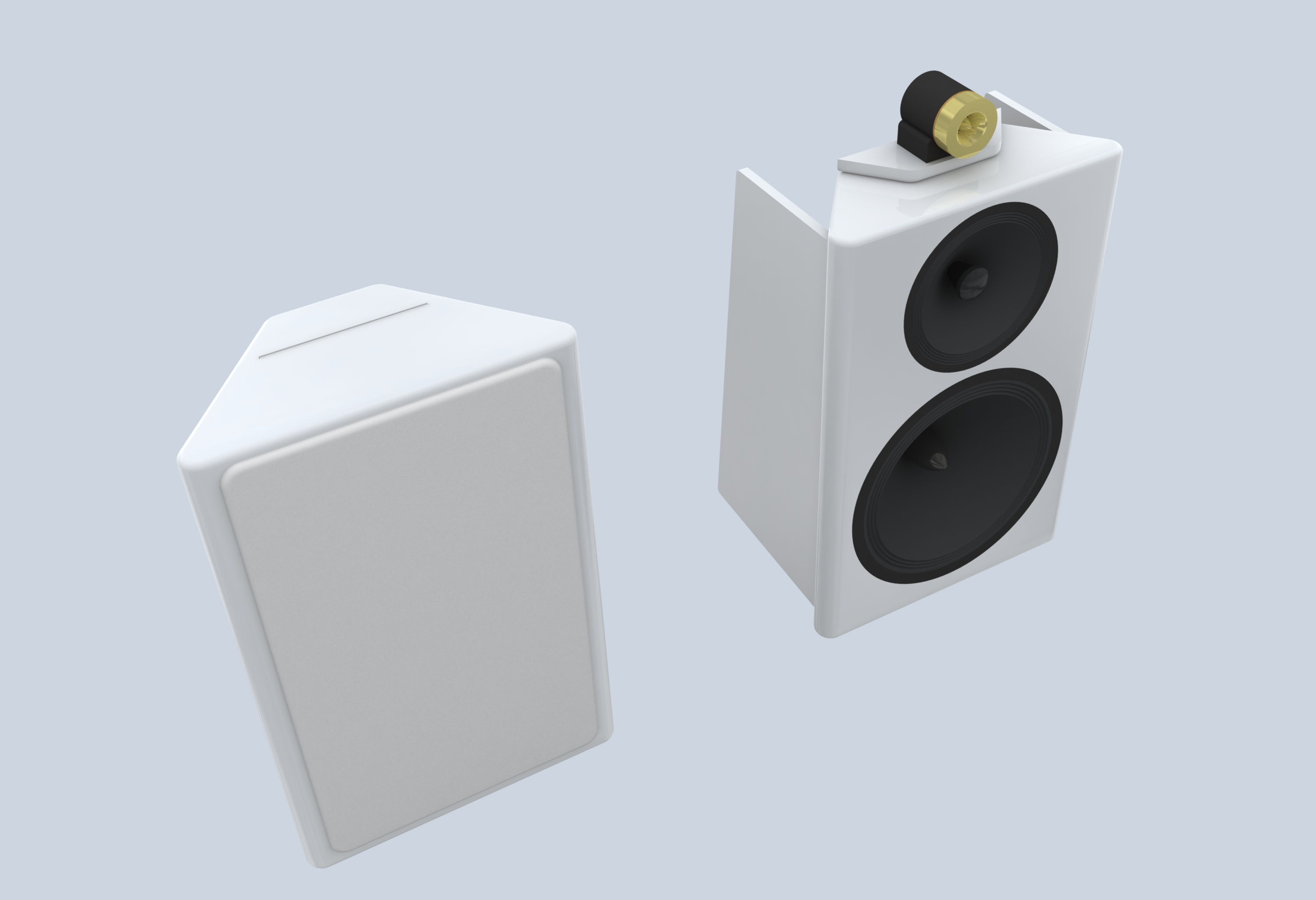

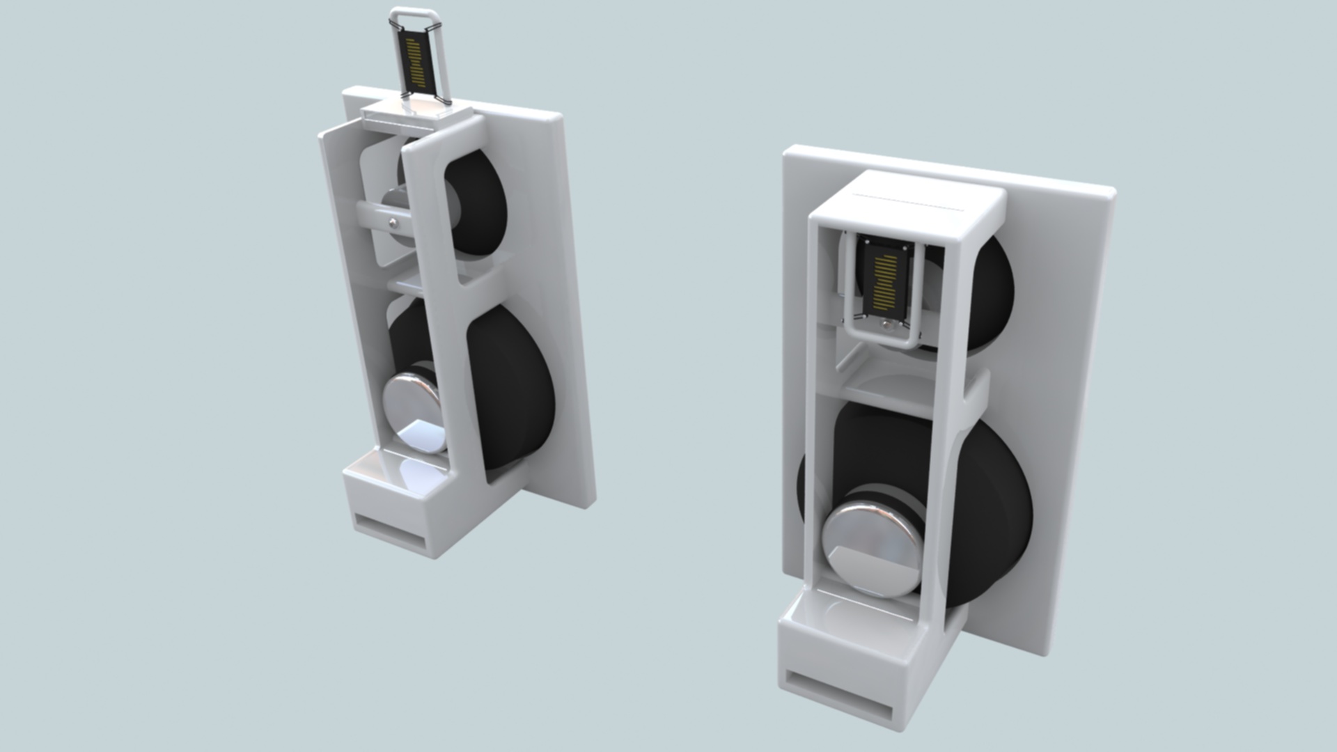

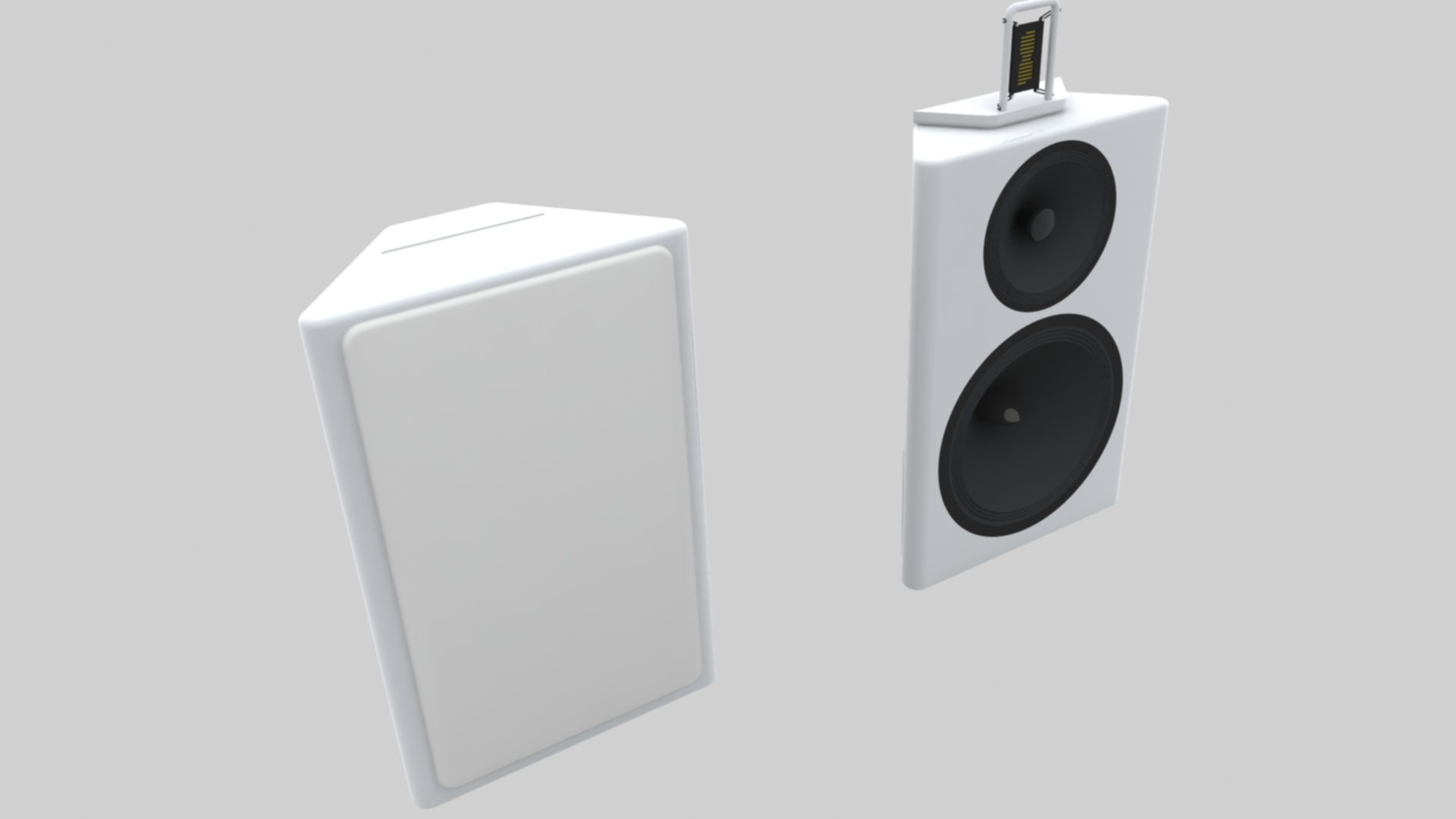

Just thought I should share some abandoned design ideas, in case it could serve as inspiration:
