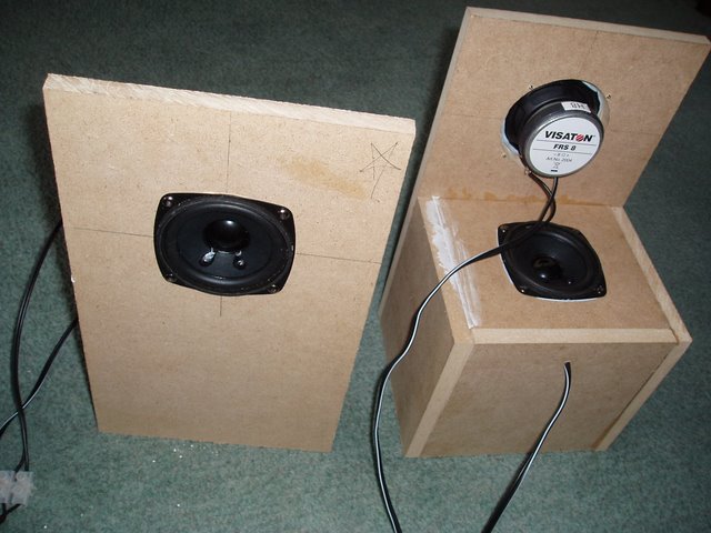

I've made some, with smaller drivers, and no ports. Sound good to me. Will post pics when finished.
I might have read Gainphile's response wrong, but the idea of the rear driver is to cancel the backwave of the speaker, thus reducing bass cancellation to a minimal, then the front wave of the driver is free to send bass into the room, instead of around the baffle. Hence, the rear driver is in phase with the OB driver, but (personally) I don't think the ports are a good idea, because the rear driver should follow a similar excursion curve to the OB driver, so adding a port would create a dip in excursion at port tuning, thus reducing the cancelling effectiveness around that frequency.
Overall, the idea is that you get the nice midrange and treble of OB, and bass which wouldn't get cancelled.

These are actually quite small (especially for OB), at 12" high and 7" across. 2nd order active eq (becomming passive so I can use only one amp), at 100-150Hz (Low pass) for the rear driver, full range for the OB driver.
It does bass fairly well - there's notes it can't hit - but most of is there. The midrange is good, lots of reflections in-room which makes stereo imaging wider (extends a good few feet past the speakers). Treble could be smoother, but this is a cheap 3" driver. I plan to get hold of some 5 or 6" full range drivers, and make a bigger version of this.
Doing a frequency sweep, 60Hz is audible but a few dBs down on 100Hz, which is pretty much flat with 1KHz reference.
These are unfinished, but I'm unsure on which colour to paint them. Traditional black? Some other less traditional colour, like bright green?
Chris
Chris

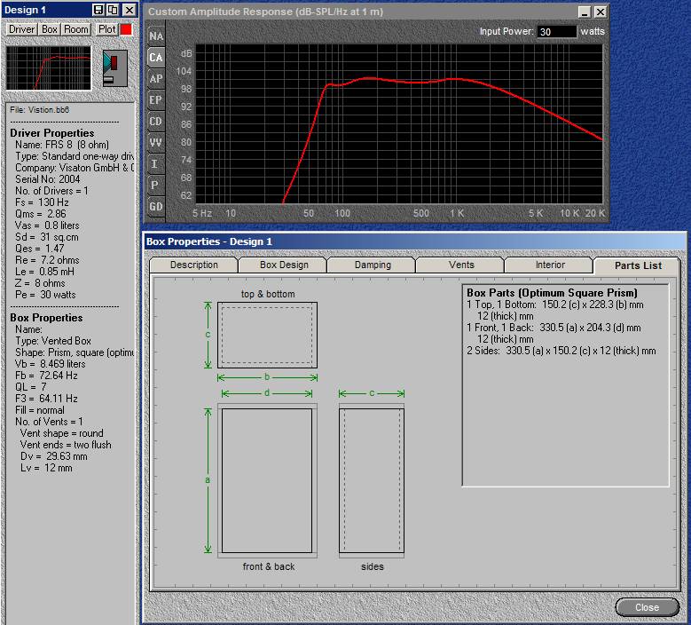

those look pretty cool chris FRS8 is available for £10 in the uk and has very flat response from about 100Hz:
http://www.visaton.com/bilder/frequenz/gross/frs8_8_fs.gif
however realisticly with some active EQ I would only hope for response down to 80Hz (which is enough to get the first harmonic of a double bass's lowest note (47Hz) in and so would sound pretty respectable).
I will stick that driver in bassbox and see how low it can go 😀
The FRS8 was used with a ported cabinet in Klang&Ton 3/2009. They achieved 100 Hz, which is pretty much the same you get in a closed box. The port helps a bit with the achievable SPL. But even with that the FRS8 is too small to produce significant SPL at low frequencies. Compression will start somewhere below 200 Hz to 300 Hz. A fine speaker, if you listen at adequate volumes. Not a fine speaker, if you ask too much of it.
