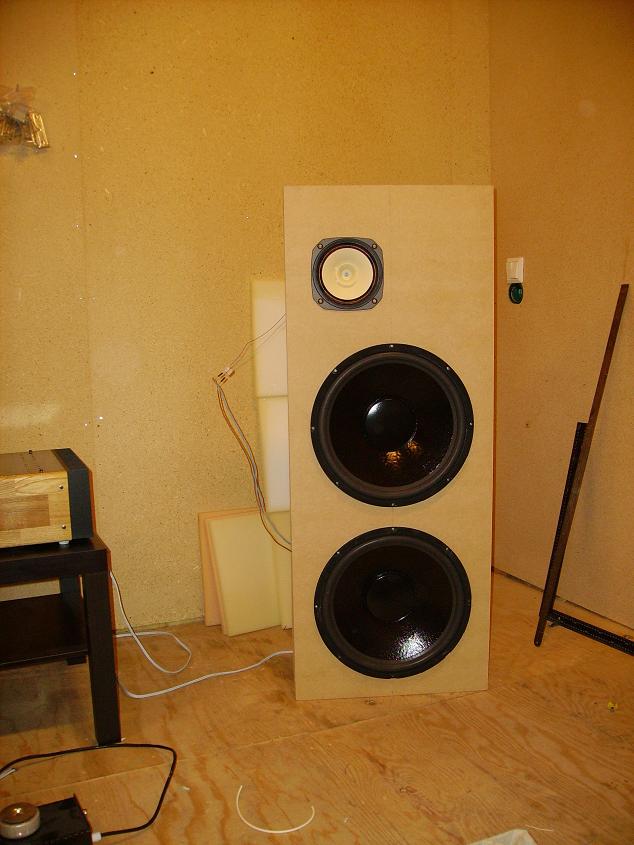

Fuling said:
My ongoing OB project: 120 x 48cm baffles made of 2x16mm MDF with dual 15" Rila woofers and Fostex FE167E for the mid/high.
Looks good Fuling.
Can you tell litte bit more about those woofers: what are specs, price and where I can purchase those?
I search good woofers for OB....I already know some (Eminence Alpha etc.) but it's allways nice to hear about new possibilities. 🙂
And of course I have to ask how you like the sound?
Micco
miccomacho:
Thank you!
The woofers are Rila BW 1521, they cost 595 SEK (just under 100USD) each at hifikit.se which is the only place I know of that sells them. Specs as follows:
Vas 312,81L
Fs 22Hz
Qts 0.34
98dB/1W
The Qts is quite a bit too low to be suitable as OB drivers but I had them for free so it would be silly not to use them.
For the moment I´m using some very crude passive first order crossovers so I can´t say that much about the sound, initial listening tests are however promising.
My preliminary plan is to use active 12dB crossovers (200-300Hz)for the fullrange driver and the upper woofer and then use the lower woofers as subs with separate filters.
