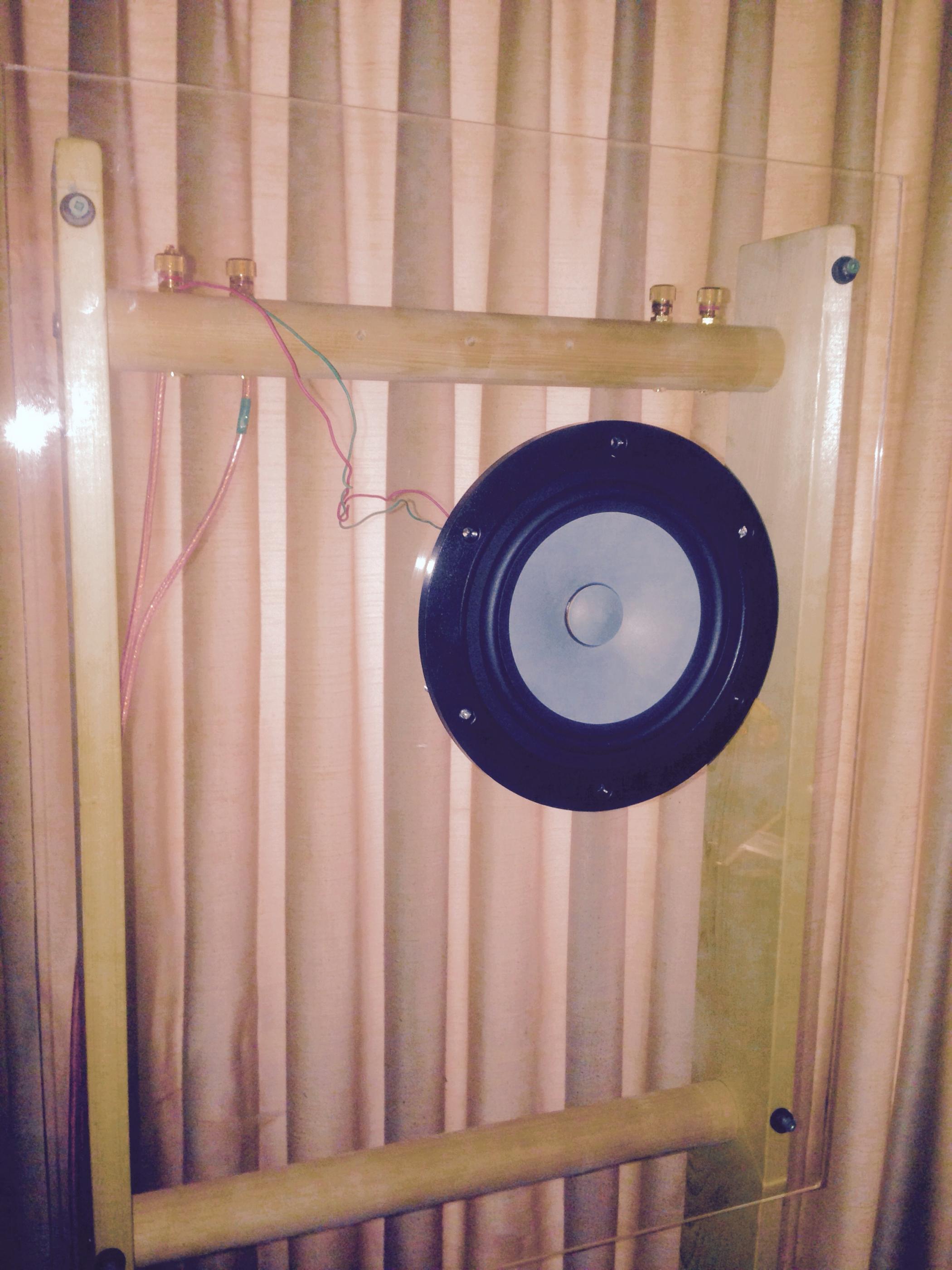

Markaudio 12P
These are off centred on a pair of 18x24" , 1/4" thick Optix panes, then screwed to frame with a rubber grommet between baffle and frame.
Not noticable on compact disc, but with vinyl, detail goes away a bit when run without filtering deep bass away , and actively directing it to a sub.
