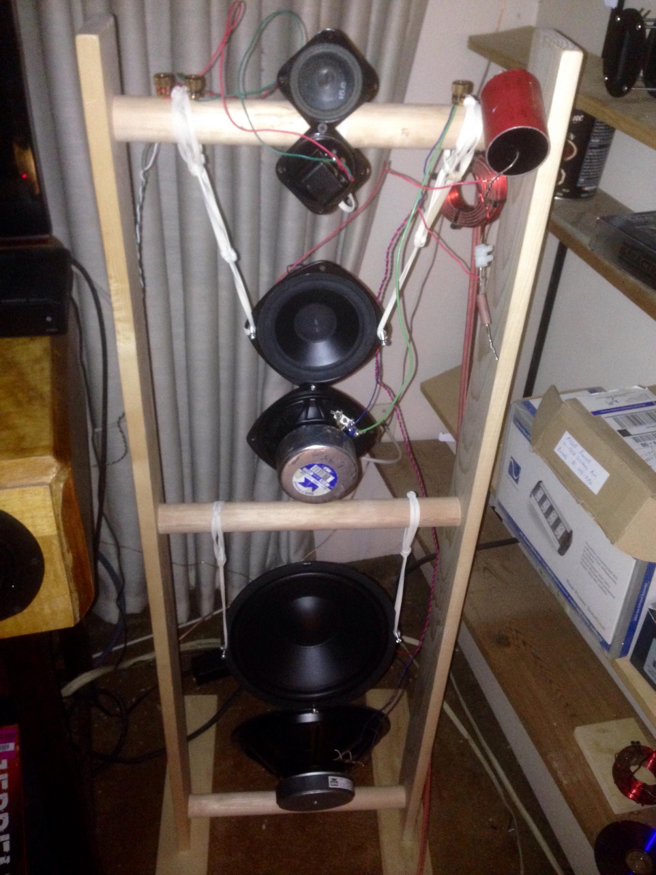

Nearing the end of this one's evolution
So a while ago, I figured out I generally like no baffle sound, but acknowledged it needs help in deep bass.
I'm happy with the blend these get with a previous Open top H Frame.(open top, but steeply tilted back, to limit midbass 1/2 space reinforcement from the floor).
So, after trying 98 db/ watt 15" trace Elliot (Celestion) woofers, I eventually got unhappy with the beaming.
This is my attempt to address beaming, and choose the boundary interactions that wouldn't be obstructive to a good listen.
From the top down, 16 ohm Peerless Alnico tweeters, firing in push pull, wired in parallel.
I'm hoping this provides vertical limiting on dispersion, limiting ceiling and floor reflections. I'm dubious this lowers distortion at frequencies this high(actively crossed at 2500 hz), but they do seem to sound sweeter this way.
The four midrange drivers have split the band in two-
Vertically stacked push pull, wired in series for an electrical resistance of 14 ohms, medium qts Peerless/M&K 5 1/4" , for vertical control of mid-high frequencies, passively crossed to the push pull 10", vertically stacked, series wired as well, for an 14.28 electrical resistance.
The 10" and 5 1/4" centre point of cross over is a little further apart than a first order calculator suggested, this dips the output for an acceptable response after dipole front wall reinforcement.
So this configuration gives controlled vertical dispersion similar to a line array, reduces side wall and ceiling reflections, provides push pull distortion cancelling benefits, passive eq'ing of the mid band, keeps the upper midrange away from floor and ceiling reflections, allows lower mid bass to couple with the floor for good 1/2 space reinforcement, and uses progressively larger drivers to move more air, while maintaining similar radiation patterns. As an added bonus, the Peerless 5 1/4" drivers have less Doppler distortion than my previous wide open tries.
These sound very even, top to bottom, and need no eq'ing from my now two way active crossover.
I've chosen to rigidly fix the tweeters to the speaker frame, as the decoupled woofers are effectively isolated from the frame.

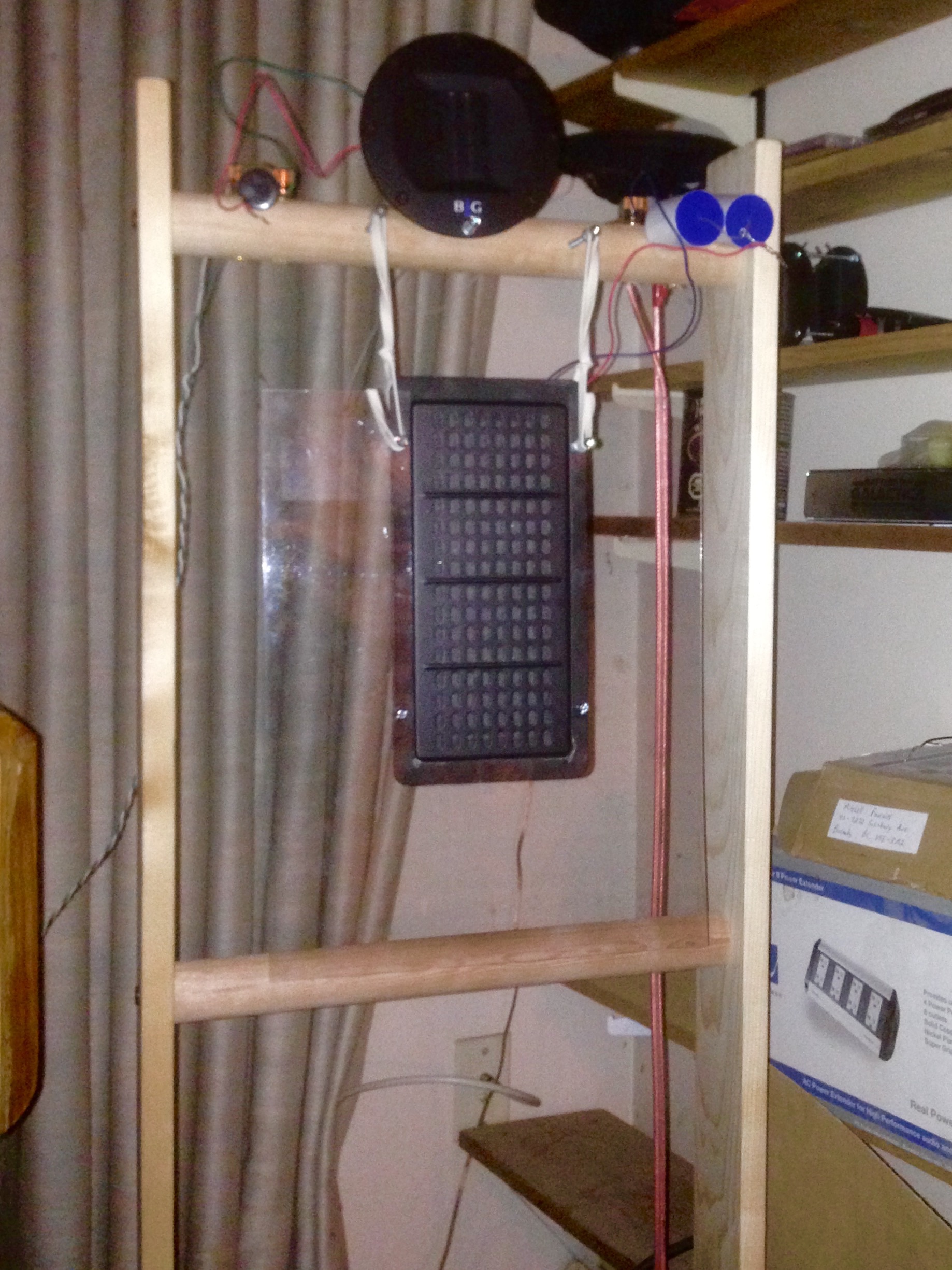

One thing I especially like about no baffle speakers, is one may prototype many efforts, simply by hanging new drivers in a frame.
These were a little thin, with no baffle. Eq'ing them actively robbed my meagre 7 watts worth of midrange dynamics.
Enter some presized 11x14 Lexan sheets, very affordable at my local Home Depot. They're a little hard to see, even with photoshopping, but it's here in the right channel.
I was also unable to get a really good blend with any sub, using active crossovering at 4th order.
Happened to have 4 47uF caps about, so added these to the Neo 10, no active highpass filtering.
Wanted the same electrical phase to the actively crossed tweeter, so added a 2uf cap to the speaker circuit, this corrects a little roll off on the Neo 3.
Bass was still a little lumpy, added a 12mH P-Core inductor, and this now features the improvements of tandem active and passive filtering.
So I get a little help from a baffle, and I don't need to see it.
