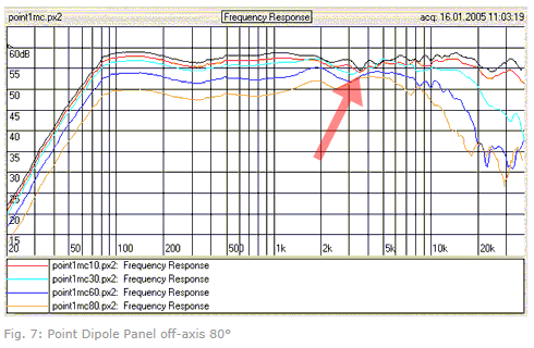

The Point dispersion is shown at their website, typical problem around 2-4kHz exist, top end has typical monopole directivity pattern. Sub100Hz is handled by sub of some kind.

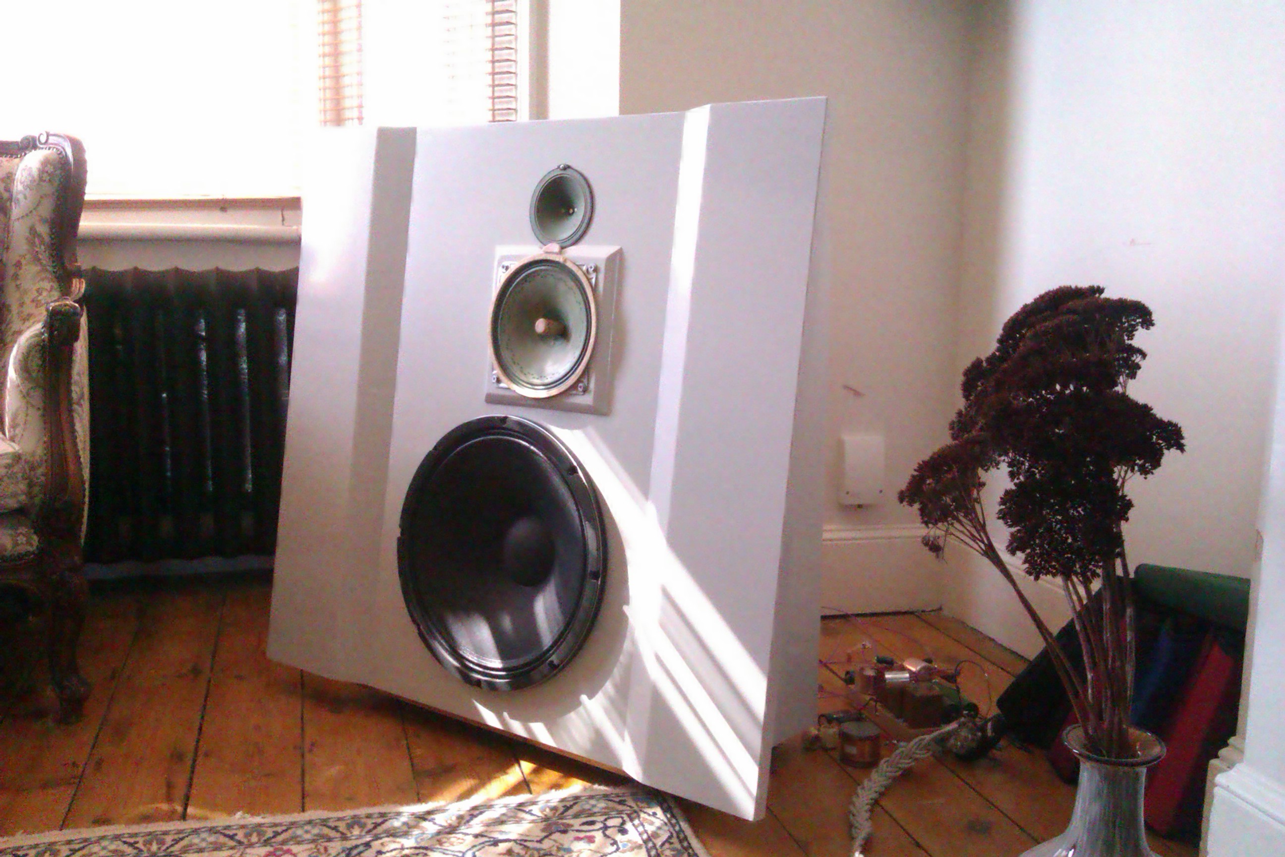

My simple contribution
  • Drivers are Fostex FX120 and Eminence Alpha 15
  • Active crossover using a minidsp 2×4
  • Asymetrical crossover at 300Hz 2nd order LR and 500 Hz 2nd order Bessel; 6db bass boost;
  • Drivers connected in phase
  • Baffle size is 510 x 950 mm; beech wood 26mm, braced on the back using 40×40 mm beams
  • Designed using MJK licensed calculation models
  • Bi-Amplification using my Bob Latino Dynaco ST70 tube amplifier for the extended range driver and my LM3886 chipamp for the bass.

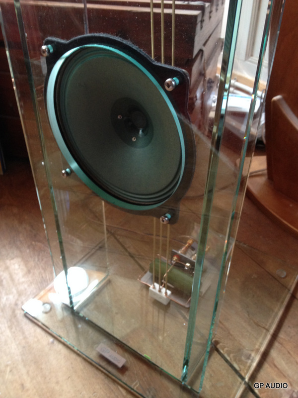

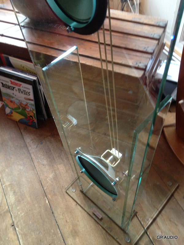

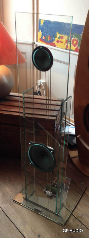

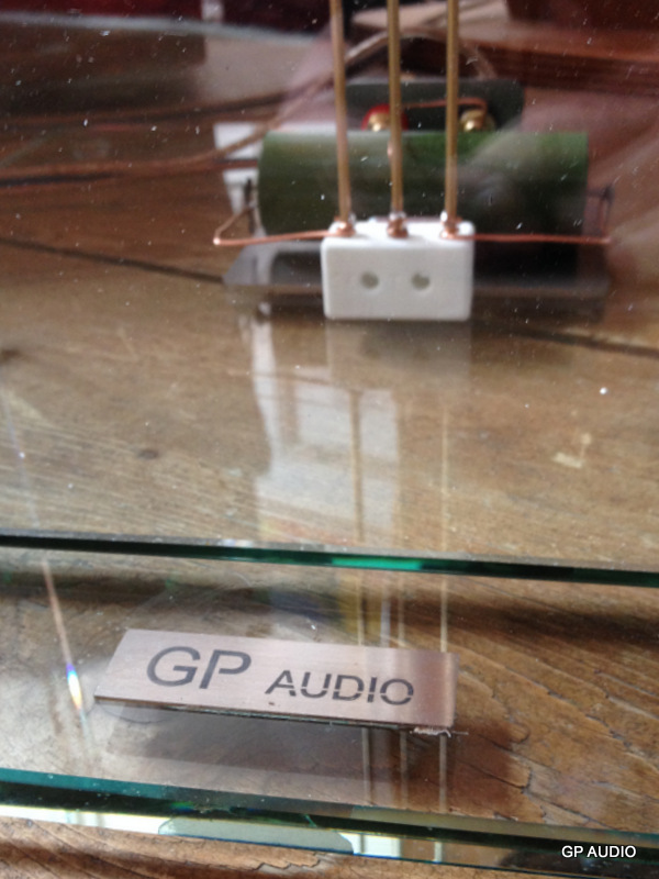

desk top OB's
made out of glass, 300 x 300 x 10mm. Rest is 3mm stainless steel. the wiring is solid silver. Sound surprisingly good and with a descent amount of bass, probably because they're on the floor. Driver is a Chinese full range of about 30$. Worth every penny.
