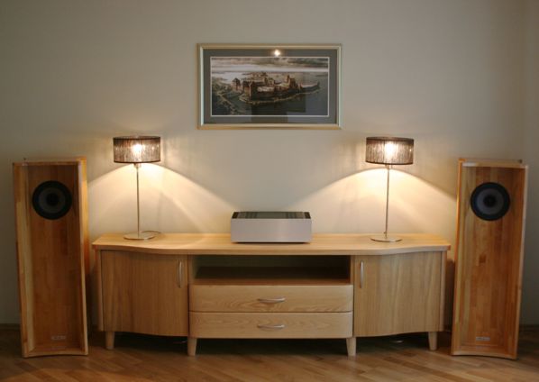

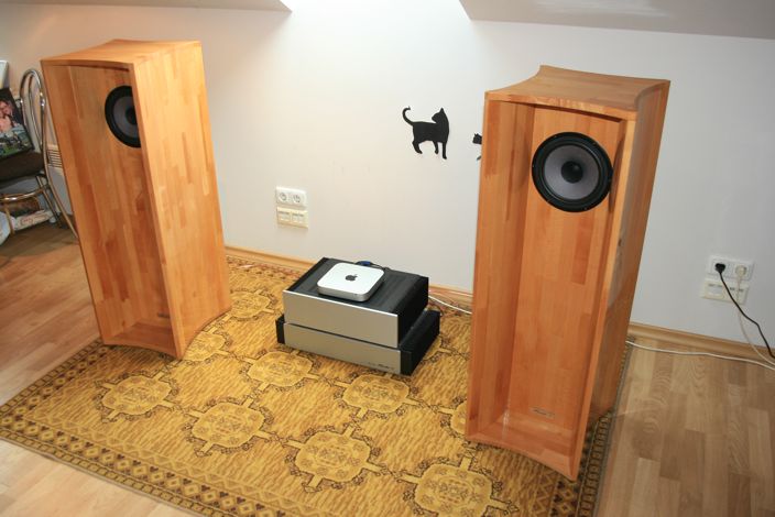

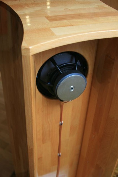

Here are mine latest open baffles. Driven by current drive amplifier.

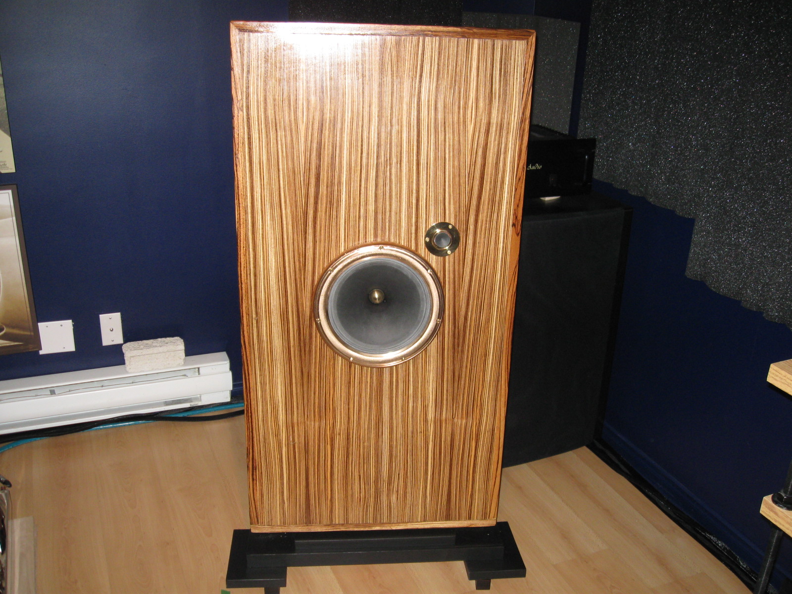

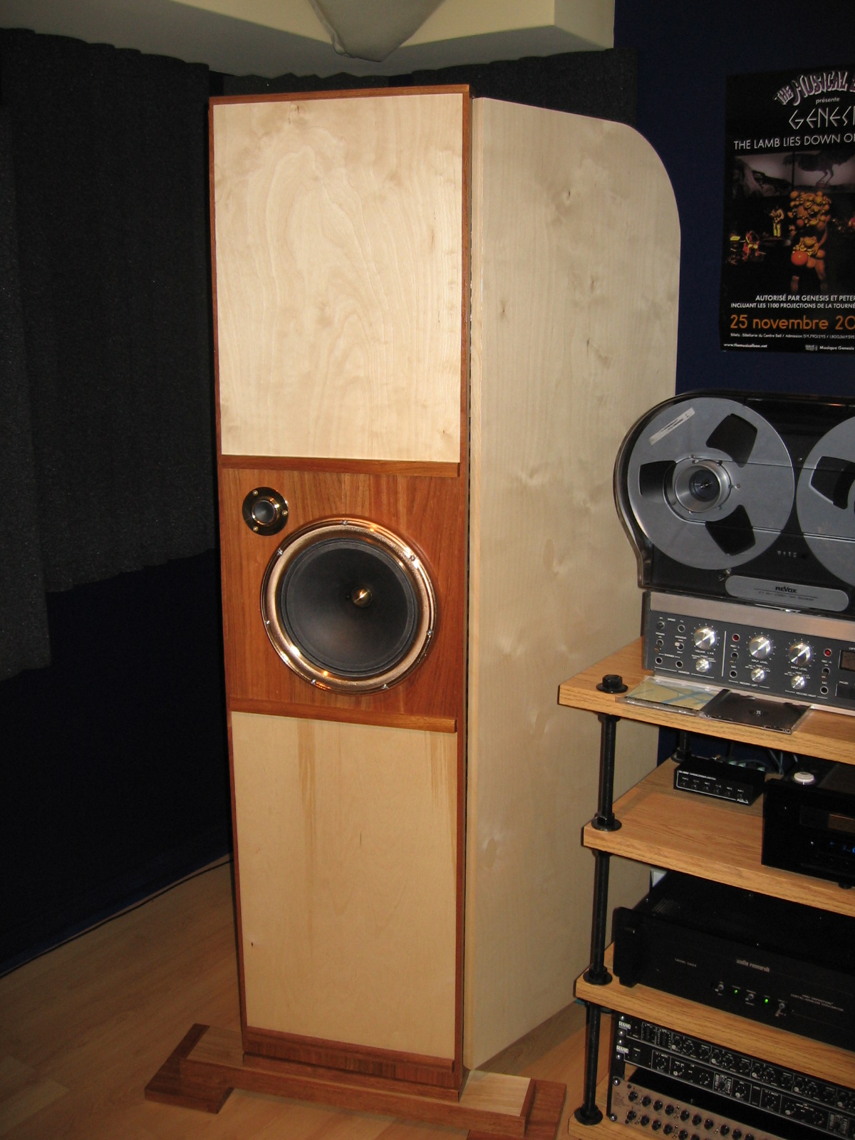

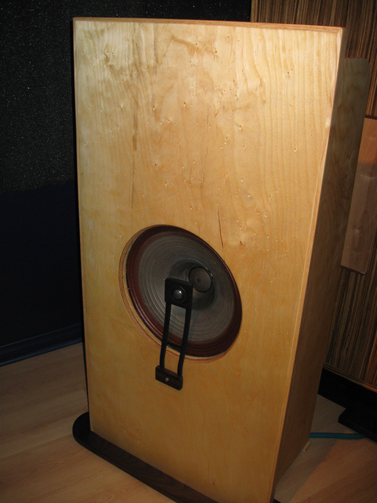

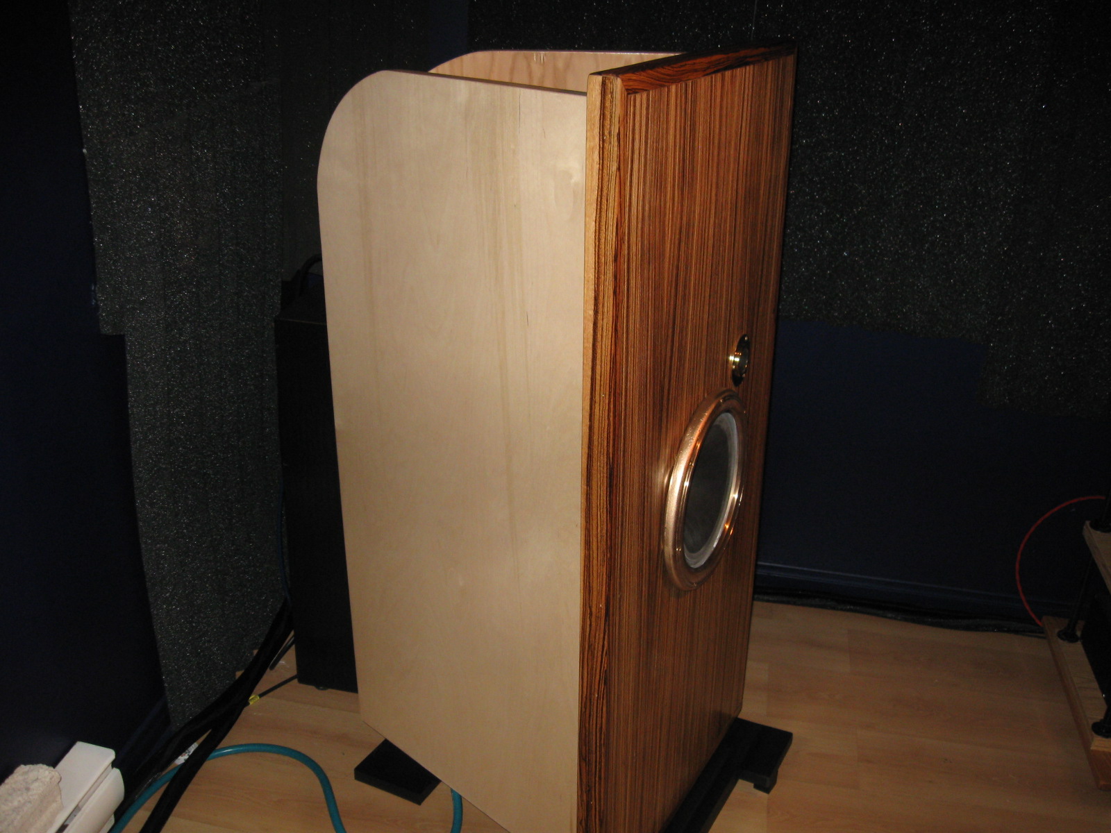

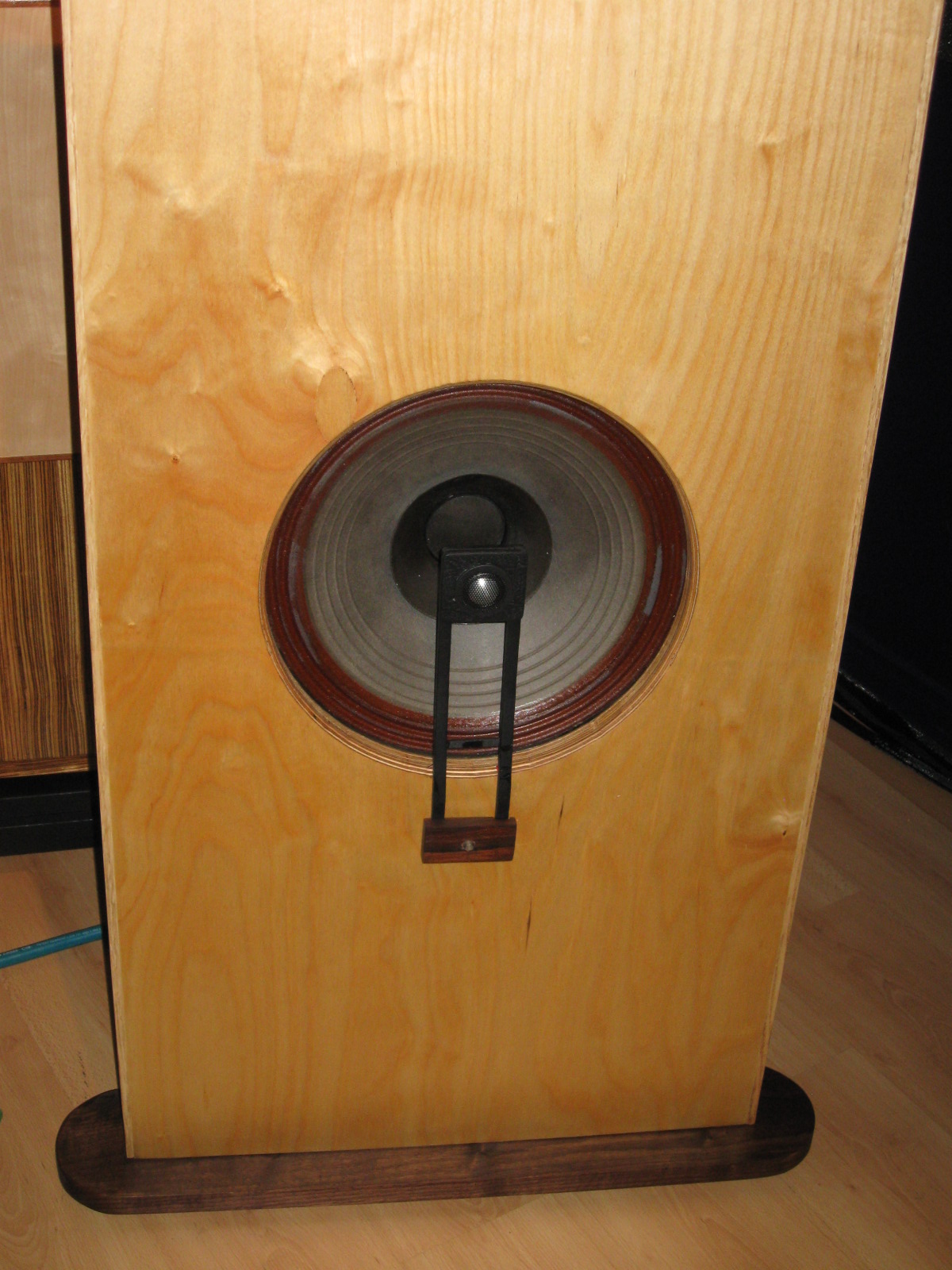

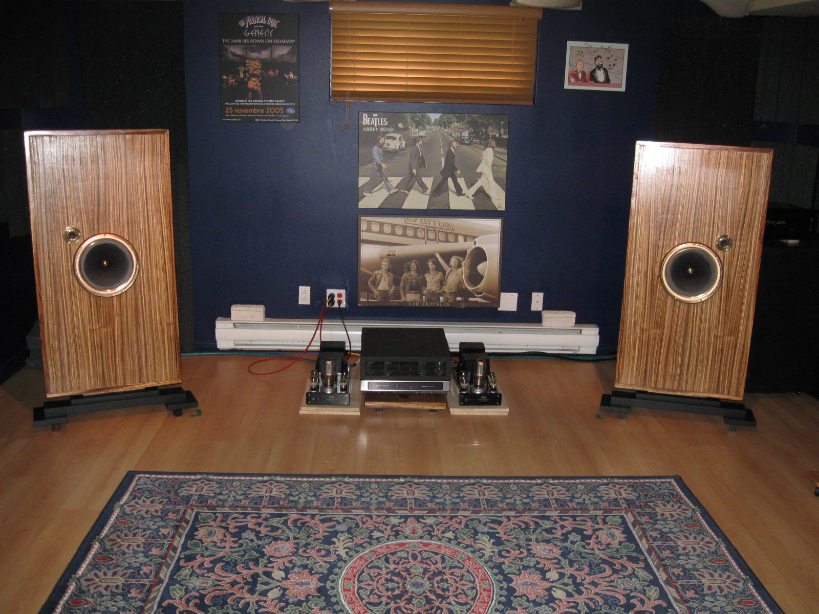

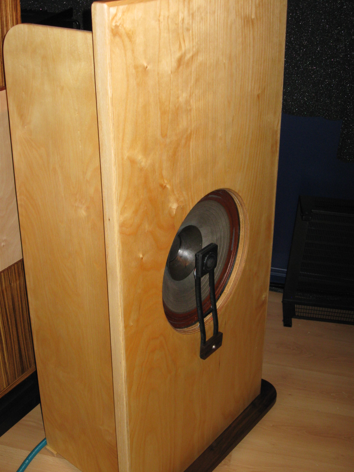

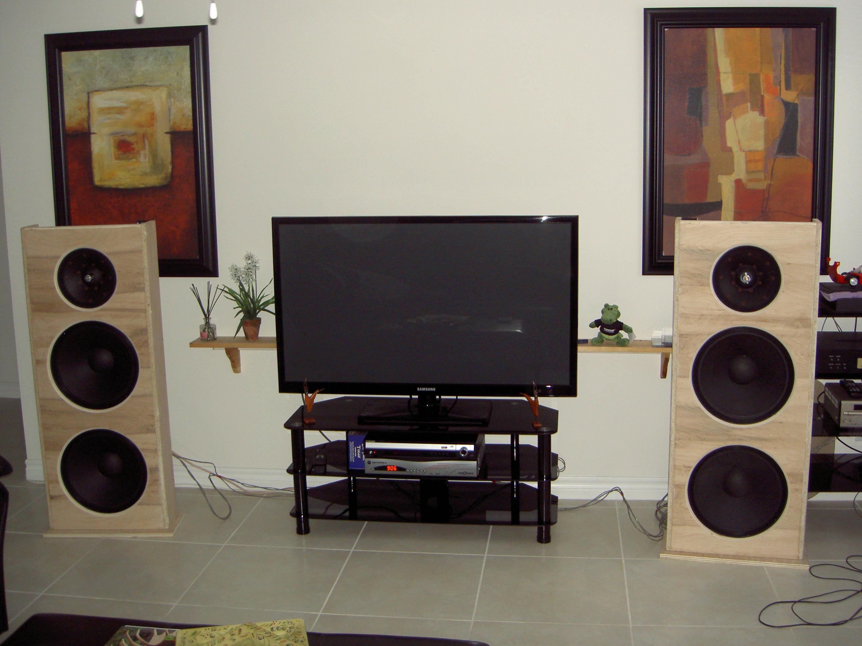

Here's some of my OB's projects, Electrovoice SP12B and SP15 and PHY-HP.
Enjoy!

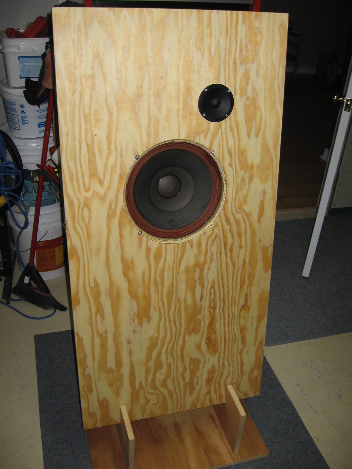

My OB w.i.p.
Here is my latest. Not finished obviously but sounding very very nice. The tweeter is currently on the rear (wanted to audition for a while before cutting holes) The phase plugs shown are only temp. Waiting on the return of more favourable weather to finish.
What drivers are you using Kendt?
I used a pair of spark plugs for phase plugs once in a test/comparison and they did almost as well as real phase plugs.
eminence 15a,s for bass
hivi planar tweeters
selenium 10pw3 on mids
the system uses two charlize 2 amps w/mini dsp.
The 10pw3,s sounded absolutely awefull at first and went back in their boxes several times but after a few tweeks and a ton of breakin they now sound surprisingly good. Patience paid off bigtime here.

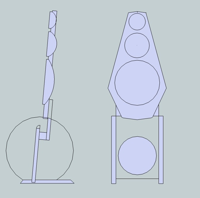

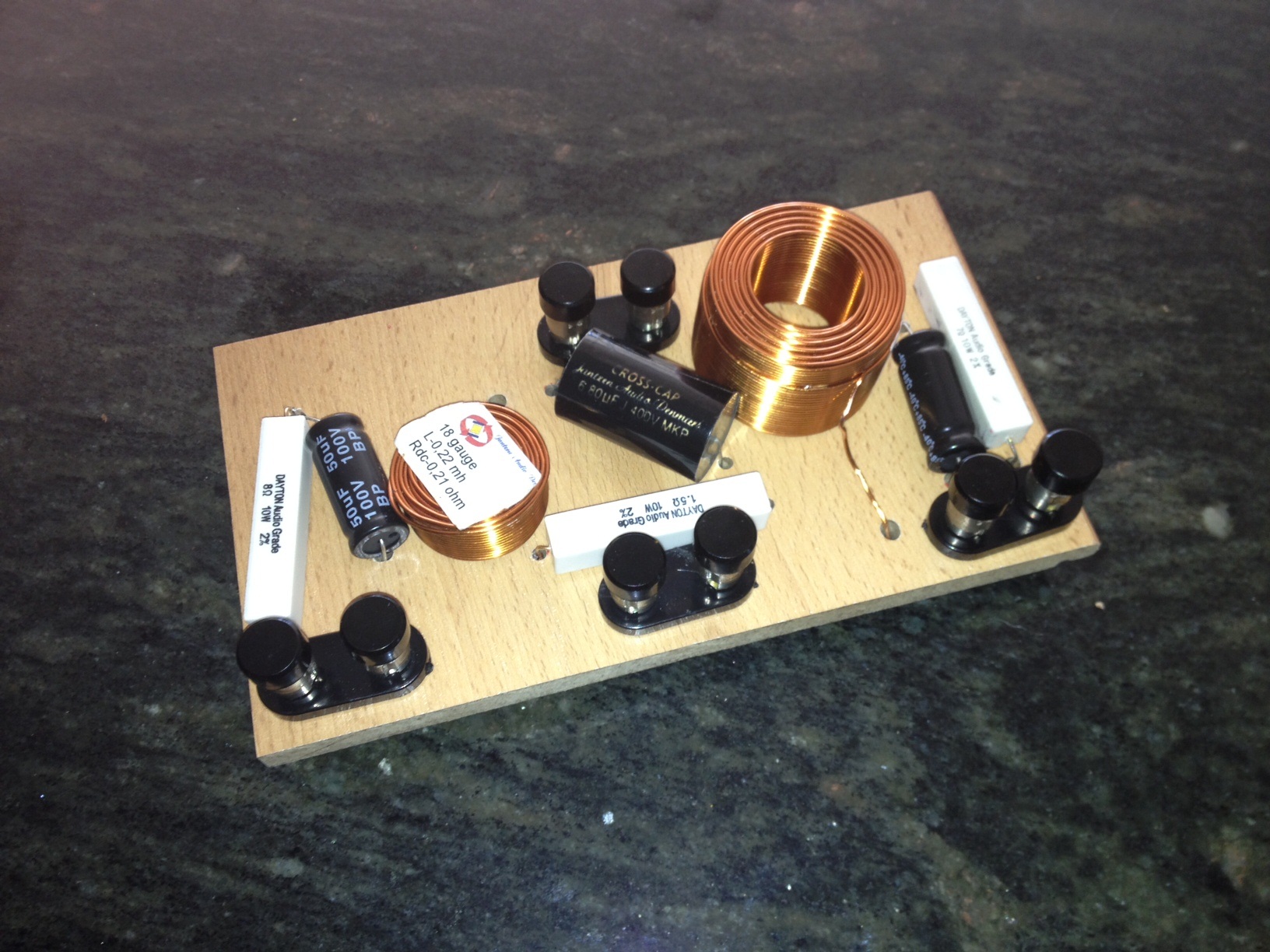

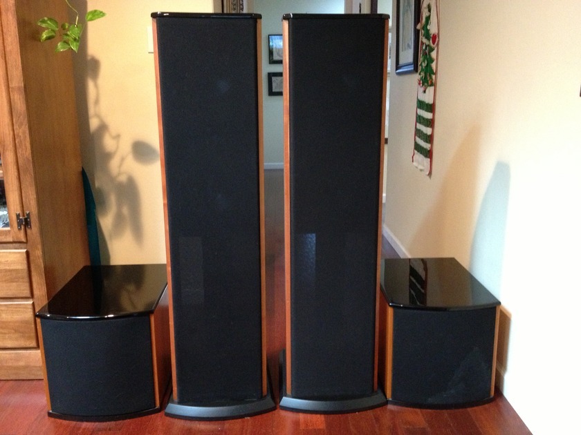

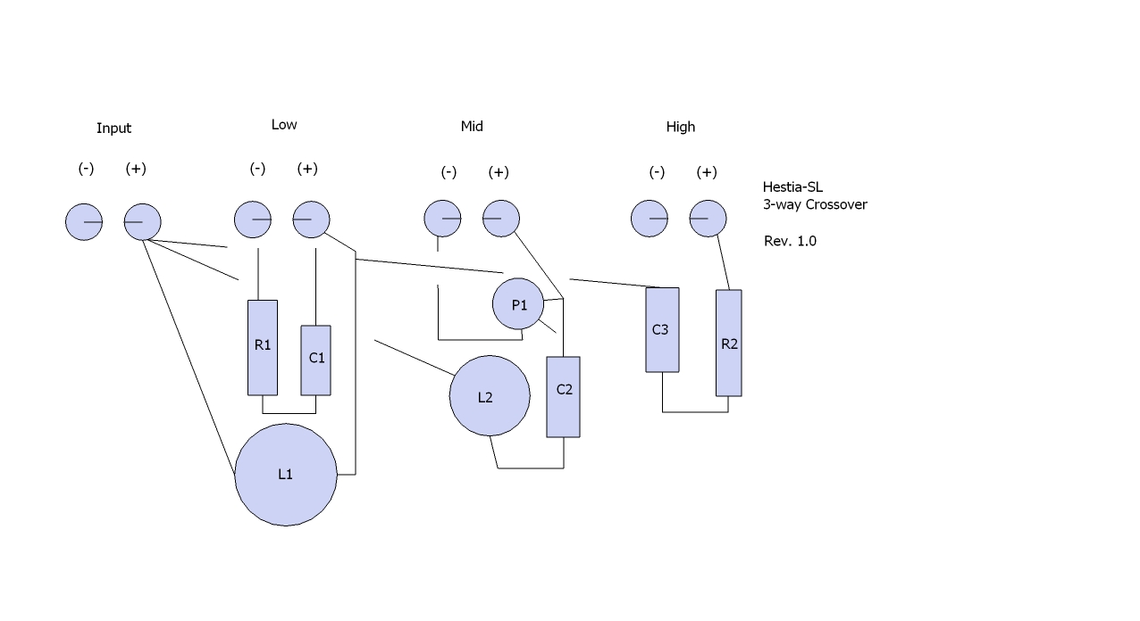

Hestia-SL 3.5 way
Hestia-SL: Big sister to the original Hestia low cost Design.
Bass Driver: Usher 8955 (alternate 8137a)
Lower Mid: Dayton Pro Sound PA255-8
Mid Coupler: Celestion Neo 5 Full Range (8 ohm)
Tweeter: Vifa XT19TD00-04
Avg Efficiency: 90.5 dB 1w/1m
7.8 ohms
Can be driven by SET's, T-Amp, etc.
LF driven by dual-mono plates (2 x Yung SD-200)
Full write-up: New Build: Hestia-SL
